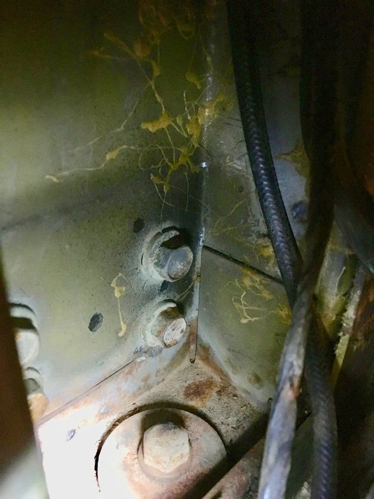

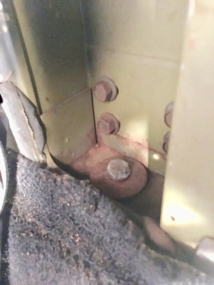

Not so much the moisture as it being trapped......for years. And once it starts it is impossible to stop if in an inaccessible area.
My 72 was garage kept its whole life.......the birdcage is a 9.8 out of 10 with just a hint of surface rust in the pocket behind the kick panels.......and the frame is beautiful for never being restored........
I am a lucky man as I bought the car here, on CF from a member in SC.
As a rule of thumb.......most times, BUT NOT ALL, one can gauge the overall condition of things like the headlight pop-up assemblies and vacuum can.....things that corrode easy and determine whether or not the rest is worth investigating. There are some pretty chrome bumper cars out there that are rotted out in their bones.......but the visual inspection of ancillary components is usually a tell.....
On a side note.......it appears my 72' was coated around the windshield frame with an epoxy black, semi gloss.........it looks great and there is no repairs in it but I do not remember my 69' 427/400 having a black finish on the windshield frame. Can anyone verify what was correct? My windshield is not original so a smart man could have painted this while everything was off. Anyhoo.....if GM didn't do this they should have.....
Jebby
Jebby
My windshield frame is also a semi-gloss black color. Windshield is original.
My car was also garaged it's whole life, and I too have some surface rust down in the frame pockets. Still very luck given the 47+ years the car has been around.
Cool...good to know.....and those pics could be of my own car
Jebby
