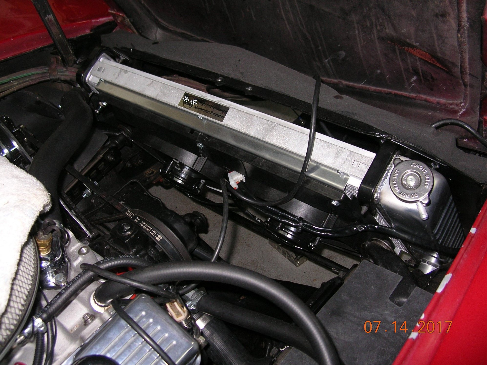

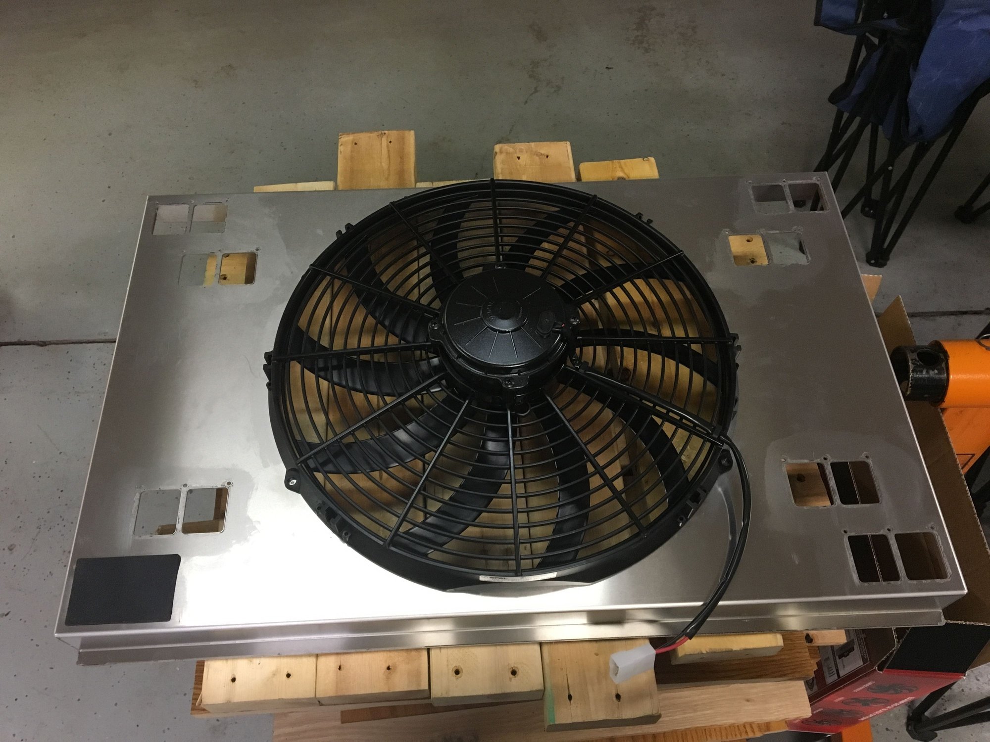

I got this set up from Champion radiator, I went with one large fan so it would draw air thru the upper and lower tubes as well as the center. Also I have more clearance in the upper control arm area for access.

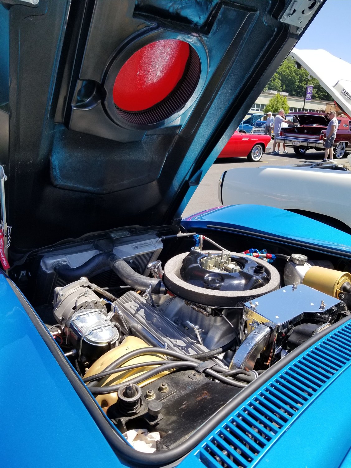

Hey John. Happy New Year.

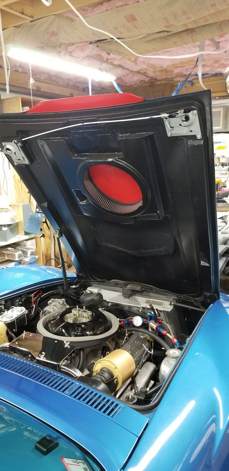

I have a single 16" dewitts fan that does great for the 327. It kept it right at 210 sitting in Hampton Beach traffic for an hour.
I suggest the dual fans for more cfm if you put that 502 in there.
I looked up the fan I wanted on Dewitts site and bought t from Summit for the free shipping. PS I have the entire front suspension out already. I also got the compressor wired in like you figured out
lousy pics but you can zoon in and see the fan a little.

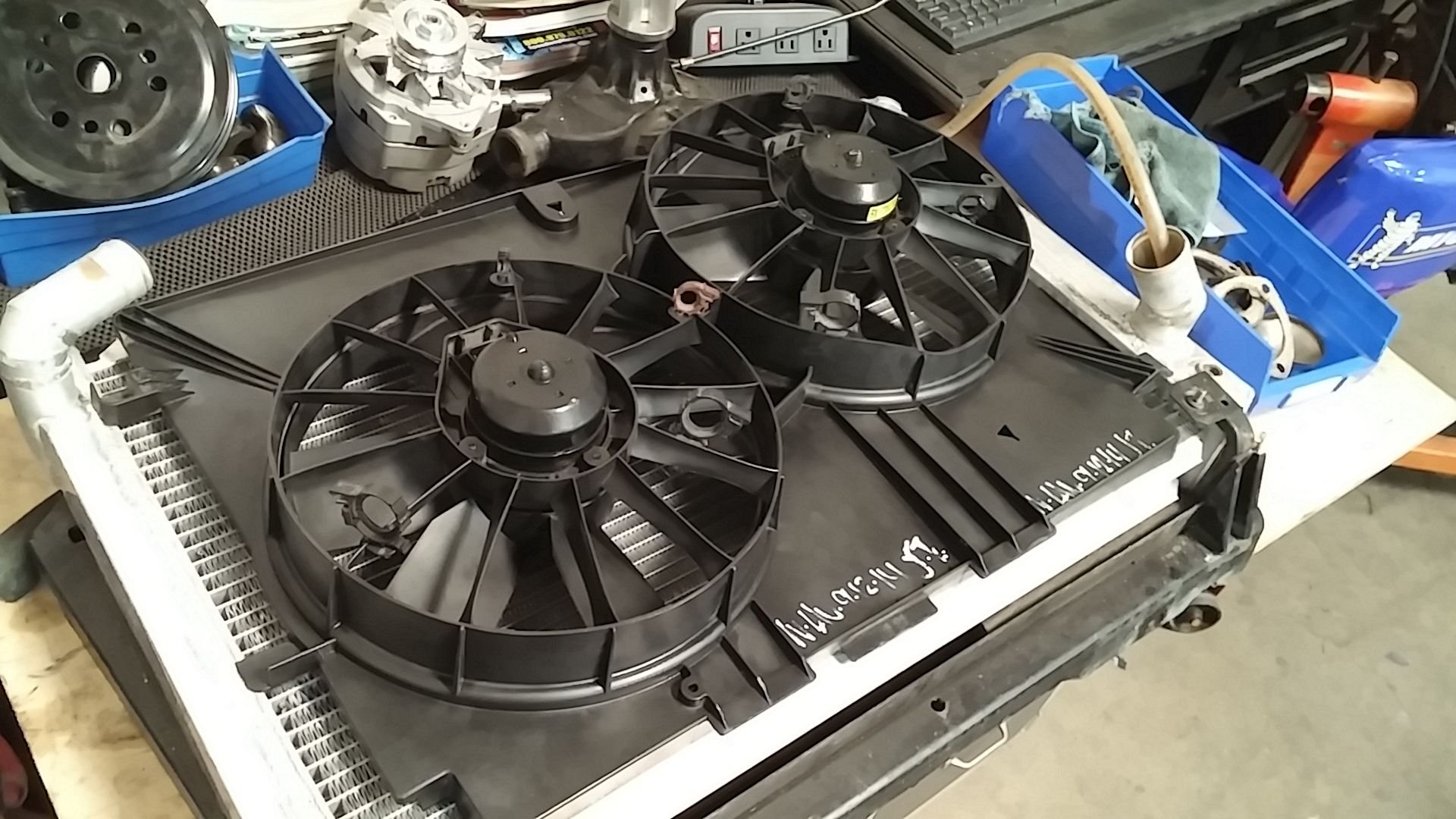

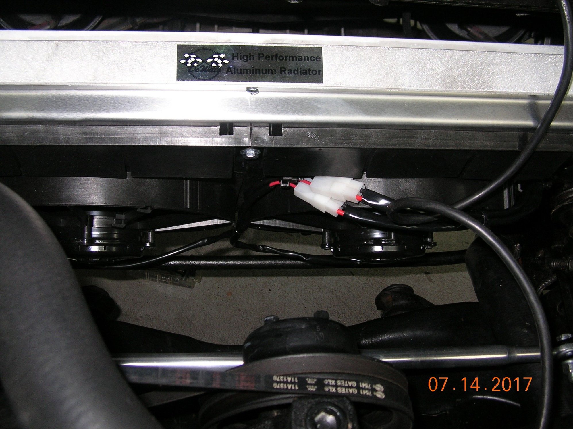

These Twin Spals came with the Dewitt Radiator as a kit.I've been very pleased with the cooling cycles and haven't had any issue, except in the initial start up of the engine, while running the AC I noticed that the high side pressure would shoot up almost immediately which the the only and easiest solution for me was to add a Trinary switch to the AC system to engage one fan when switching on AC system regardless of engine temp.Other than that they are "Cool" and very dependable so far!!...Good Luck and Happy New Year!!

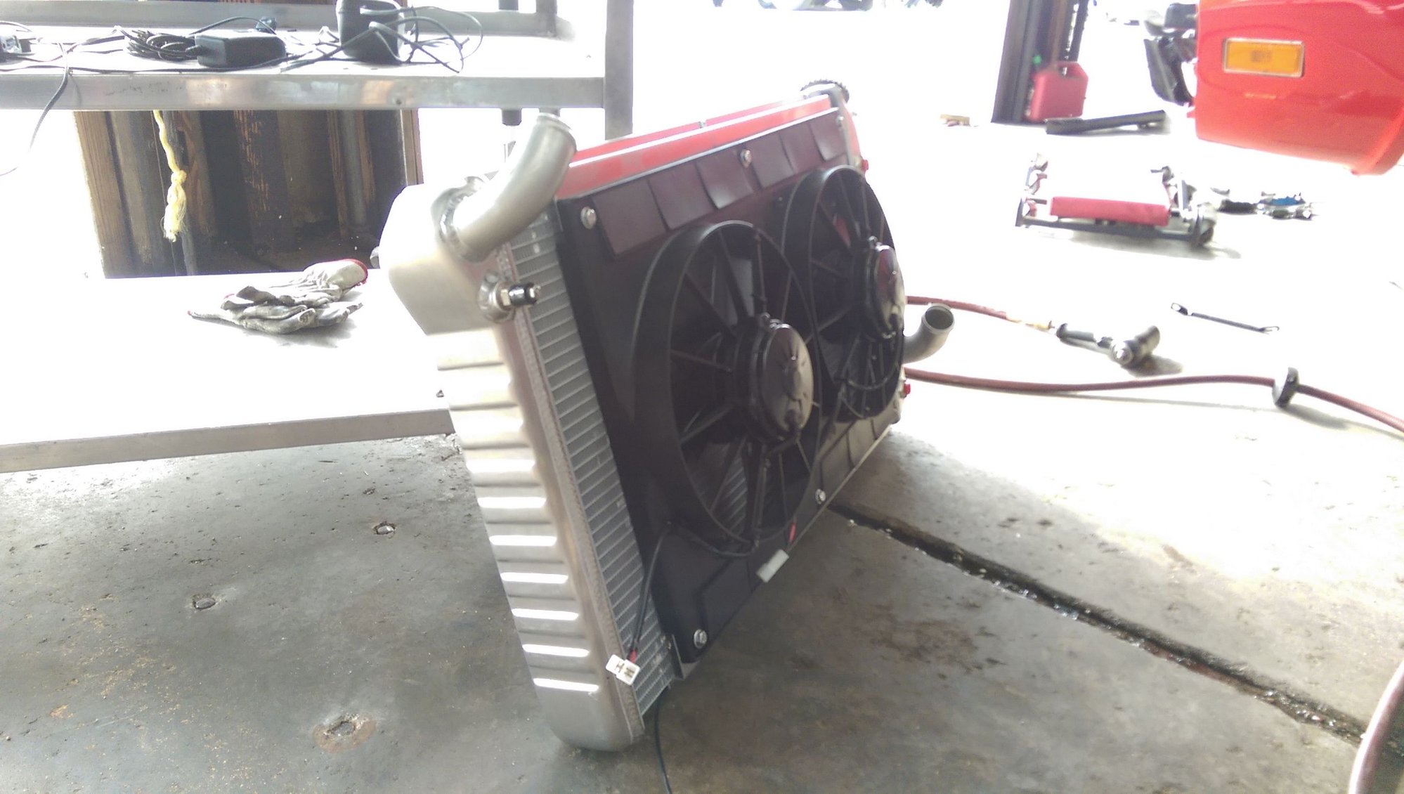

Dual Electric Fans, with shroud - $40. 1990's Camaro at local Pick Your Part (was the closest fit to stock new aluminum radiator ($140). Ohm'd the windings (good), spun them (spun freely) mounted them with two relays ($10). Four years later,still keeping it plenty cool, even here in the High Desert. While you're at it, put a serpentine belt setup from a late 80's, early 90's Chevy Caprice. Nearly a direct bolt on, to any 1st Gen Chevy SBC.

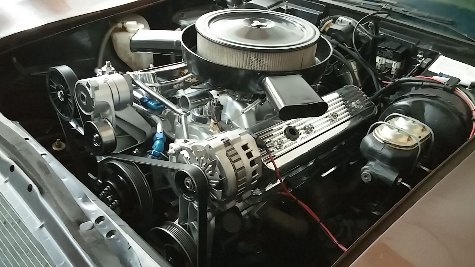

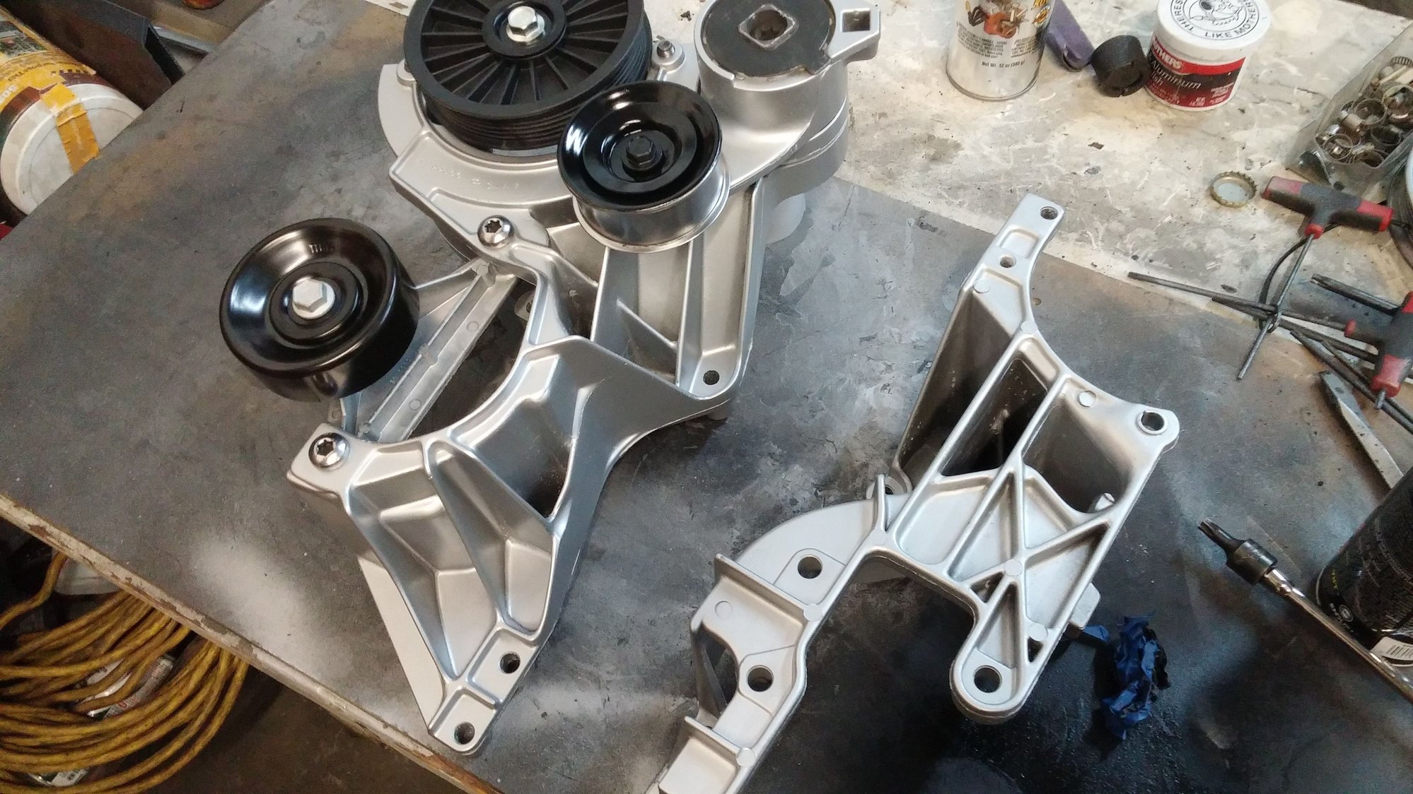

OEM GM late 80's early 90's, Chevy Caprice Serpentine Belt Drive. The whole thing, including HD alternator and P/S pump - $300. Added idler wheel where AC compressor used to be and you must use a reverse flow water pump (common on any late 80's, early 90's TBI, TPI engines that had serp belt drive). Caveat? Had to pull it myself, clean it up, paint it and put it on. All the fasteners are Torx bolts. Bring toothbrush and brake cleaner spray and dig the dirt out before you take the Torx bits out. They strip really easy, when they're caked with dirt, trust me.

Compare to $1000 and up aftermarket serpentine belt set up. Not as pretty, but very easy to work with, auto tensioning and really well designed aluminum castings, with deep webs. GM did really good on this.

Very nice setup.
I think you meant "reverse rotation" for the water pump. I only point it out for folks referencing this post.
