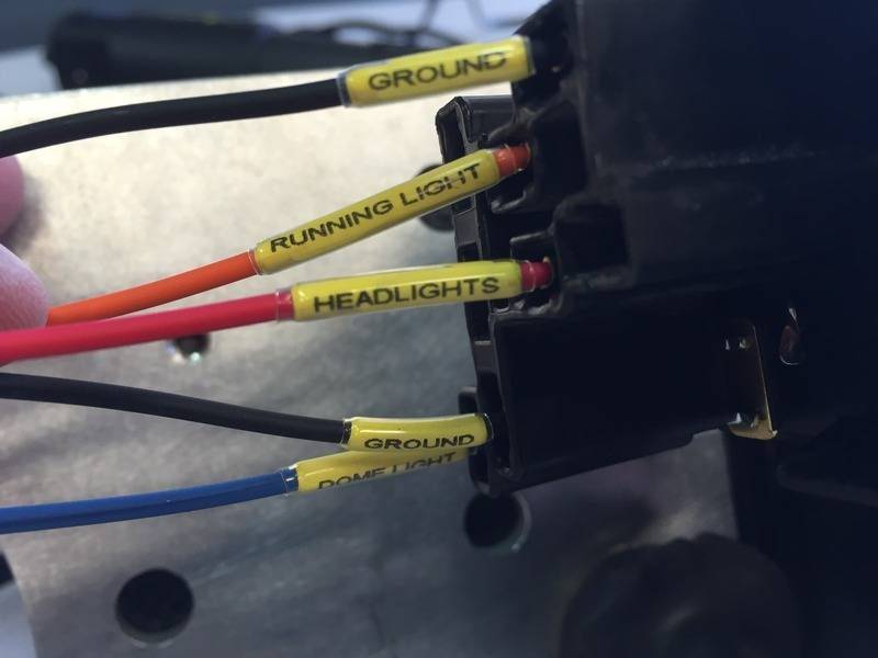

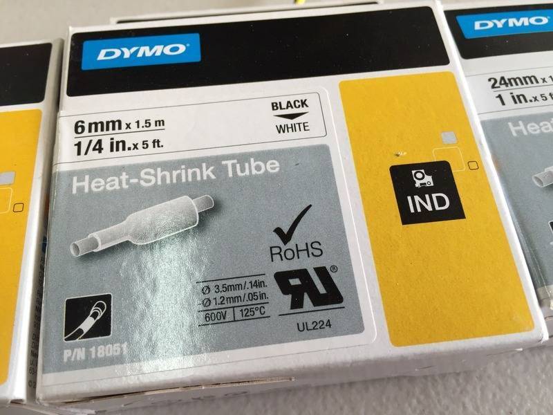

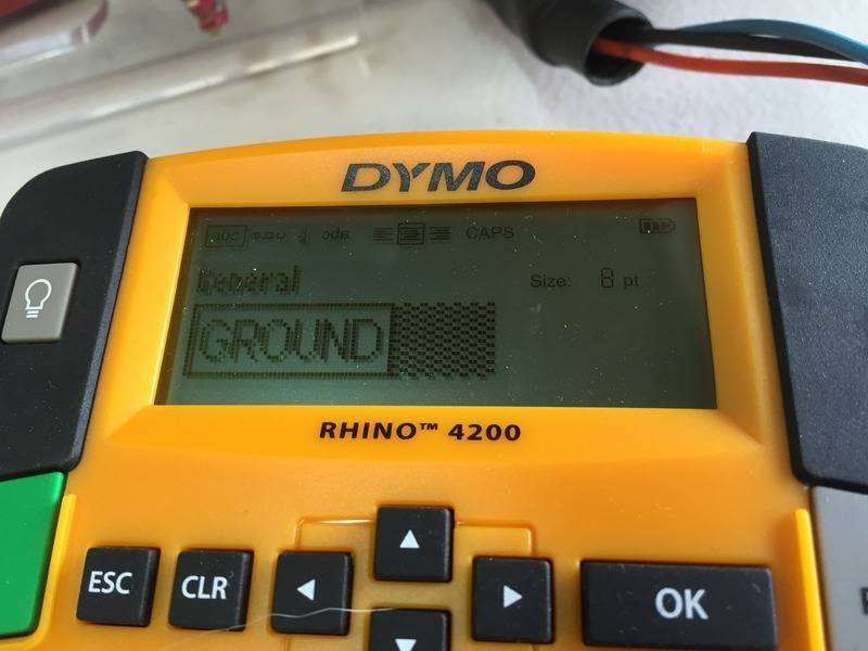

Hey Eddie-
Here's something that will be invaluable if you ever have to service & troubleshoot in the future with a "custom" harness-
A Dymo labeler- it does heatshrink tubing- about $60 for the labeler and another $20 for the heatshrink
