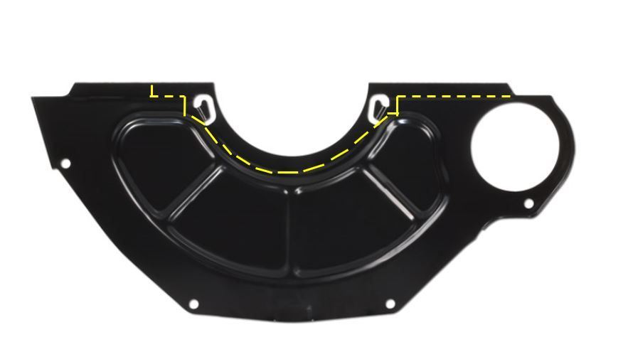

Default Flywheel Inspection Cover Mod
Not sure about the automatic cover, but if you have the manual trans, Muncie or T10, you're going to have to modify the flywheel inspection cover to fit on the '87-'91 Chevy Small Blocks with the one piece rear main seal. The one piece rear crank, has a lot larger oil pan diameter on the rear of the block and the regular inspection cover won't fit at all. So you're going to have to cut it to make it fit. Maybe you could find one, but I doubt it, as the four speed bellhousing was long gone by '87. I eyeballed this and then took an air saw to it, along the dashed lines. On the circular part, keep the cut to the outside of the raised portion. Fit perfectly after that. Measurements are approximate and your results may vary, so check and double check before you cut.
