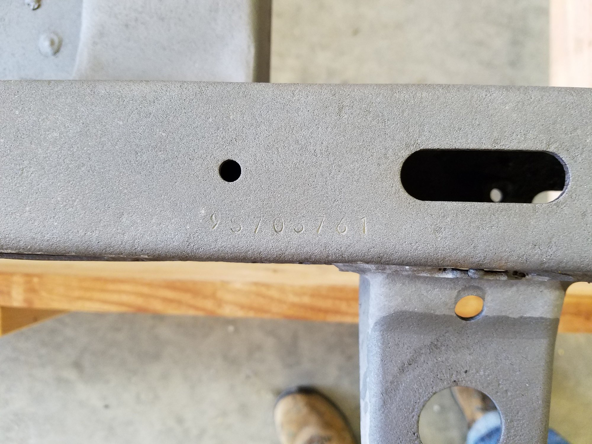

This is my friend's 71 when he did a body off. Right under the bolt, driver's side.
My frame looks the same after being painted. Wonder if I used sandpaper or lacquer thinner to remove the paint to see the numbers.

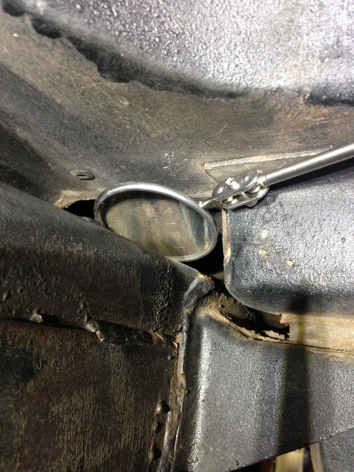

If you take a bunch of pictures and then look at them blown up on your computer, you might be surprised. I when I did this on my ‘58, I couldn’t make the numbers out in the mirror. On my computer screen, they were clear.
