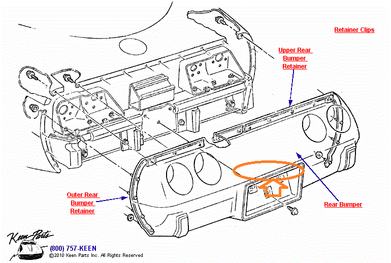

A photo of what you have would be helpful.
Where I circled it in orange and the arrow pointing is where you want to take the photo angle at. You want the underside of the top opening for your license plate.

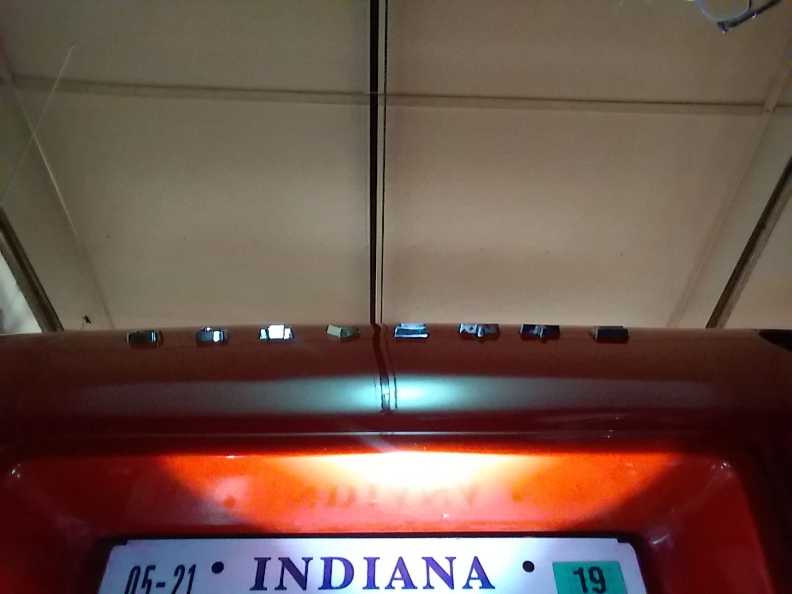

I took a picture. now Im trying to post it.

Old Jan 8, 2019 | 09:12 AM

Wow, so you do have the slant back. And I find it amazing that there aren't any holes for the license plate lights. Mine, actually has the holes! And the steel beam is blocking it, but looking at yours, the upper surface is far deeper in depth, than mine. If you measure the width of the beam, versus the depth of the upper surface, is there any room, in front of the beam (or towards the front of the car) for you to mount your license plate lights?

This is obviously an aftermarket fiberglass bumper cover that no one used the template provided and cut out the hole for the license plate light.
There is only ONE license plate light for a1975. A 1974 has TWO license plates lights and they are mounted on the sides and not the top.
The the license plate light housing gets installed through the hole for the license plate light itself that has been cut out. It CANNOT be accessed from the top due to the impact bar.
I have seen that on some aftermarket fiberglass rear bumpers ...the top surface for the license plate light is different than that of a factory bumper. So the width of it was changed....so when laying up the template...considering this change in width can be a factor. I always use the outside edge as my control surface so I know that the light is set back far enough.

Its hard to see in the pic I posted but it looks like the mounting holes were filled and painted over. the steel beam is touching the fiberglass so no way to get to the top to install the housing or change a bulb,,,that I can figure, without removing the bumper. DUB says its aftermarket so Im guessing a factory bumper would have enough room to access for install and bulb replacement.. Your LED fasteners are looking better all the time.

Sorry....but....the photo and drawing in POST # 16 is not correct and a bit misleading.
The license plate light housing is not where the drawing shows it to be. It is tucked up under the impact bar where you cannot get to from the back of the bumper.....which is WHY the hole cut for it is made so you can install it through the hole you cut out.
In order for this drawing to be correct. The outline for the license plate light would not be a solid line but broken up to show it is under the impact bar ledge.
NO NEED to take your bumper off to do this. Or at least I know if you wanted me to cut out the hole for the license plate light and install it...I would NOT remove the bumper to do so...and that also means running the wire THROUGH the impact bar if needed.
