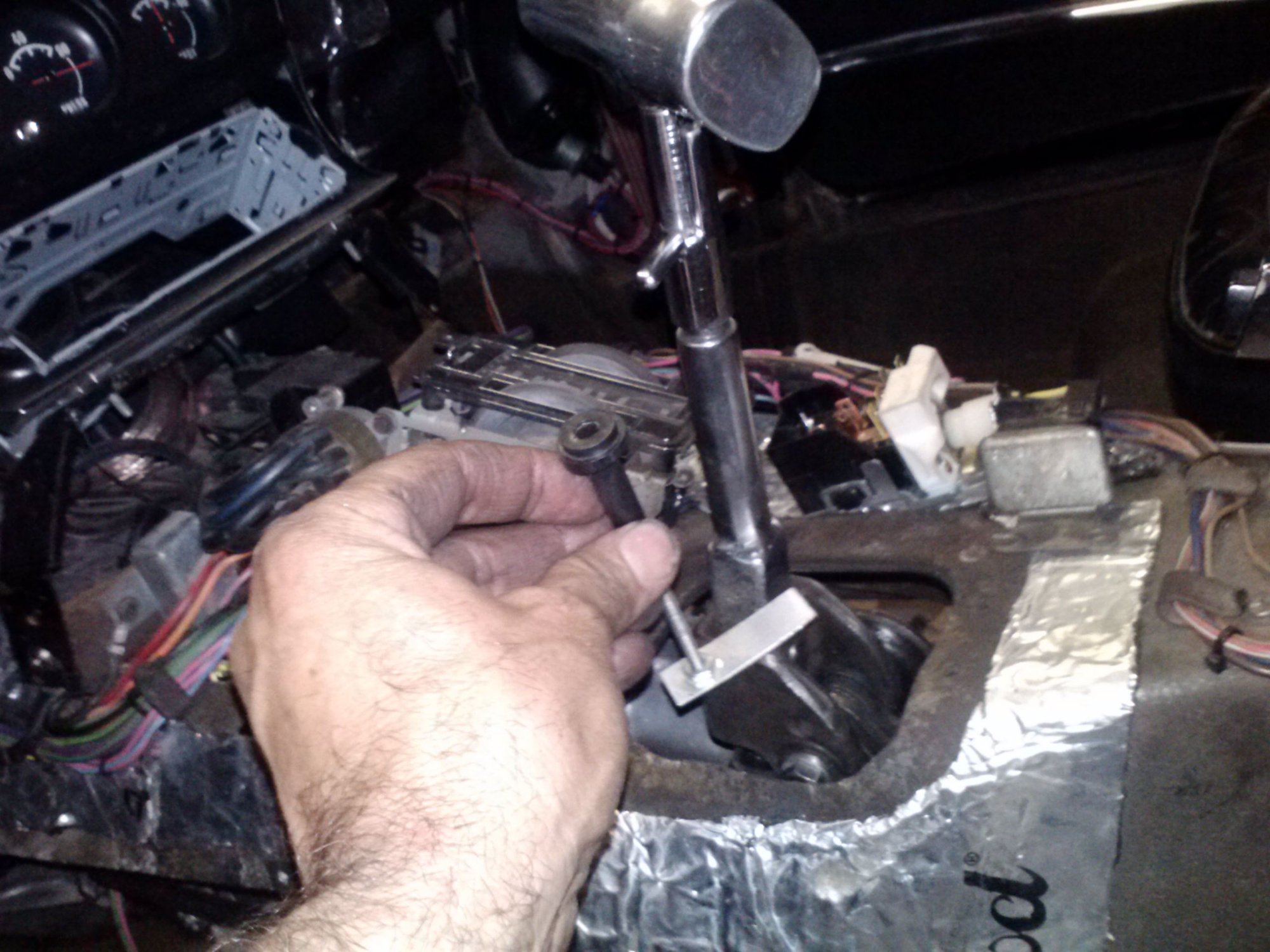

Here's the tool I designed, but in retrospect, I would've made it a lot longer out of a single piece and bend that into the abbreviated "L". But I already cut it out to 0.644 and I wasn't going to do it again!

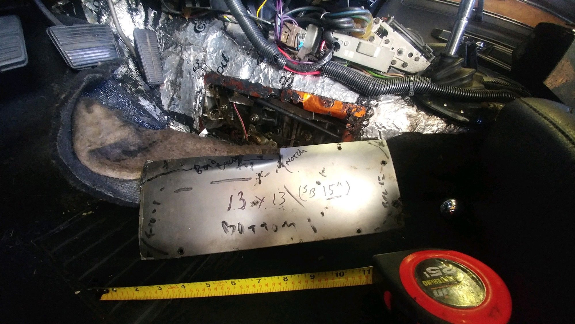

Just sharing a mod, that I did (not that my patina'd '74 is worth that much, so why not?). If you're Bloomington Gold, or have a car, that a judge will look underneath it, but I doubt anyone will even know it's there, even them. But it sure makes life, very easy when adjusting the shift rods on these cars. Should've come from the factory that way, IMHO. Easy to get to, just by pulling down the carpet by the gas pedal.
I cut out a 12" x 4" hole in the fiberglass transmission trouble starting 3" back from the accelerator pedal. I then cut a 13" x 5" aluminum panel from sheet metal. Next, I shaped it over a sand bag. I had to notch it at the top, to match the contour and then bend that area back (see picture). Next put 5-6 clip nuts over the fiberglass around the edge of the hole. Then center the panel over it, tape it tightly and then go underneath the car and using a scribe, push the scribe through each nut hole on the bottom of each clip and scratch well, the underside of the custom panel. Remove the panel, make a punch mark in the center of each scribed hole and drill out, so that screws can go through and hold the panel in place. Attach and push carpet back up.
In retrospect, I would've made the hole 3" longer to the rear or parallel to where the shifter hole starts. PS: 13x13 should read 13x5 (doh!).
