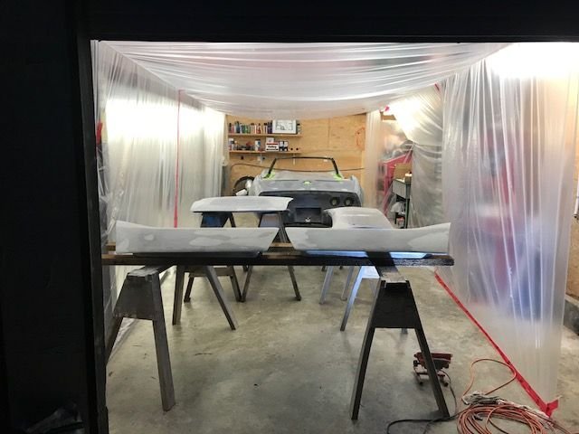

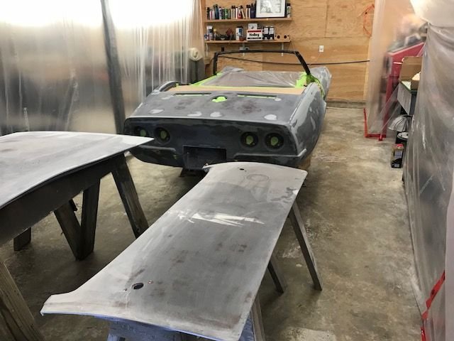

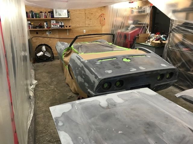

ok, got all the bodywork done , masked the car off and I'm going to spray this baby with gelcoat tomorrow morning, I've constructed a spray booth , as per dubs instructions, and I think I'm ready to go. I'll post pictures when I'm done , if I can figure out how

I took dubs advise and bolted all the bumpers on, to make sure they fit, glad I did, had to make a few alterations, and they fit like a dream. Luckily I had just got all the chrome and trim back from the platers .

Exactly my thought on the gelcoat vs primer - but great prep work. But I am adding a cautionary note about the setup and maybe the booth, I seem to remember paint not sticking to whatever it was I had shielded my open body areas in. Pretty sure it was two mil mylar but not positive. You do not want this to come unstuck while you are spraying, and I can't tell what the cockpit area is. Paper is the good stuff.
Gee I keep editing this ... you cannot ever have enough light and from every angle too. Do an imaginary walk around with a spray gun. Apologies if you already know all this.
If you will be spraying a metallic, you want the doors vertical.

Wow, just finished, turned out great, spraying two gallons of gelcoat on a car is time consuming. The product I used is a generic brand available at a local plastic supply place we have here in Victoria BC , they are the only ones that carry any gelcoat here. I bought two gallons of the neutral coloured stuff , and 250 ml of black tint, I split that between the two gallons and it turned it jet black. I used a gravity feed gun I had with. 3.0 tip on it, it is set up with the disposable pot system , which you really need for this process. I experimented a bit, and ended up reducing the gelcoat a little more than 10 percent with styrene and adding 16 ml of MPK per 800 ml paint pot, it's not very warm here so that's the max they recommend ( 8 degrees Celsius, 47 Fahrenheit) I was going to add wax to the last coat, on the advise of the people at the supply store , but after talking to DUB this morning I opted to top coat the gelcoat with PVA, and it seems to have worked great, I sprayed about two quarts on, as per DUBs advise.
as to the question , " why use gelcoat" I was going to skip this step but after talking with guys like DUB and a few other painters , I decided to use gelcoat to seal everything up , before going to polyester primer, a lot of work but I have lots of time and I'm going to keep this car, and I want to do the best job possible.
thanks for the tip on the plastic, you are probably right not a good idea, I won't use that again, as I've mentioned in my other posts I am just a novice , and this forum is such a great source of knowledge, the booth I set up in the garage is just to get the gelcoat and primer done, I have a decent cross draft booth at my sign business and will be spraying the car down there. I have a highly skilled automotive painter that works for me that I could get to do the final spray on the car, but there is no way I'm putting in all this prep work and have someone ( everyone) ask " who painted the car" and have to say that he did, I'm painting it myself!

hey peter, I took DUBs idea and just strung two cables down the length of the garage using screw eyes and turnbuckles, then looped poly over the whole thing and used tuck tape on the floor and seems. Worked great, although I have to say there is almost no overspray with the gelcoat , it basically comes out of the gun and lands on the car. I prepped the car to 80 grit, and then gave it a quick blocking with 180 ( probably not necessary)
