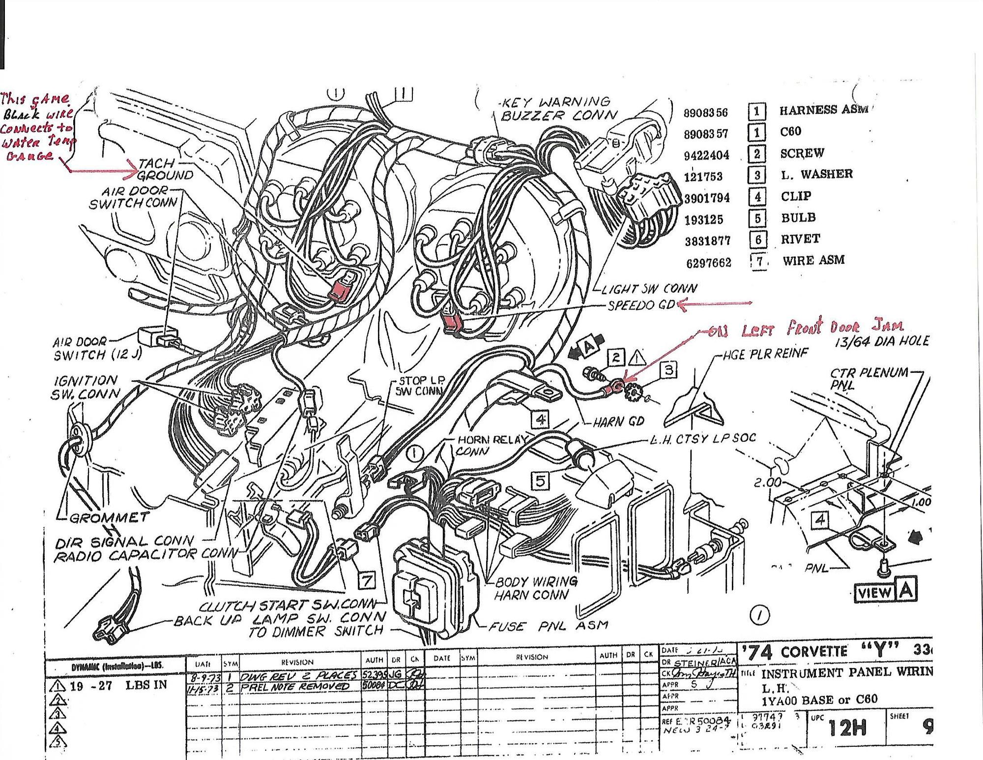

ok what started thi problem im putting this 72 vet back together got to where i could start it ran good i have my own wire running to distributer . the temp and fuel guage did not work and i have two grounds and a wire going toback of gauge .one to the sending unit o did not think that was write so went to fuse box with tester light from positive of batter i touch the fuse and the light lights up . are the fuse grounded and it fuse the ground not the hot

Is the wire connected from the door jam to the gauges?
The center terminal on the temperature gauge grounds the center console, it that wire connected?
You have a mechanical oil gauge so ignore these two wires.

the lights work so the fuse boxe works but i got neg going to the gauge and not pos
