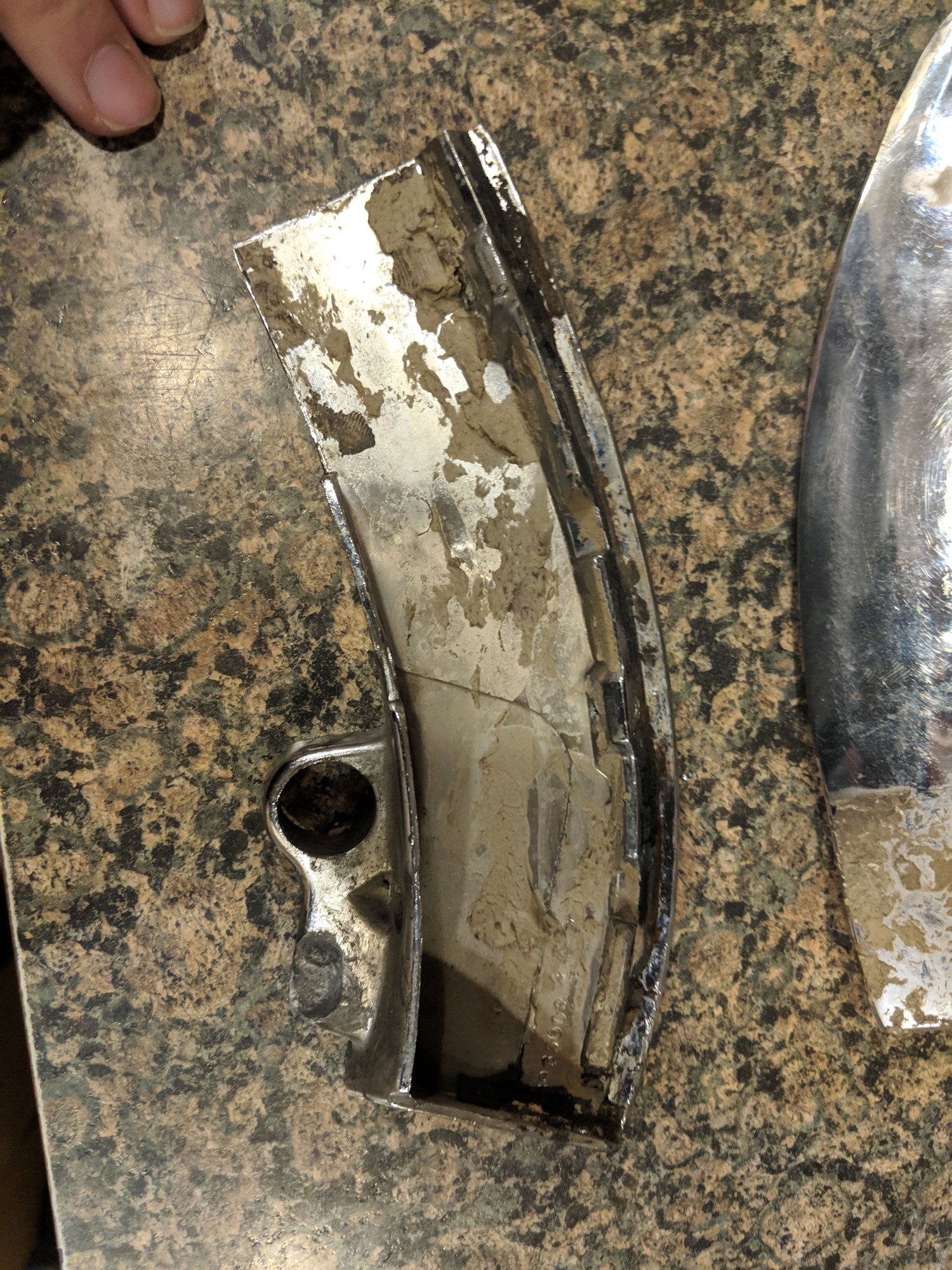

I pulled these off my Aprilish 68. They're correct right? They don't have the notch on the inner part lake later parts. And it's not the two piece like the earlies.
What gives me pause is the "relief" that looks worked in on the bottom side near the latch hole. Has anyone seen that before or is it some weird hackery. The windshield has been replaced so who knows what's what.
Thoughts?

WEAR. The adjustable stop bolts in the latch handles have worn these dimples ..DUE TO the plastic bushing that goes in the holes are not there....so the top can move and wear this area. Chances the latch adjustment bolts were swapped out for someones bad idea of fixing it ( or lack of fixing it).... instead of buying the correct bolts with the rubber caps on them.
Put a new set on and move on...unless you plan on using these.

Good feedback dub! Thanks! Should I just grab the repops with the notch? Or try to find good used originals that look like this?

the 68s latch locks are a bullet type head not flat with a rubber insert, so that's what happens on 68s at those 2 left and right side locations, nothing to do with the plastic bushing missing

DUB is correct and with the guide hole bushings missing you can see how the stop bolts, minus the protective caps, moved in and out and wore down the corner moldings. With the top moving in and out like that I bet the window seal on your side glass t-top weatherstripping leaks lots of air/noise on the highway.

no, that's very common on 68s due to how the latch bolt is shaped, I had 68s with the bushing intact also have this

Granted...but NOT having the bushings seems to be some what foolish due to the guide pin really has nothing at all to aid in staying in somewhat of a correct location.....which was all I was trying to get across.
YES...I was aware that the 1968-1969 (E) era used the domed headed bolts ....but as you can see....GM changed that due to problems....so...unless a person is stuck having to put it back correct for judging...why not get the rubber tipped ones and stop this problem from happening. Especially if new moldings or re-chromed origianls are being installed.
And if that person want to make it correct for judging...have both sets so when it is being judged...put the originals in and when you drive the car..put the rubber ones in....or don't; and live with it.
The molding you have can be repaired and those dimples filled in and then re-chromed.
DUB

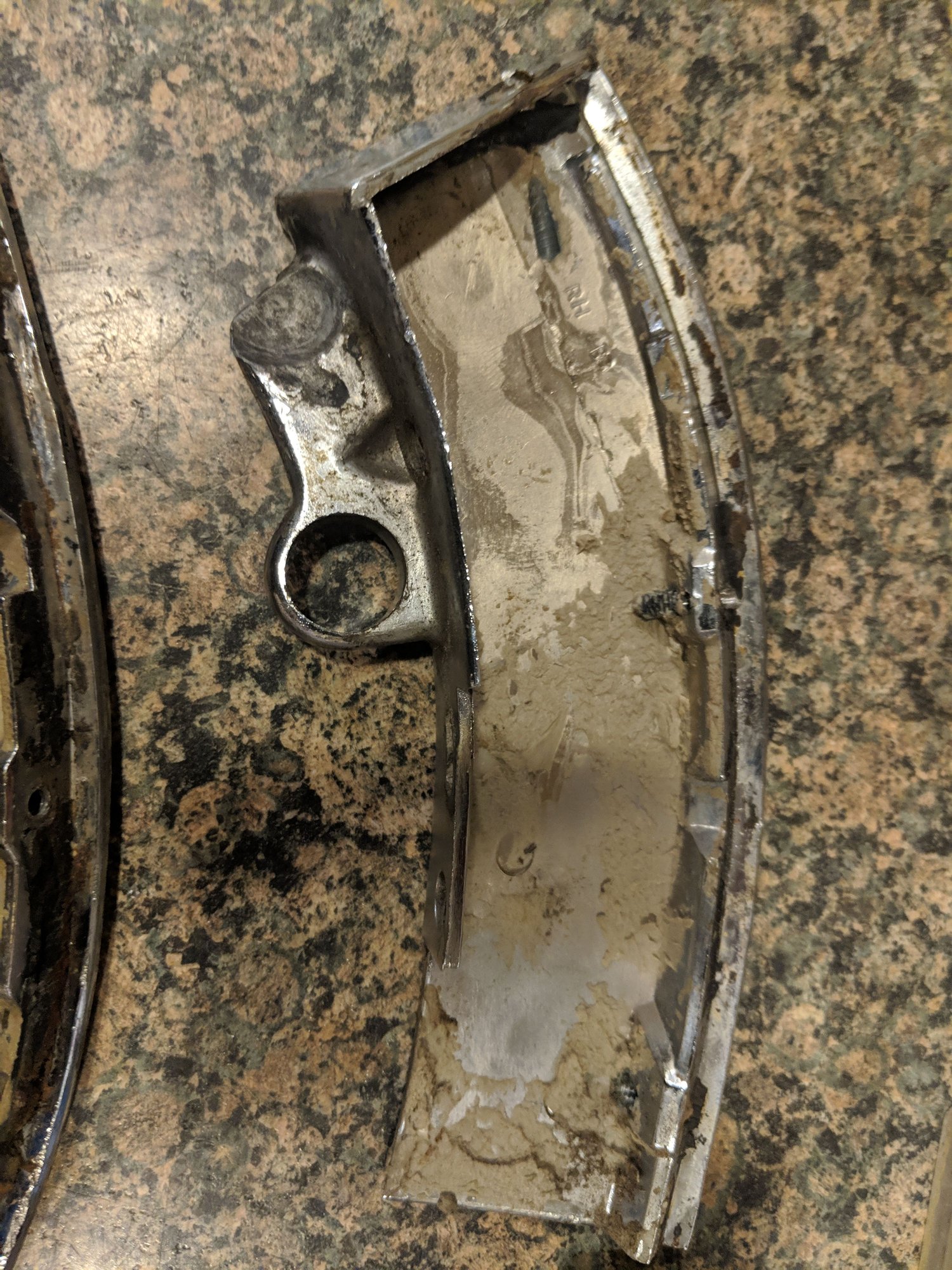

Follow up question. There seemed to be some sort of clay under where these corners are. And it's seen on the chrome pieces on many I've looked at.
I'm sure it's supposed to be there is it putty or what? Designed to keep water out? Where do I get it?

You can use a non hardening sealant instead......such as CRL 7708 This is what I use and it stays gooey and seals very well.
I do not get all caught up in trying to use what GM used all the time due to advances in technology in certain areas of the cars being made today.... often times makes what was used outdated. And it will never be seen anyway....a waste of time using what they used.
Advancements in seam sealers proves what I am saying due to the stuff GM used will dry up can crack and peel away.....depending on the year model. And I ahve seen this clay stuff loose its bold and get hard an allow water to get between it and the metal and a cause it to rust but not leak into the interior.
The stuff I mentioned ...once it touches a PROPERLY PREPPED AND CLEAN SURFACE....it will stick and not pull off of the part it was applied on.

Just a heads up. The 68 chrome end corners have a much flatter curve to the shape of the top than the later 69-up ones. The replacement one's have a much higher arc to them and are harder to make them fit right
on a 68. Which has a different (lower) height upper stainless steel trim, without the screw holes on the 69-up cars. Lou.
