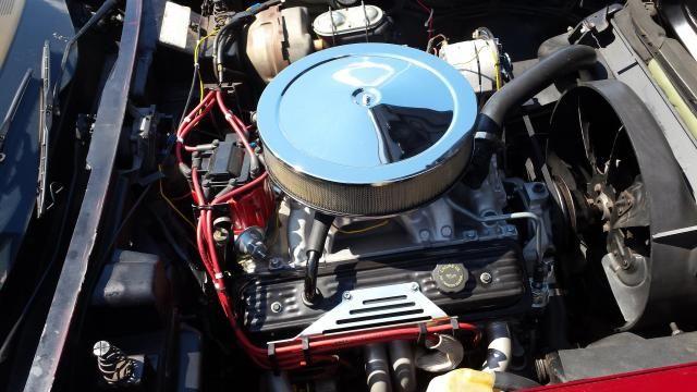

BKbroiler's Avatar
BKbroiler
Joined: May 2002
Posts: 5,086
Likes: 786
From: Lebanon Township New Jersey
Absolutely no need for a bypass. Also, they look goofy. I've been running my 77 for ten years with pipe plugs in the manifold and water pump.
