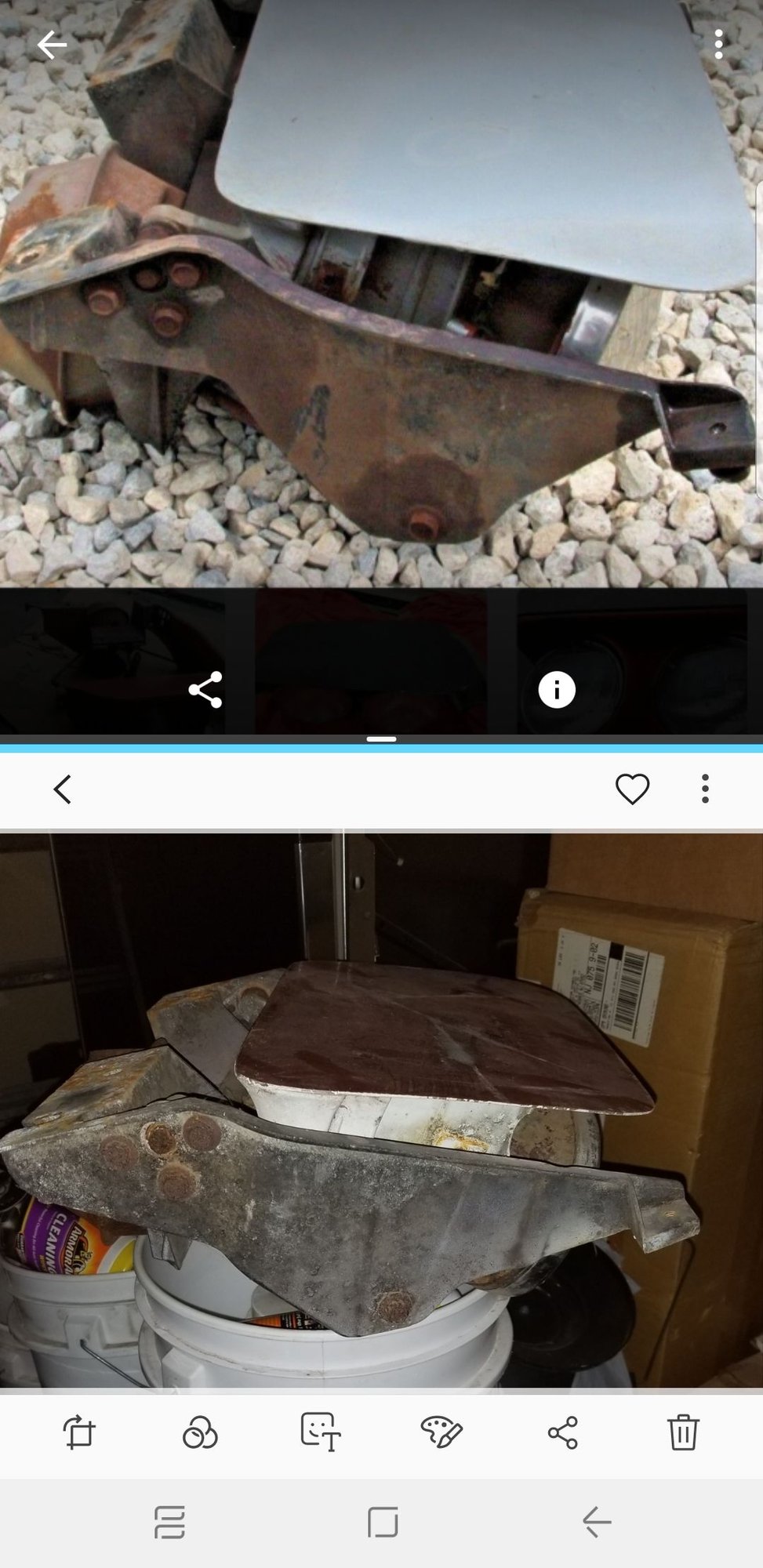

Technically 68-72 are identical. 73-74 can be used if installed on 68-72 with spacer blocks. If you order from a vender this is what you used to get, since 68-72 supports are no longer available. This may or may not be available any more either. 75 on will simply not work.

1975 support(top), 1970 support (bottom)
