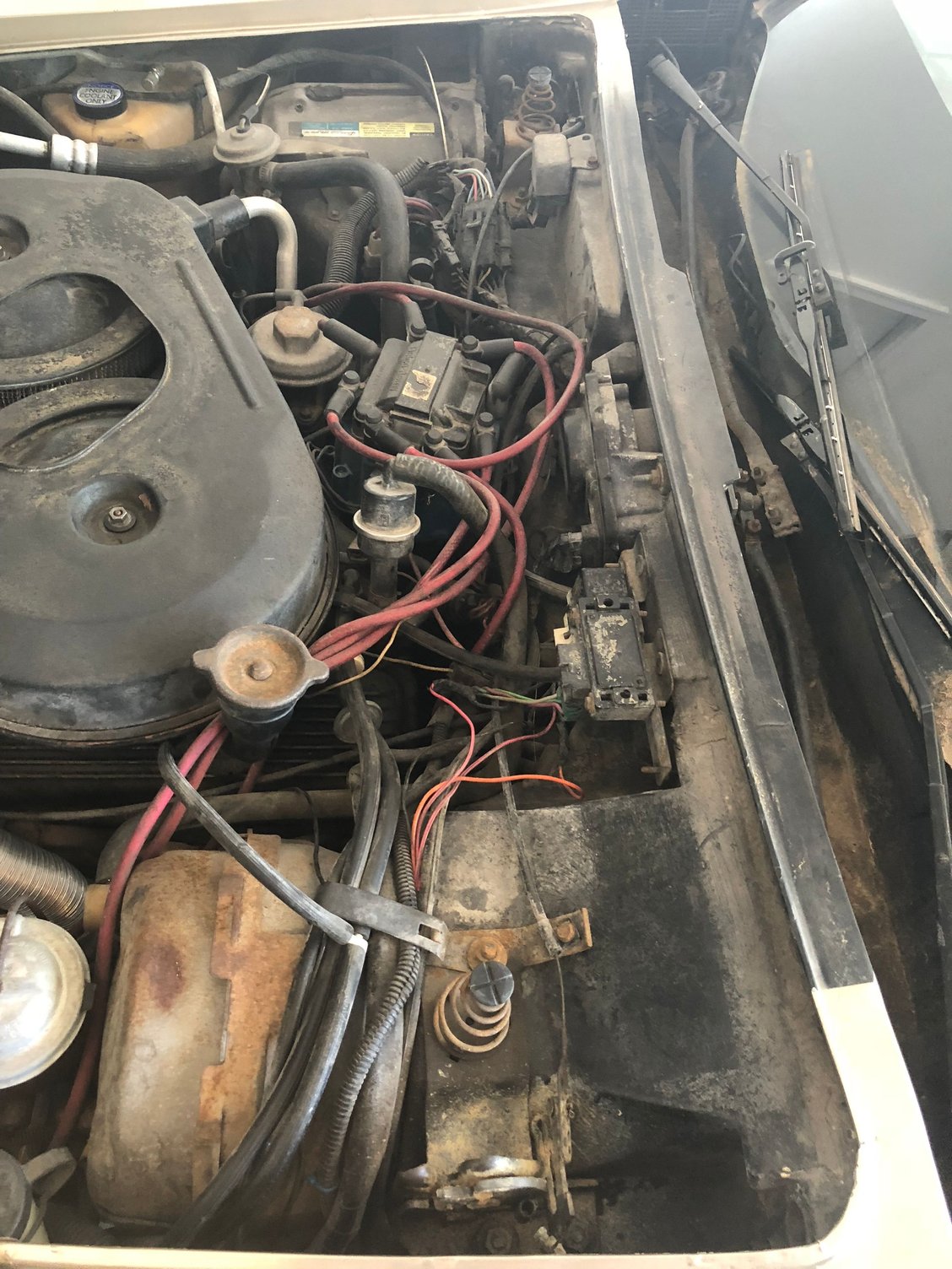

So I've decided to pull the engine on my '82 CE in order to give it and the engine bay a good cleaning, detailing and repainting. I feel like I have a pretty good idea on how I want to do the pull, but any tips and advice would be greatly appreciated. Same goes with the detailing... Anything you guys can offer in terms of making her look like a gem under the hood. I plan on removing the hood and radiator (I know its possible to remove the engine without doing so, but I want to paint and detail both). I also plan on leaving the transmission in the car (no need to remove it). I also will be pulling it from the side due to engine lift size and floor space (I will also be using a leveler). Aside from obvious things such as tagging EVERYTHING and protecting the sides of the car, draining coolant etc.... are there any big tips or tricks out there? Also I haven't really found any good step by step photos/videos out there for the "newer" C3s, so would it be worth my time to take extra photos/videos along the way for future use to others? Thanks for the help!
In need of some TLC
She's original and very dirty
Hopeful Outcome....

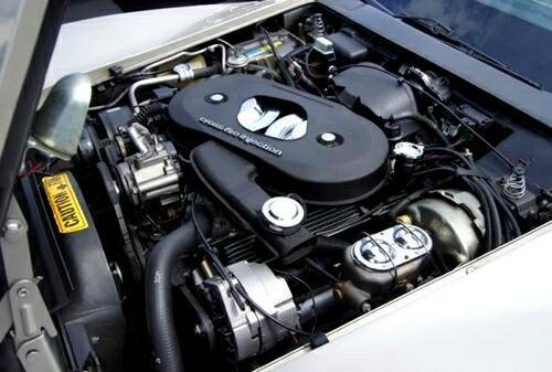

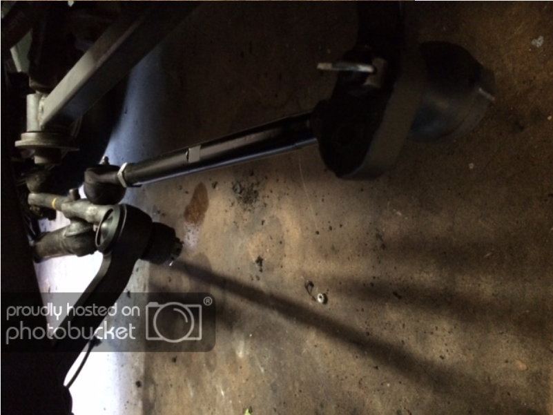

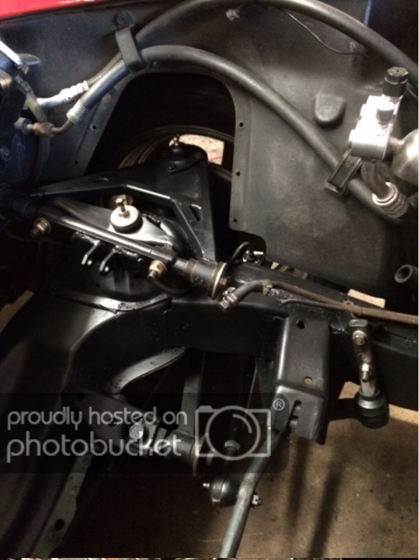

As you said, mark everything. But be ready for the unanticipated issues such as everything rubber will need replacing, including the engine mounts. You don't get many opportunities to work in a wide open engine bay on these cars so make the best of it. A lot of things will be much easier. Transducer, heater core, vacuum hoses, PB booster, power steering pump, and the list goes on. I found a crack in my valve cover so I replaced both of them. Also found a crack in my exhaust manifold which needed welding. Here are a few photos. I used a bunch of brakleen and an air hose but most of the work comes down to elbow grease, time and, as i said, patience.
