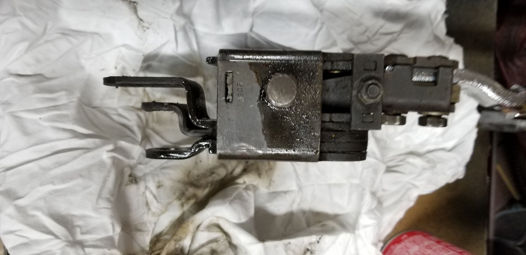

you may need to do some online researsch but i would think that the actual shifter mechanism is the same. The levers are different from vehicle to vehicle/ make to make, the mount to the transmission to push it further to the side in some applications, then of course the rods. If you already have it, bolt it in, its just time under the car and playing in the console. You may have to shim the shifter to the lefft to get it to fit centered in the console hole but everything else would be fine.
I can take a pic of the Hurst Comp Plus that came out of my car later today if that helps
I've been going through this same situation with an old Hurst V Gate 2 that I did a little refurb on. I ended up having to buy rods that where close and making them fit by tapping the threads longer and changing the bend angles. I doubt you'll have to do that since your shifter is still being manufactured
unboxed with Mr Gasket shift lever with junk rods
mostly back to original, awaiting a new guide and rivets
installed on an old tranny before I had finished bending the levers

heres the pics of the Hurst Competion Plus. I took close ups of the part numbers that are visible
front of the mounting plate
part number
back side
part number for shifter
part number for case
patent and shifter name plate
