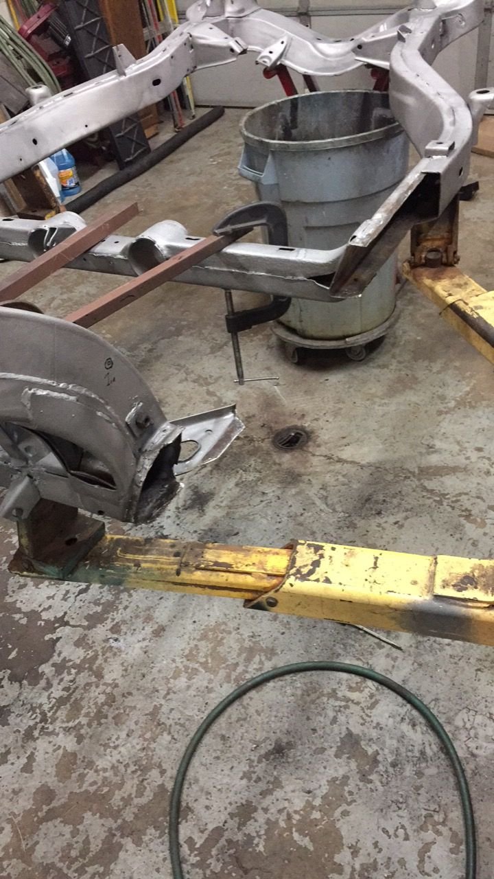

As I've said before re LT-1s, be very, very careful. I doubt $20K would come close to what this car will take. If you can find my thread on the topic of doing mine, you'll get an idea of what will likely be required. Not covered in the thread is windshield frame repair and paint as that was done years ago. So, for the right price, eyes wide open, if it proves out to be the genuine article with ALL the bits - I'm grinning ear to ear every time I drive mine. YMMV of course.

my frame looked like that, i thought it was just scaley but solid... that's until it was dipped and blasted, once i got it back i was ordering repair pieces, you never know the true condition untill you go digging, hitting, blasting. i wouldn't take a chance on driving a car with a rusty frame especially a vette. oh yea and birdcage is next

Have him pull the kick panels and take a picture of the body mounts
Get a picture of the frame at the kick-up area right in front of the rear wheels
Get a picture of the body mounts up behind the rear tires to make sure those aren't rusted out
If he's willing have him pull the passenger side lower dash pad and have a look at the windshield pillars
I've looked at cars that have surface rust that could be cleaned up with a wire wheel and black rustoleum. What concerns me about this particular car is the rust up on the higher areas of the frame ... near the gas tank for example. The cars i've seen with light rust in the areas i described above did not have much if any rust up that high. If this car is rusted that bad that high i wonder how bad the other rust prone areas are. Proceed with caution...unless you're okay with a frame off
