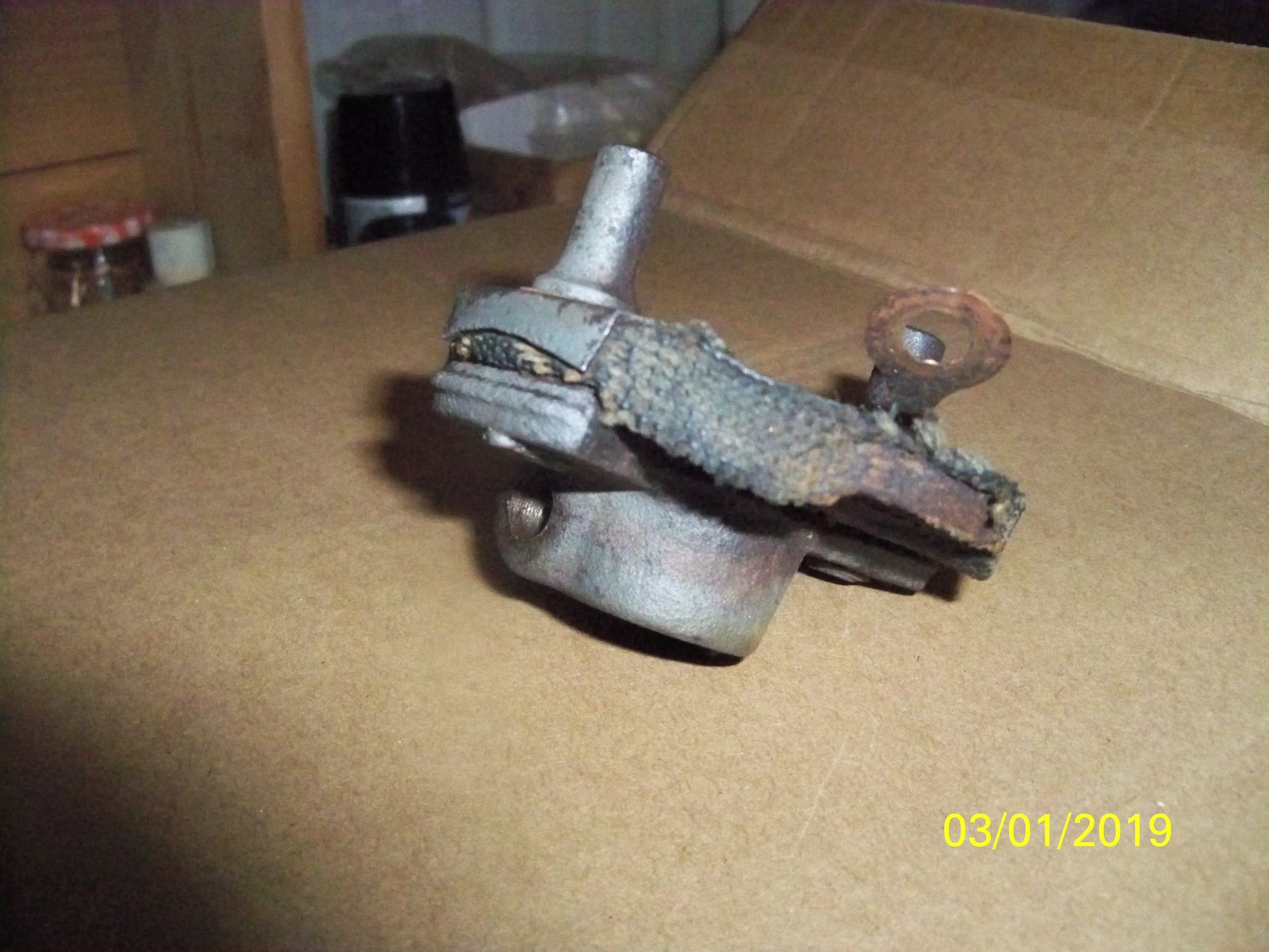

Default Would YOU reuse this..
rag joint.

no. doesn't matter how it looks. it is 40 year old cloth with rubber melted into it.

Another no vote. Replace it.
the repro ones are not much better. that one is worn to the point where I would find a GM NOS one.

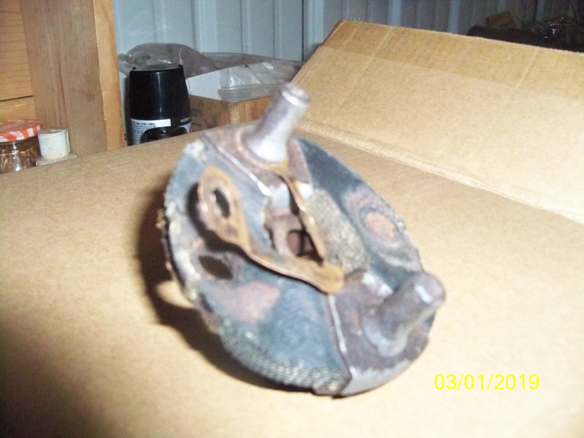

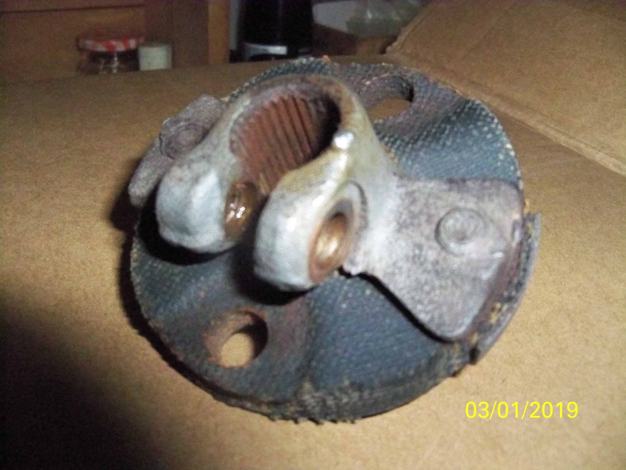

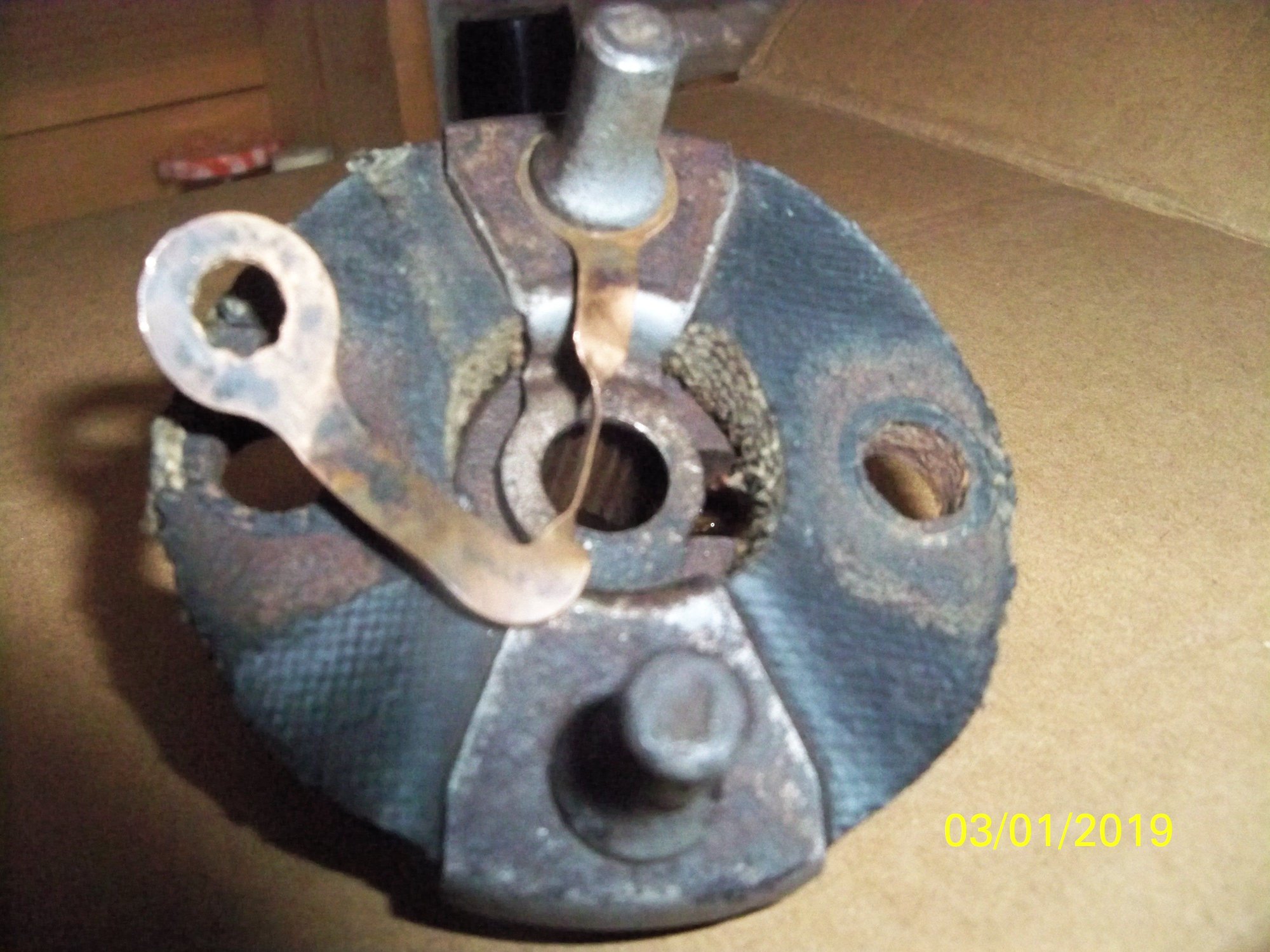

Maybe. It would depend on how pliable or how brittle the flex-disc felt. If it felt hard, I would reuse all the metal pieces and rebuild it with a new flex-disc. If it had some 'give' to it and the disc had no deterioration on it, I'd clean it up really well and put it back on. But, it would get regular visual checks and would be removed if disc began to deteriorate. Flexibility is the key attribute for that part.

Bottom of the last pic looks like its starting to tear
