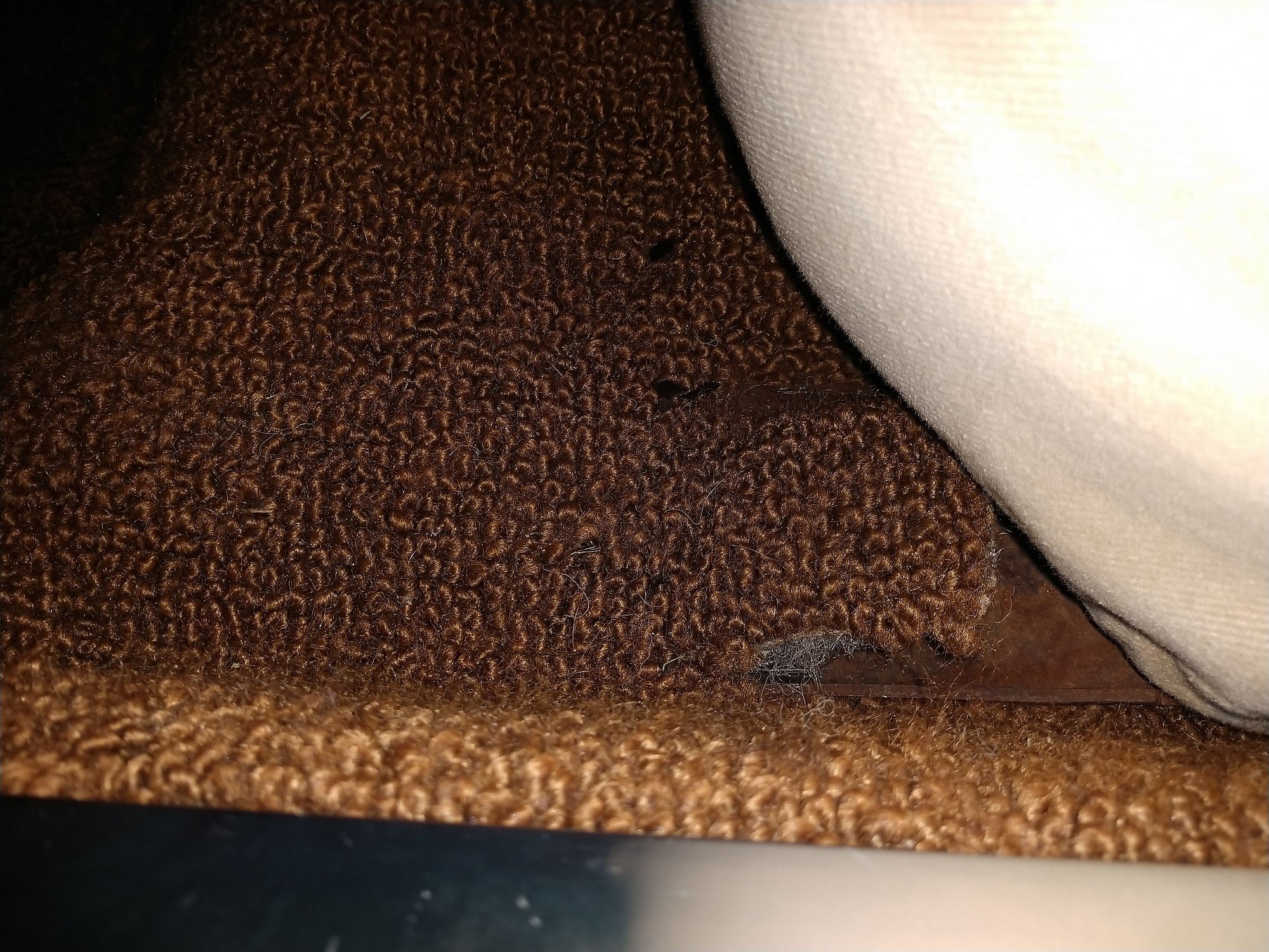

My car had the original carpet in it when I replaced it and I just matched how it was cut. Works nice. It was like this front and back. I did "paint" some contact adhesive on the front ones and glued them down on the bolts so they stay put. I peeled this one up to get these pictures. Hope this helps.

Yes, yes, that really helps! I know it won't be what the judging guide recommends, but has anyone ever considered putting a hole THROUGH the flap and the bolt itself holding the flap down?

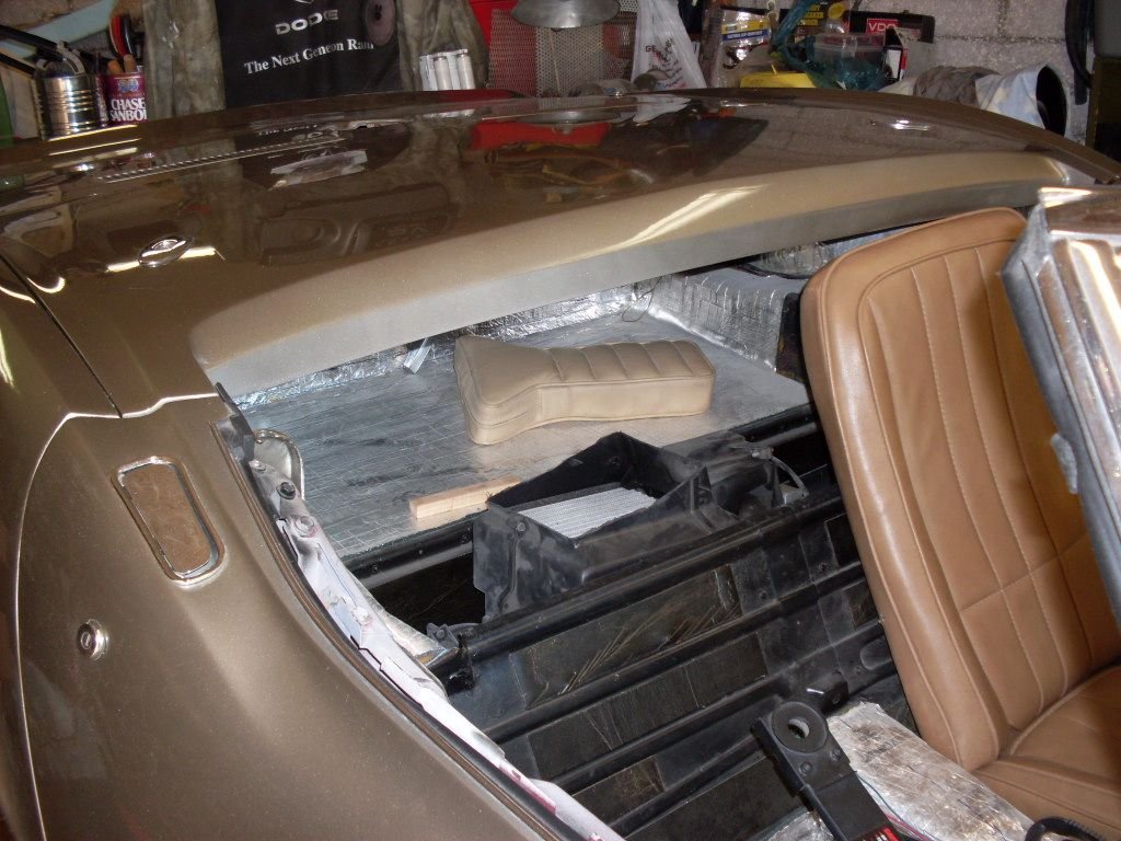

Okay as a slight inspiration to the poster.... I hope. Dynomat/Mylar (plasticized) Jute and etc.
Concentrated on; Rear wheel houses, Floor boards, tranny tunnel, firewall.
I took me longer to put that stuff in than the carpet!
Also note that I used Bitulastic on the rear firewall BELOW the ribs (as in not as high as the ribs) so I could maximize the legroom.
Ps....in the jack compartment is me fitting up a hidden airconditioner!
Good luck all.

The car is in closed storage now....Driving the 82 CE instead. I've owned that car for 42 years , the 69 L-46 M-21 Two tops, Side exhaust , delete,delete,delete, delete puppy) No ps, No pb, no radio, no heat....just RACECAR! (ish!) Convertible top is out of the car permanently..so you can call it a ZERO-Top car....added a little weight and took out a ton! The car weighs -3000 now.
Before I did all the insulation, I re-fiberglased the floors and battery box as well. So now they're double thick.
Okay RIBS....if you look carefully you will see stiffening ribs on the firewall behind the seats...they protrude 1/8th inch....I Bitulastic'd the 'in-between troughs'.
Further road noise suppression.
I'm pretty tall and did some mods to the seats to maximize my legroom. Removed the hard shell behind the seat and carpeted to match the 'cavity' negative 1/2 inch.
Then I pulled the seat back bumpers so I can rake the seat back a couple more degrees. I'm not worried about wear insofar as the seat/carpet is dead against the firewall. Notice there is no Mylar/jute in that area....a compromise to my leg room.
I modified the seat tracks to move them to 'max-back'.
I added spacers under the front of the tracks for comfort (up 1/2")
Most heat comes from the tunnel gear shift.and.front firewall ..a little better on side exhaust cars....you just sear your leg when you get out! (Fiberglas covers helped a lot!)
Noise is almost ENTIRELY from the wheel wells. well bad noise versus GOOD noise
Be careful if you have an early model with the dimmer switch on the floor...cut the jute/dynomat away from the switch...you don't want to STOMP the floor when you need to see!
Most importantly is the GLUE you use....spray glues like 3M '90' and etc....CHRYSTALLIZE in about a year , get hard and flake off.... I use LATEX water clean up carpet cement...which BTW is a sound deadener as well. I was in 'interior and exterior car designer /engineer' for a un-named car company....it's amazing what you learn doing that stuff! The no spray glue stuff came from the SEA-RAY guys we hired when that boat company er ah 'sunk'
Very best of luck
