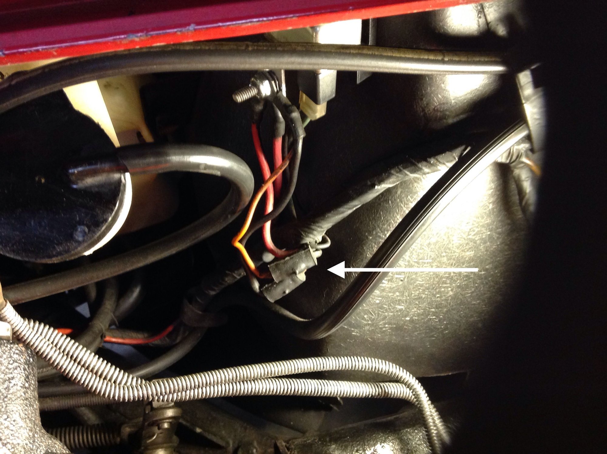

The main fusible links are right at your Horn Relay on the 73. You can also check the wiring at the Starter. Good luck!

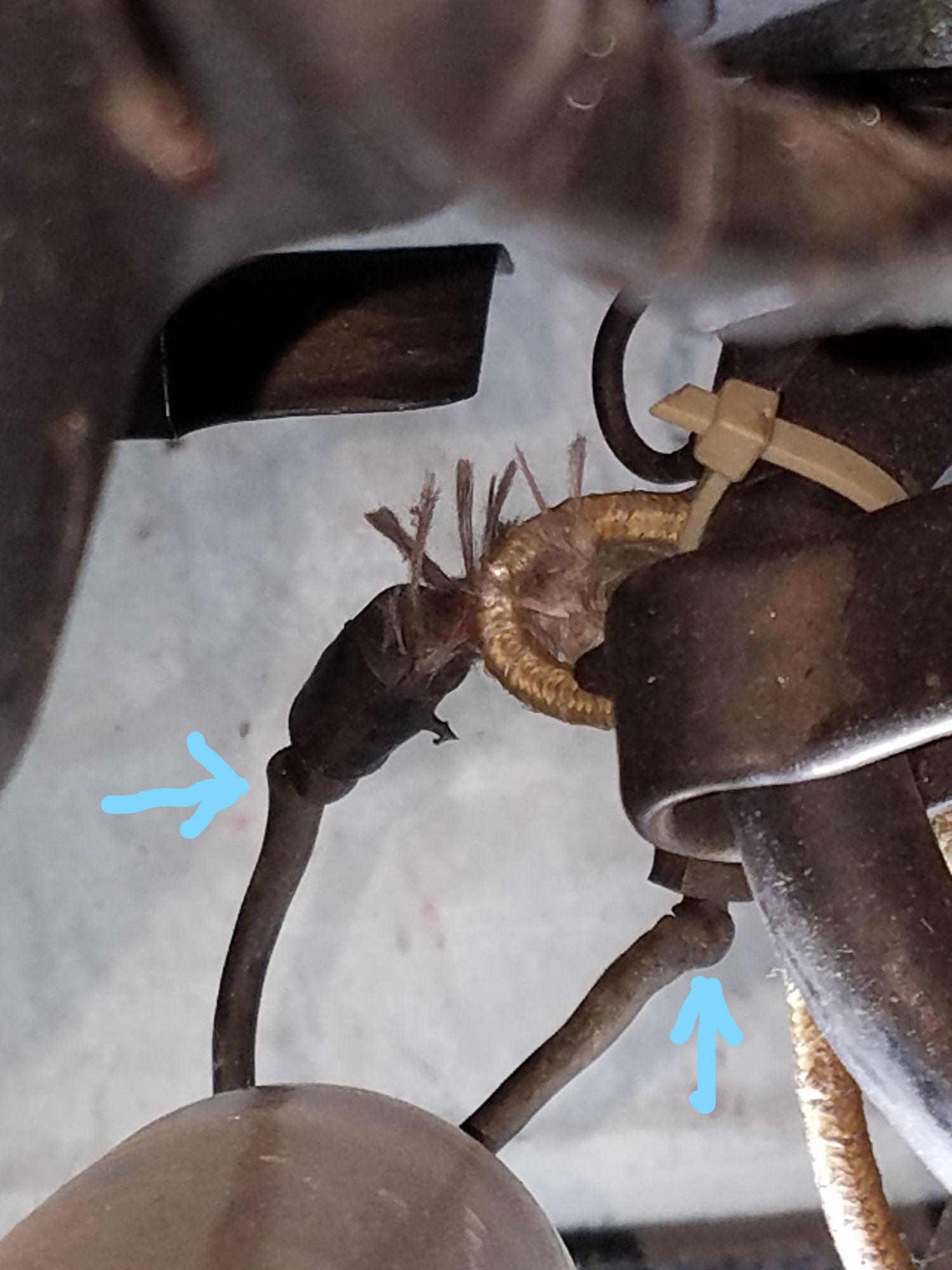

The thermal fuse by the horn relay is good... However when I checked the one on the starter it looks suspicious to me... although its not burnt through there is a swelling pointed out by the arrows.. any thoughts on this??

Dead as a doornail....nasty!
If you can't find a replacement...probe the wire with a needle and a AVO meter and cut out the tiny burnt bits and resolder and reseal...check continuity again.
Obviously a replacement is called for...It's weak now.
