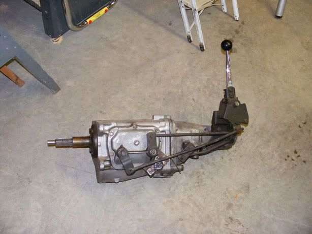

Post some pictures! If the shift linkage arm is reversed on the transmission, perhaps you would see this symptom.

It sounds like he shifted 1-2-4-3, not 1-2-3. It may be as simple as a loose bolt on the shifter lever. However, if the 3-4 shifter lever were installed upside down, moving the shift control rod would work the opposite of what it says on your shift plate for those two gears. Here's a diagram of a 1970 Muncie (shift levers go up), and a picture of a 1968 4-speed Muncie (3-4 lever goes down).
I'm speculating, but a photo would show that, and while you are down there, check that the shift lever bolts are tight!
