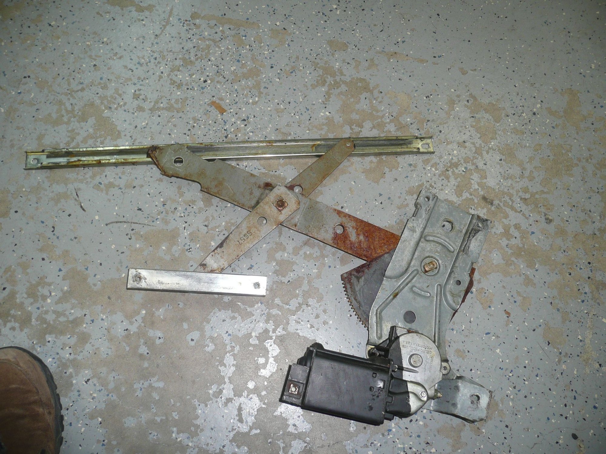

Can't tell much from you video. You'll have to pull the door panel to see which part is broken. Here's what the window lift mechanism looks like. As I recall, the long horizontal piece is fastened to the window glass and the short piece to the door.
