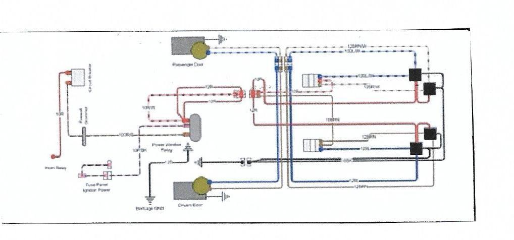

Grounding the case does nothing. You have a reversible DC motor. Hook a power and ground to the terminals and see what happens, then swap the wires and check again.
If the motor doesn't work, ground a test light, actuate the up/ down switch and check for power at the harness connector. Should have power to each terminal, corresponding with the switch position.
I could be completely wrong. But I don't believe the motor is case grounded.
If you have power, and the motor doesn't function, it's motor time.

There are two terminals on a Corvette power window motor.
Applying power to one sends the window UP.
Applying power to the other sends the window down.
The motor case must be grounded or it will not work.

Thanks for the diagram. Shows case ground.
All the window motors on the vehicles I work on, have the two terminals, but the switch reverses polarity.
Thank you for correcting me.
Jeff
