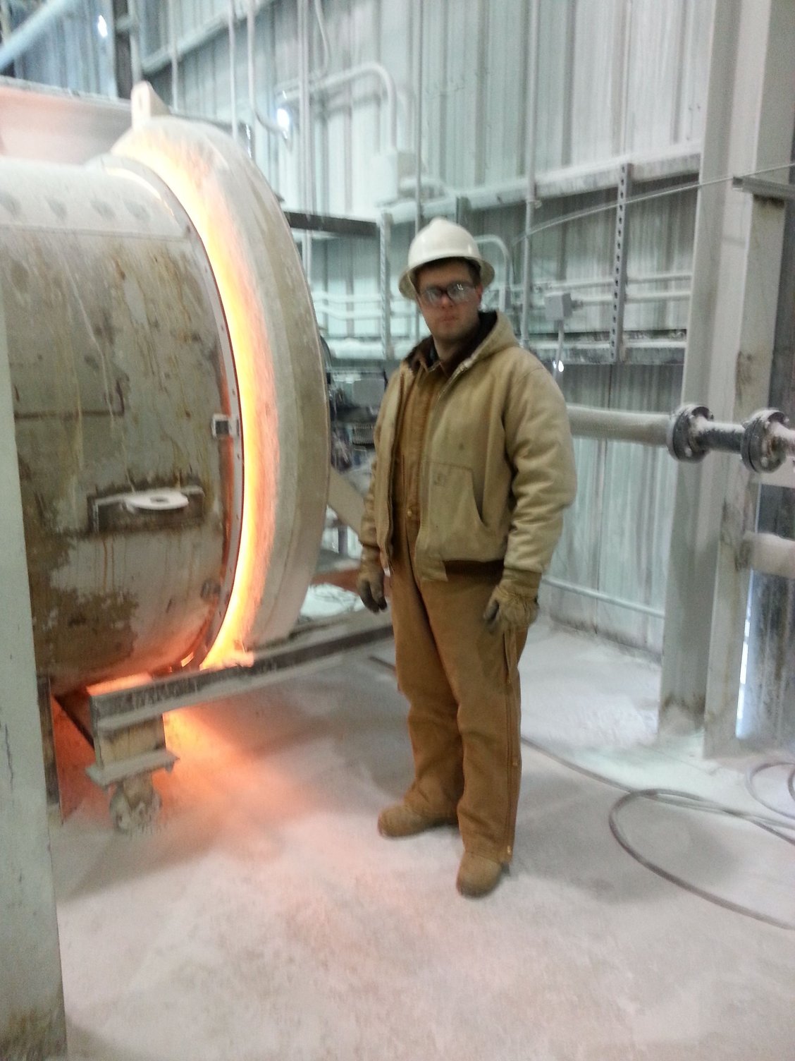

Originally Posted by ratflinger
So where would one find this magical 1600* RTV? Best I can find is Permatex Optimum Grey that's only good up to a pathetic 700*
Amazon Amazon
One of the kilns the plant uses, regularly gets up to 2100* and red devil high temp is on every one of the joints of the stainless stacks that transfer the heat elsewhere where it is needed

Okay, but still only rated for 600*
Okay, I'm sort of being a jerk, I suspect the 1600* was a typo and should only have been 600*
