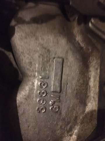

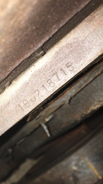

I really need some help with identify what engine is in my 69. If there are any block experts I could really use some assistance. Here is what I have found. The rear block by the bell housing reads 393352 GM HIPERF (I think) difficult to read. The front block stamping is T0506LI 190218715. Intake manifold numbers are 3933198.

Check the block casting number again. 3968512 might be right. The block was assembled and stamped in Tonawanda on May 6th. T0506

i found LI as 335 hp 69 427 auto trans.. i can't find block casting. keep in mind cast numbers can have meat missing or a casting flaw can add meat. 3,8,5,6,9 can all be confused with each other.

1969 Corvette VIN derivatives were 19S7xxxxx so you have a problem with the 02..
You might want to take a closer look at both numbers.

Thank you for all of your help and input. CanadaGrant is right my rear block casting is 3968512. That mystery is solved.
I do believe the front engine is T0506LT instead of LI. Still looks like LI but i think there is a scratch underneath that's making it look like a I. Really difficult to see the difference.
My VIN appears to be 194679S716747

The stamping is definitely LI.
The block is not stamped properly for a 69 corvette. If your corvette is VIN 194679S716747 then your original engine should be stamped 19S716747 not 190218715. Also, your car was built Feb 18/19 1969 and that does not line up with a 0506 engine assembly date. So the engine is not original, but not sure what it came out of.

LT is 435 hp engine. Forged crank and pistons. Rectangle heads. This is LI. Cast crank-pistons. Oval heads.cams don't matter. Either needs to go.

19?218715. Is it a zero? Top half is gone. It could be about 6 letters. Did C,G,O,U,Q denote any plant like S did st louis?

3933163 or 3933198 intake. both rectangle intakes. 98 is a L88. looks like a long time ago, somebody buffed the 63 off and stamped hat 9 and i assume an 8 newt to it. pull a valve cover and get head casting numbers and pic of top of the whole engine.
