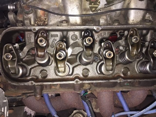

numbers on pad say 335 hp impala engine. intake manifold sez rectangle ports. could be bolted on to oval port heads. could be rectangle heads. so what we KNOW is 50 years ago that block had cast crank, pistons and 3/8th rod bolts in it with oval heads. it could have been left alone except for putting a bigger intake on and wearing it out. it could be a very special highly upgraded engine. most likely is orig crank-probably .010 cut, re-ring or 30 over rebore with new pistons. pull a valve cover and post pics, do a compression test. and we can mebbe see what kind of valve lift which will provide some guesses what type of cam is in it.

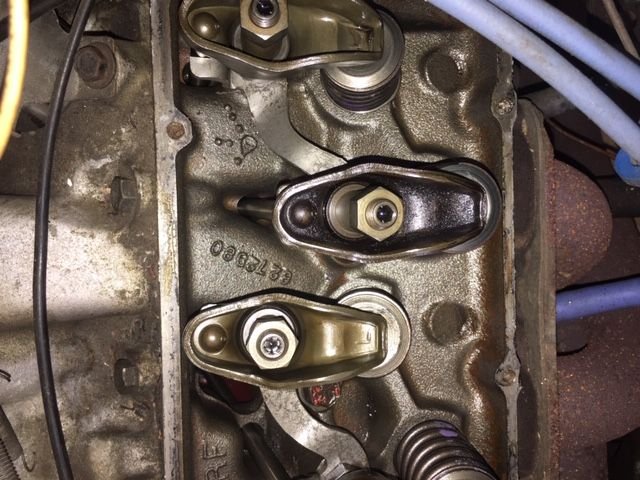

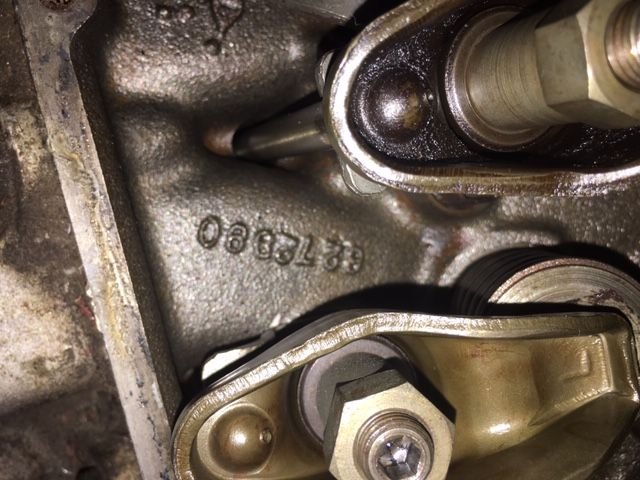

Number of the heads appear to by 6272990.

Mercruiser rectangle hi-perf heads. Or 70 454 service replacement heads. The mercruiser 365 hp magnum. Is a 71 LS6 with iron heads.and a crappy marine cam. But them Heads are good chit mon. Odds are that bottom end has been rebuilt too.if orig pistons, probly around 9 or 9.5 to 1. Even the lopo 427 was around 10:1. Lopo 427. Oxymoron. Kinda like jumbo shrimp or military intelligence.
