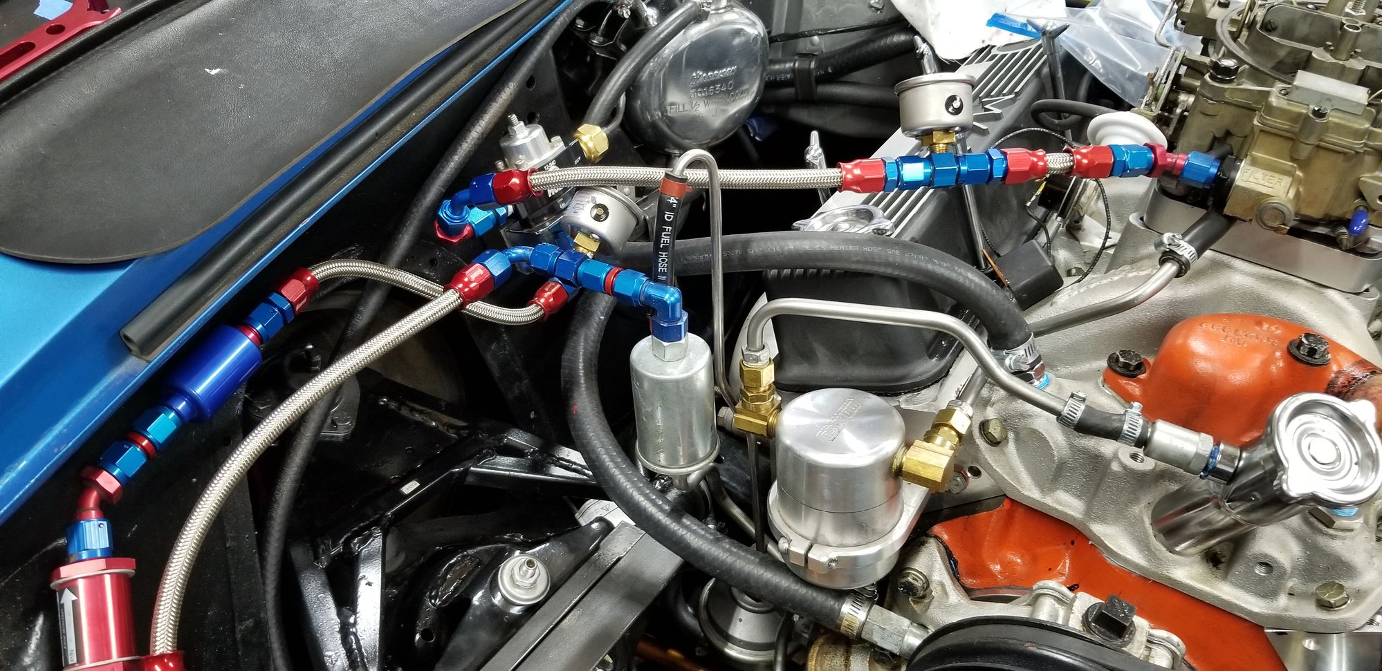

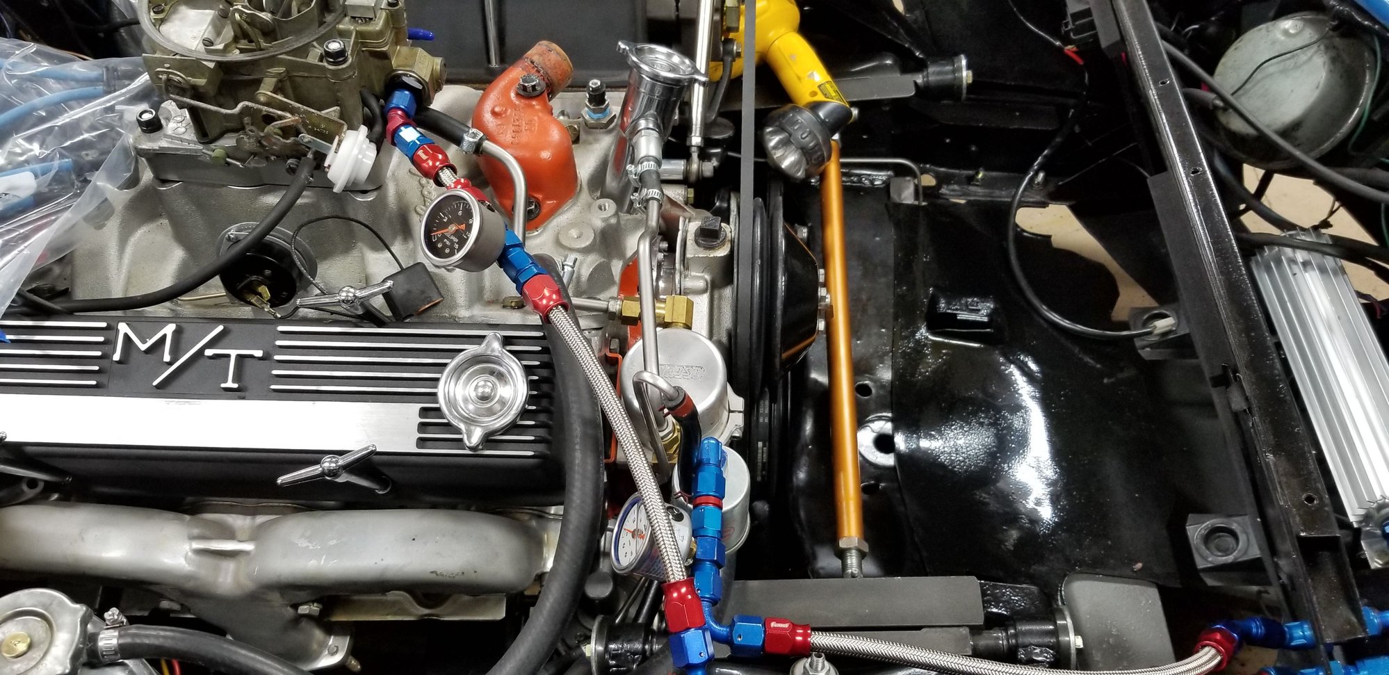

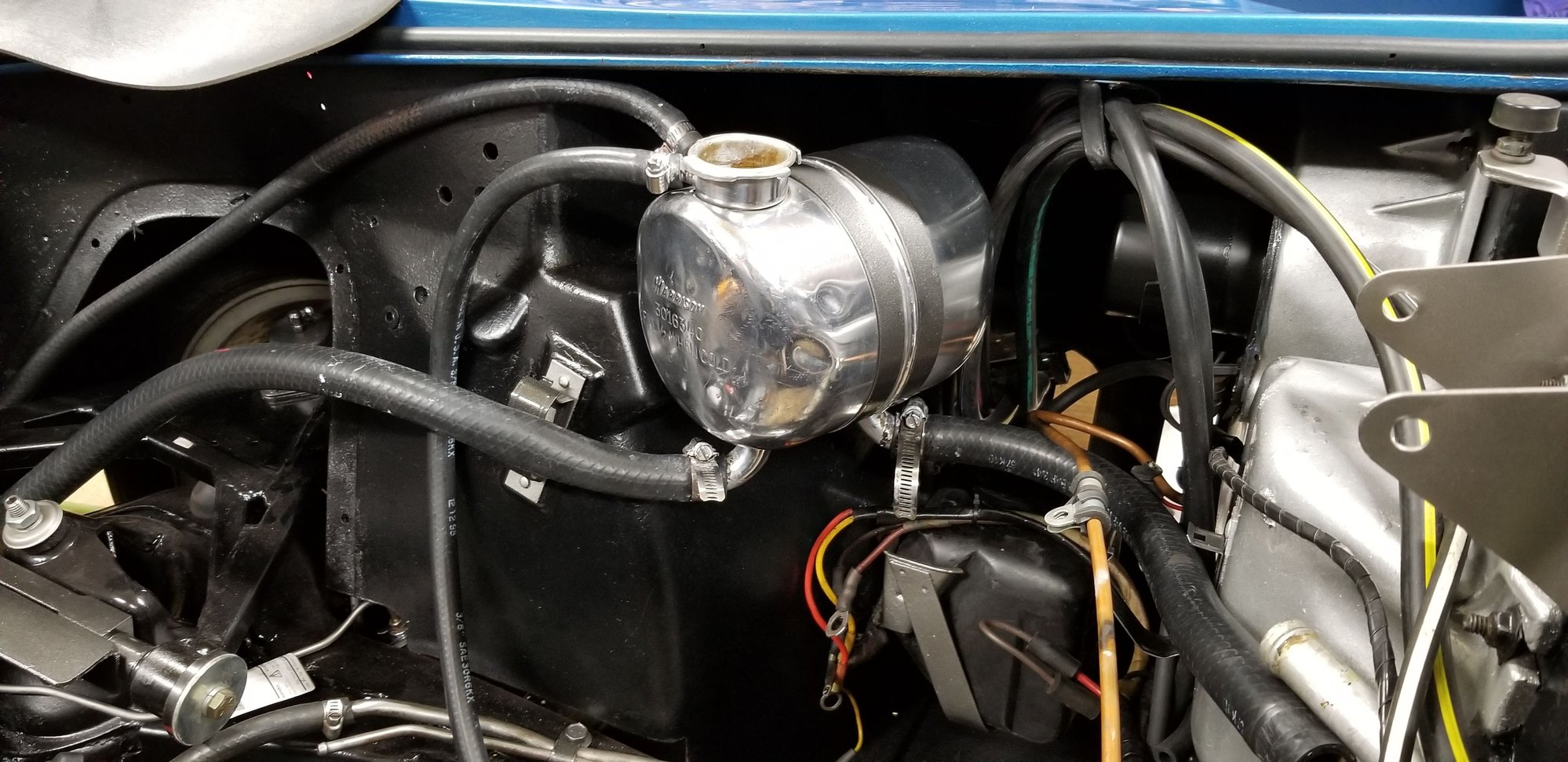

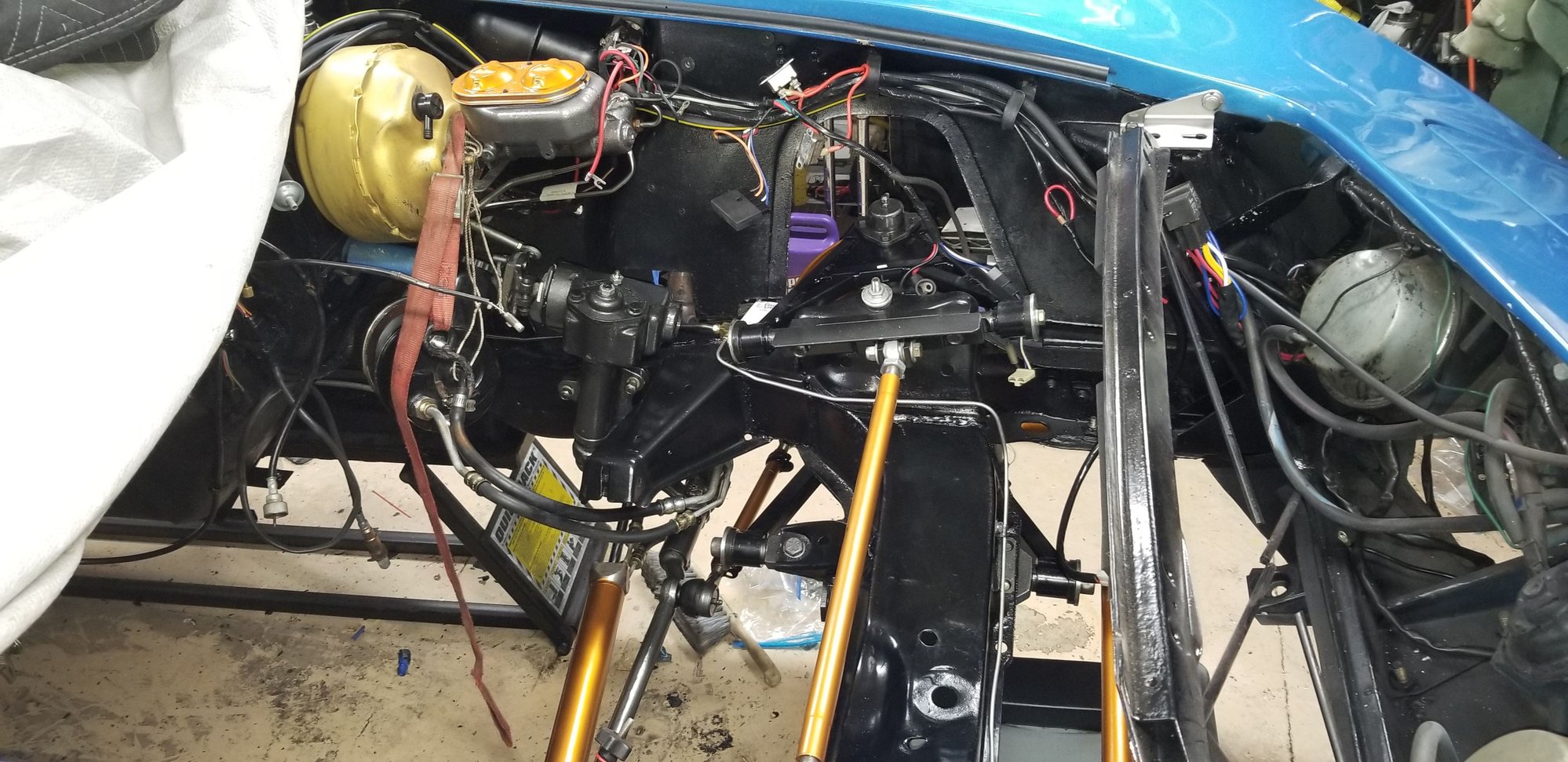

Take your time and plan ahead. It can be done quickly and while the engines out you can fix the leaky oil pan, paint it up nice and pretty. Clean the engine compartment. Change the radiator fluid. Oil change. Theres a lot of benifits of pulling a motor if you look at everything that can be done at once.
before
paint and polish
the clean up
the reassemble, afterish
