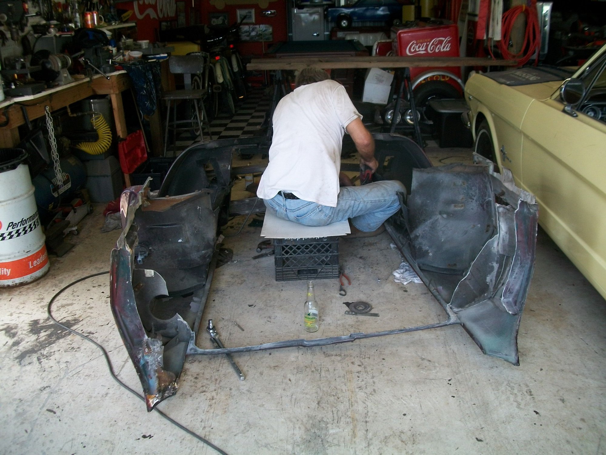

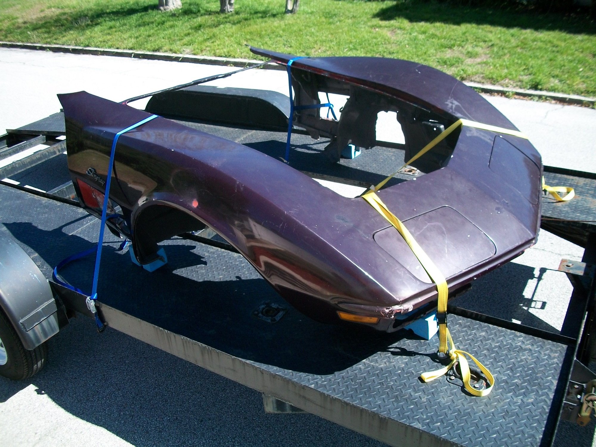

Mine did. Our car had fiberglass damage to the nose when we bought it. So I picked up another 71 front clip.... and it had rivet bumps. But it was easier to fix being off the car, I was able to lay it upside down on the garage floor.

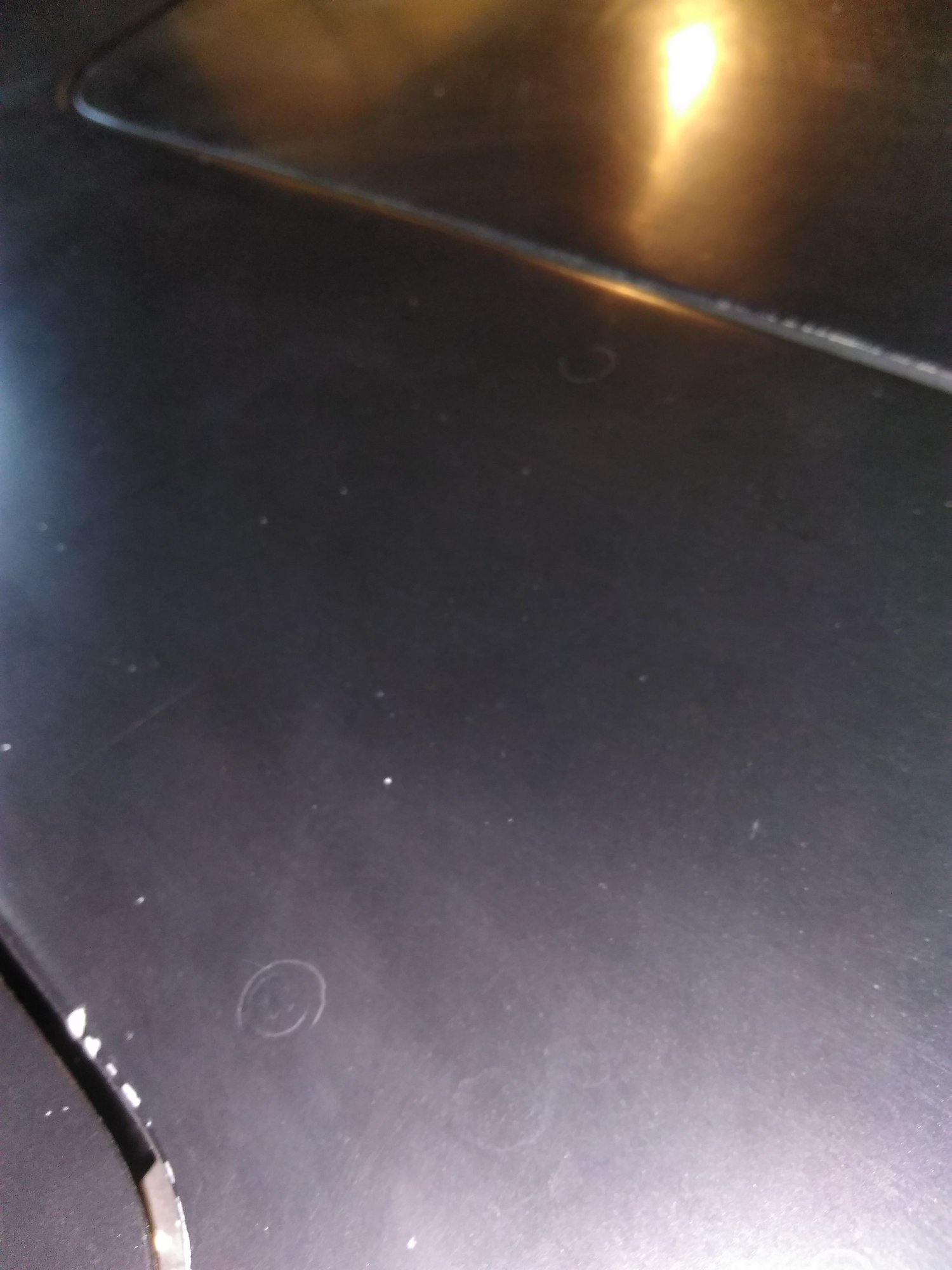

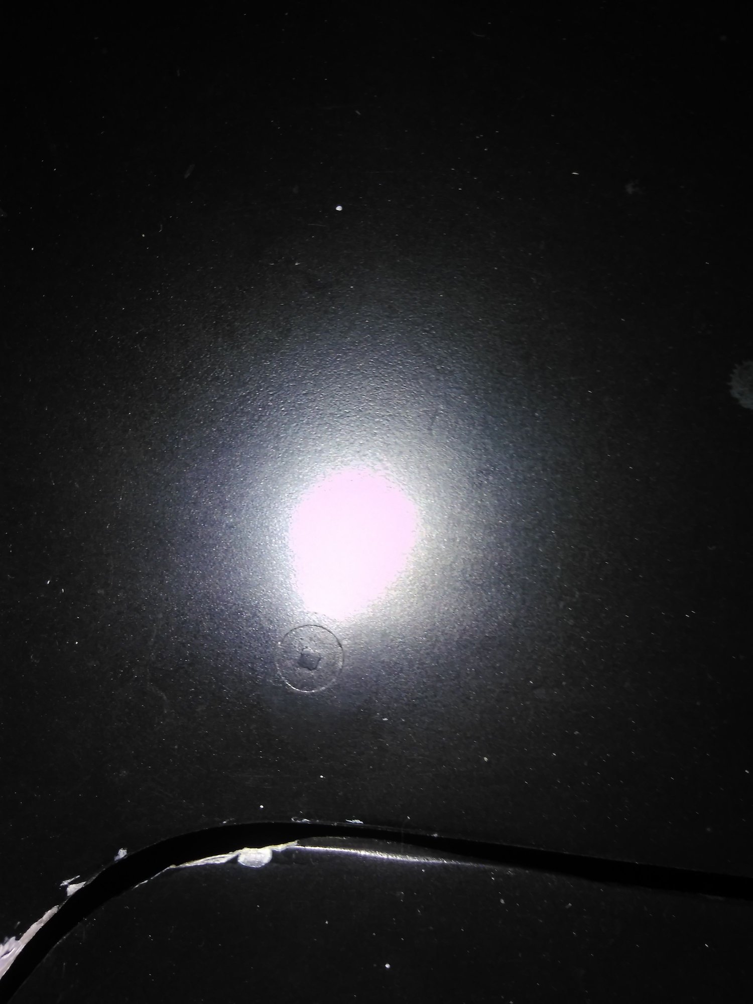

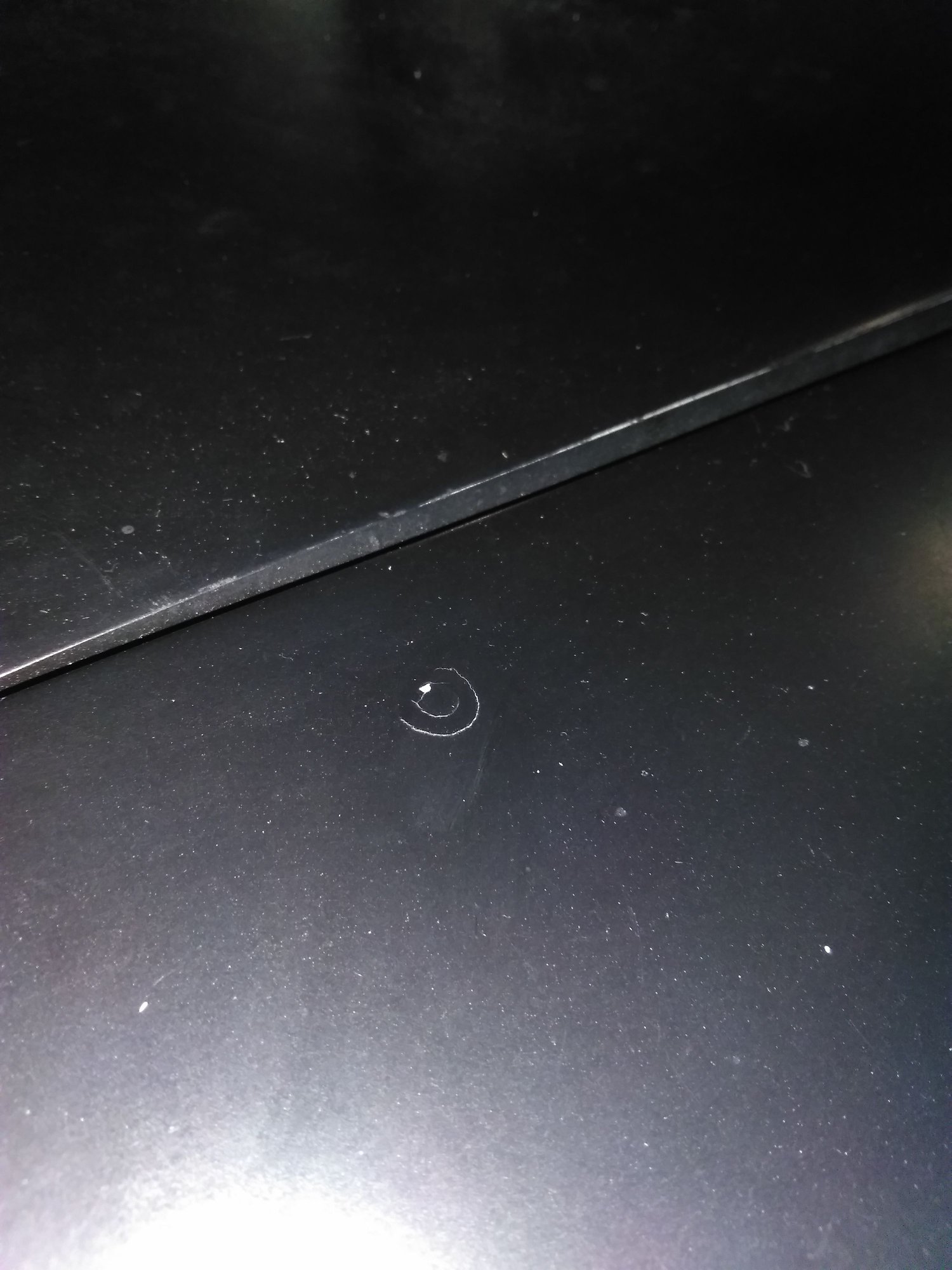

Given the number of odd things I've found on my 81 I wouldn't be surprised if this is the result of some past work. But it seems to be rivets showing through. The first photo almost looks like a square drive screw. I should check from below what it looks like. (other that a little rusted)
Rivets are much larger
