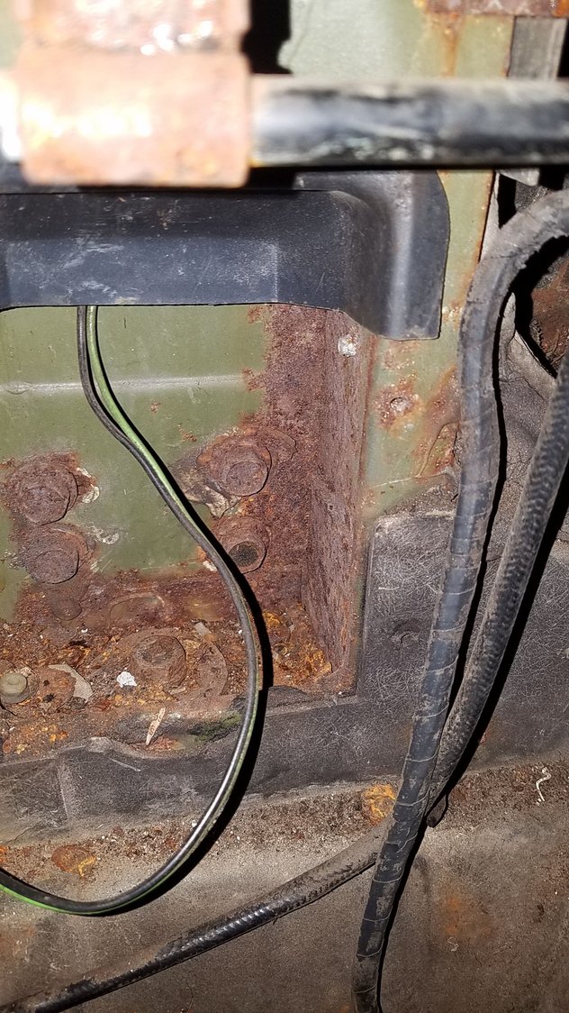

Body mount bolt #2

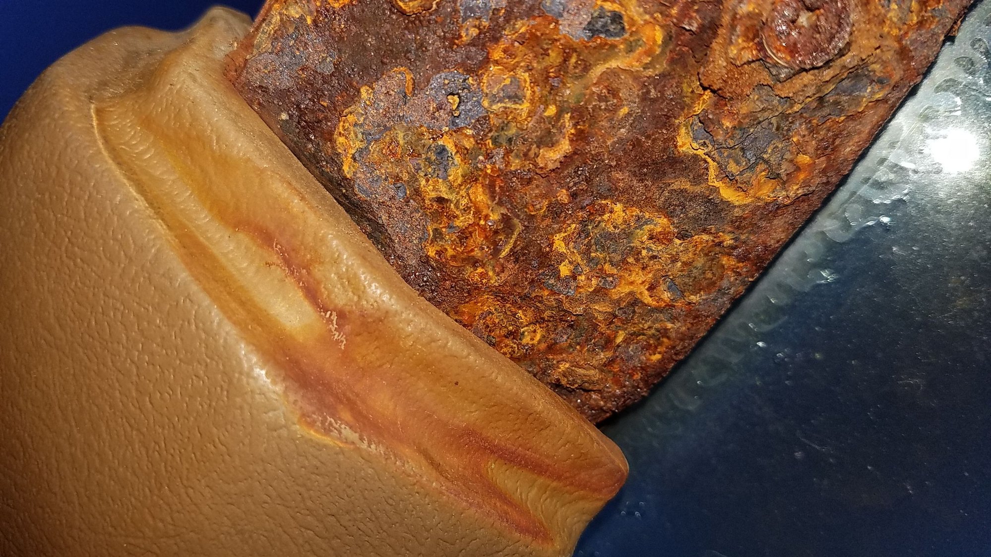

Drivers side under t top trim. This looks somewhat fresh.

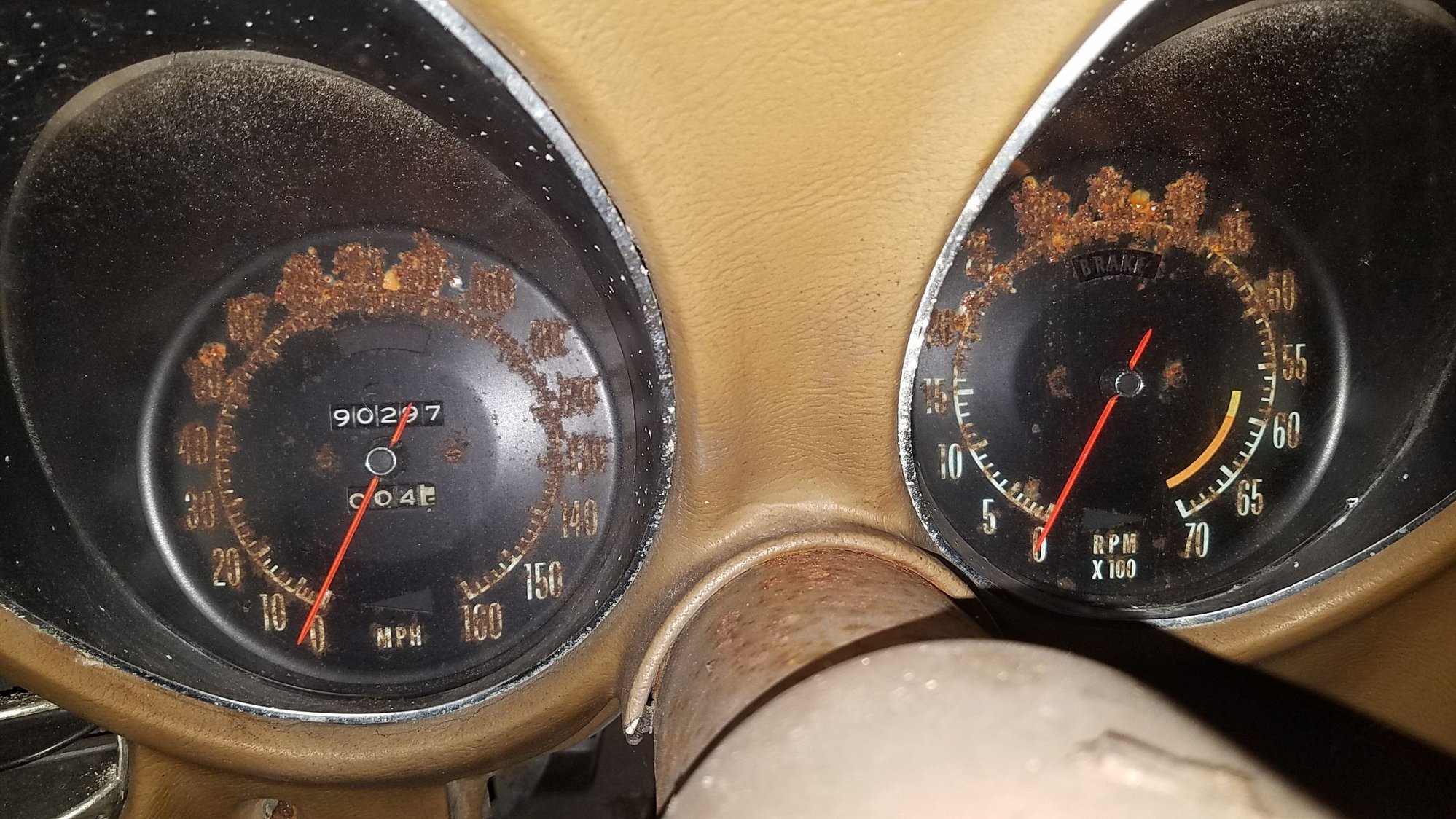

Behind guages
These are my very sad looking guages.

Wow, all I can say is yikes as I would have run after seeing those gauges and what looks like more rust in the steering column. The bird cage in these things can’t be patched together, I would be looking for a new one and hope there’s enough integrity left to hold it. Good luck this looks like a tough one.

Having restored a rust bucket I recognize some of the rust areas you are showing. I believe further investigation will show many more areas that will need attention. With the body in such rough shape internally I would suggest you get the car up in the air and look closely at the birdcage channels, lower channels of the body, look at the seat belt mounting hardware for rust, tunnel support metal brackets, anything attached to the body that is metal may be rusted badly, or the fasteners rusted to the point of being unsafe. You really won't know the full extent until you gut the car of carpet, all gauges, dash pads, etc. The good news is you can make this car your own because the stock parts appear to be toast. I didn't run away from mine, maybe I should have, but it came out beautiful in the end. Lots of time, care, and money to repair one of these but if you have the skills to do the work yourself you can help reduce the labor portion anyway.
Tough to see these rust so badly but not at all uncommon.

WOW, I think this car has been under water. How else would there be rust in the guages.
If I were you, I would gut the interior and wire wheel/grind out all the rust you can get to, then paint the surfaces with POR 15.
I already did this with mine, I also sprayed Krown/Rust check down the inside of all channels that you cannot get into. Like the bird cage.
As long as the metal is strong and not brittle, you can save it. Anything that is brittle needs to be replaced.
Get yourself some EVAPO-RUST and trays to remove the rust. I did every bolt, nut, washer and clip. All perfect 24 hours later.
I used a wall-paper tray for my seat tracks, painted and greased them up the next day and they are perfect now 5 years later.
Sounds to me like the guy did a lipstick job on the frame to hide what happened.to the car.
Being that this is a 69, the floor pan is fibreglass like mine so no rust there. You just have to deal with all the metal areas.
My kick panels looked like yours when I started. It took a wire wheel and several hours to clean them up and paint them. They look new now, so I drowned them in oil before I closed up the covers. let it slosh around in there to stop any further rusting.

If I can make an observation, I think your car is a "flood car". i have never seen rust like that on any car in the interior. if the seat brackets and pull leavers, dash and any metal part is rusty on the inside, that car was exposed to some major major elements...

When I looked at the first pic, I thought to myself, “I’ve seen worse”. Then I looked at the rest of the pics and corrected myself. Wouldn’t surprise me if Ken is right and that this is a flood car. I’ve seen the plates on the back of gauges be rusty but not the faces. The pervasiveness of the rust would really concern me. You need to investigate the frame and birdcage further to see if this is even salvageable.

Best of luck to you, OP. If you don’t mind telling us, from what part of the world did this car come? I too have never seen rusted gauges as in yours. If not under water, maybe it was left in the elements with the top down or windows down?

You may not believe this but it is a california car. I have the plate with a registration sticker from the early 90s, the last year it was registered. Do california cars look like this if they are at the coast? Or does it take them being IN the coast to look like this? Lol. As far as I can tell it had some form of restoration done in the early 90s. Reuphostered it, changed the paint from green to black. The original l46 engine had maincap and rod bearings dated 1990. So somebody had rebuilt it around then. It must have been in a flood then. The power windows are trash. I appreciate all the input so far. This has been an eye opening experience for me.

No. Coastal cars may have some surface rusting, but not internally...and certainly not INSIDE the gauges. This car was in a flood...somewhere. Hopefully, it wasn't in a salt water flood....

Salt water flood would explain why the inside of the t tops are rusty, and not the outside. They sound like maracas when you turn them.

I have seen gauge rusting in 'field' finds.. this car has probably sat somewhere for decades.

That has to be salt water intrusion. Salt crystals embed everywhere and continue to draw moisture even after the initial flooding allowing rust to continue to grow. Too ad. My two cents unless it has sentimental value to you get out now!!! Ike

heres my opinion, i can tell you already you need the outer lower windsheild corners, the inners, the top of the windsheild frame,and corners at MINIMUM. the front clip will need to be off and probably firewall. check your rocker rails as well, they are probably rusty, i know this from experiance, i have the front clip off my 68 and once i get a XXL cup of mud down this morning im going out to weld the lower corners and upper corner on my 68s windsheild frame. it sucks i know. if your anywhere near chicago i got a good 71 front birdcage section, minus the outer lower windhseild corners of course. the work really isnt bad at all, just dirty rust, dust and metal shavings all over.
