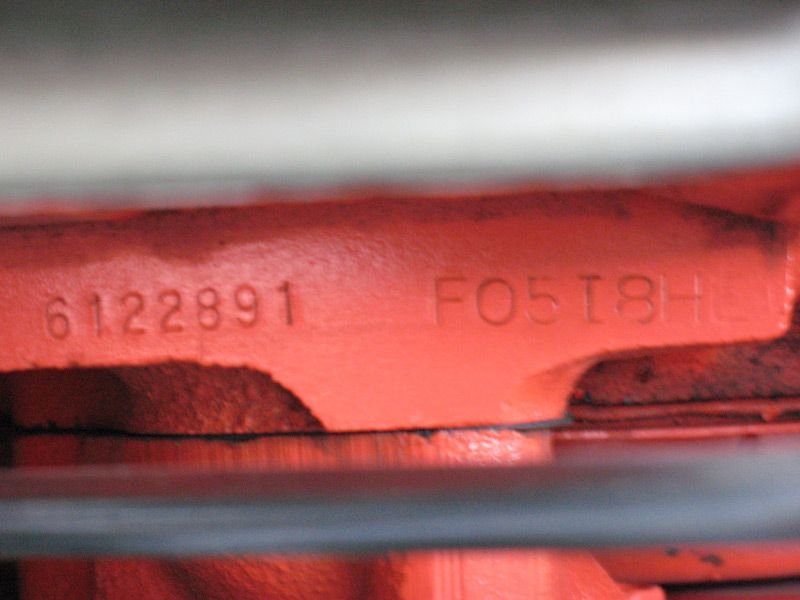

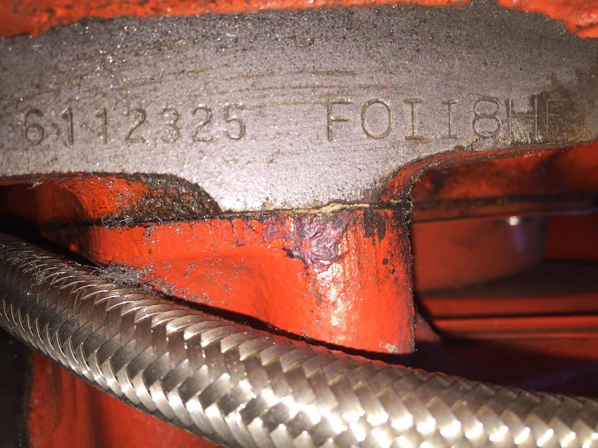

Here are some photos from the net of HE and they look normal.
I wonder if it was a light strike and someone thought it was a good idea to enhance it????

The "E" on that pad is much larger than the other stamps. Unless there was additional legitimate documentation on that car, I'm not buying it. GM wouldn't purchase different sizes of stamps for that SB pad. Different fonts? Maybe. Different sizes for a specific stamping? Never. I believe the "HE" was altered or possibly some dolt thought it should show the letters better and put some of his own stamps over it.
If someone could show me very similar photos of SB pads on cars built just before or just after this one, I'd change my mind. Otherwise, no....

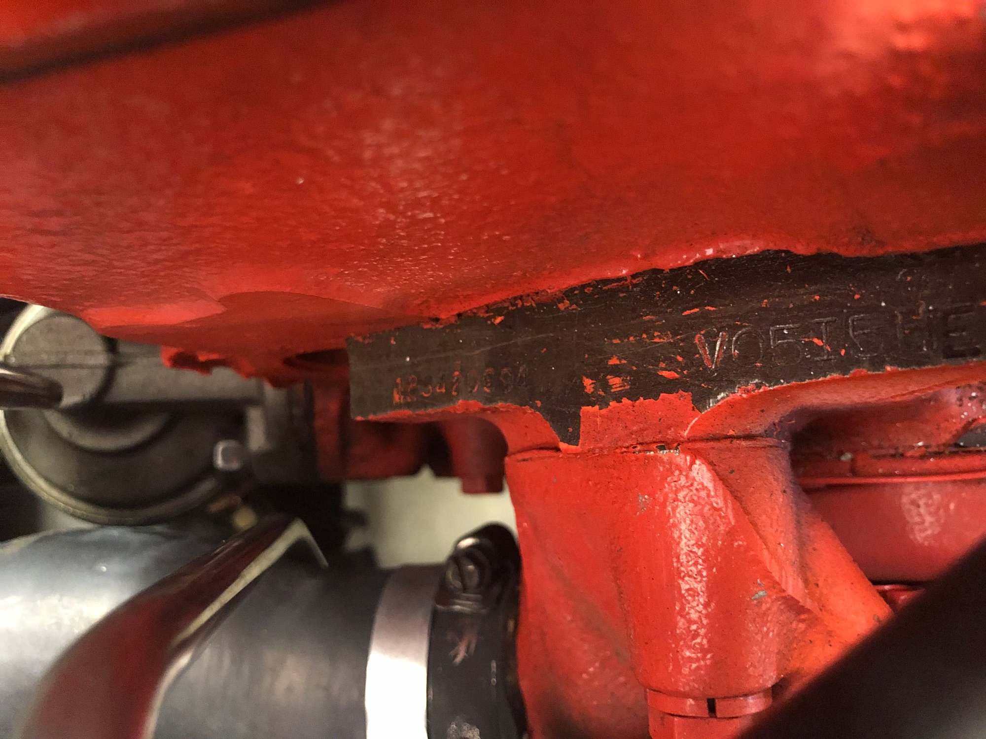

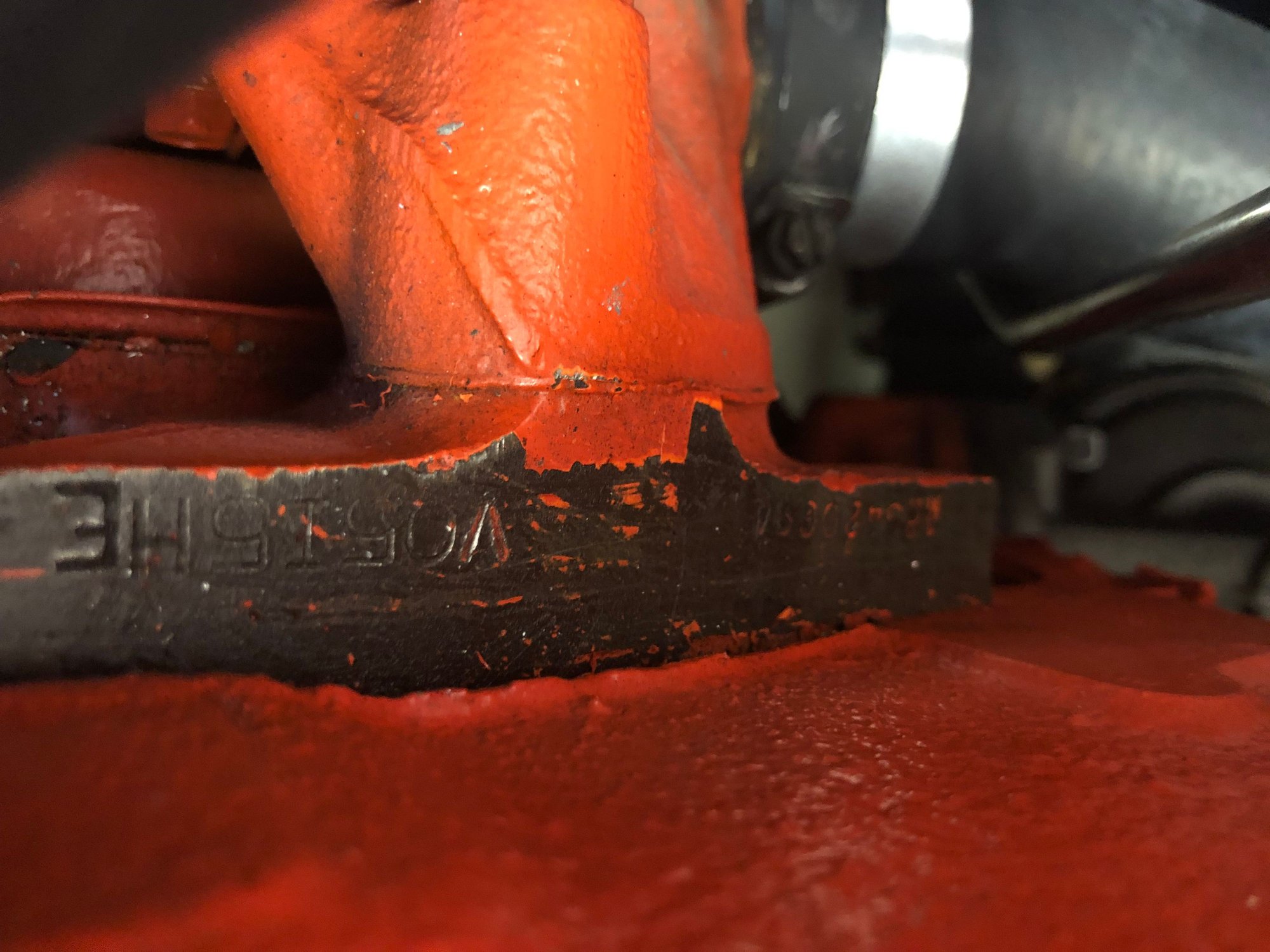

i have 2 68s, and while neither is an HE, they look nothing like the original one posted. it almost looks like someone tried to redo the "H" "E" and even the "V"

Tiger Joe I didn’t notice the V. I was to busy looking at the H and E. It’s very bad angle to gauge these markings
