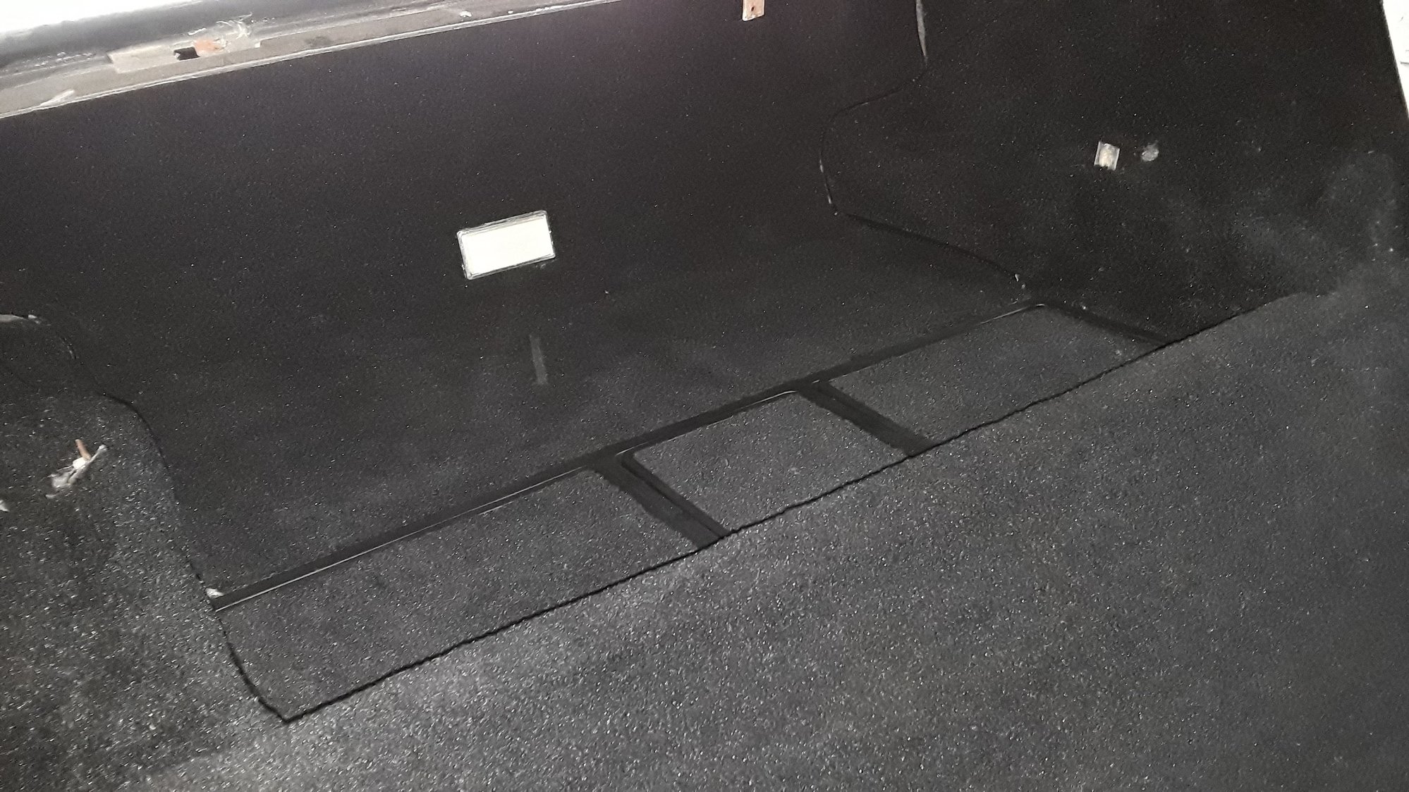

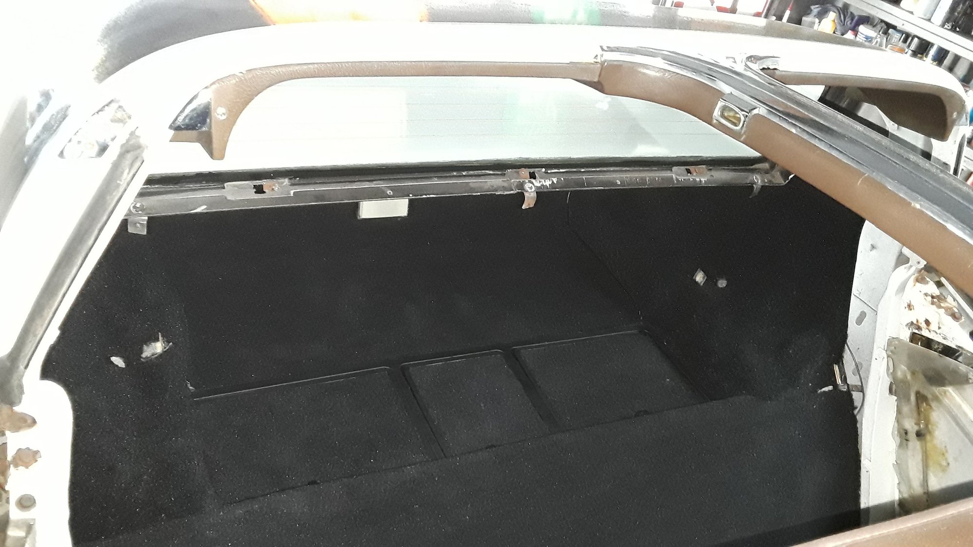

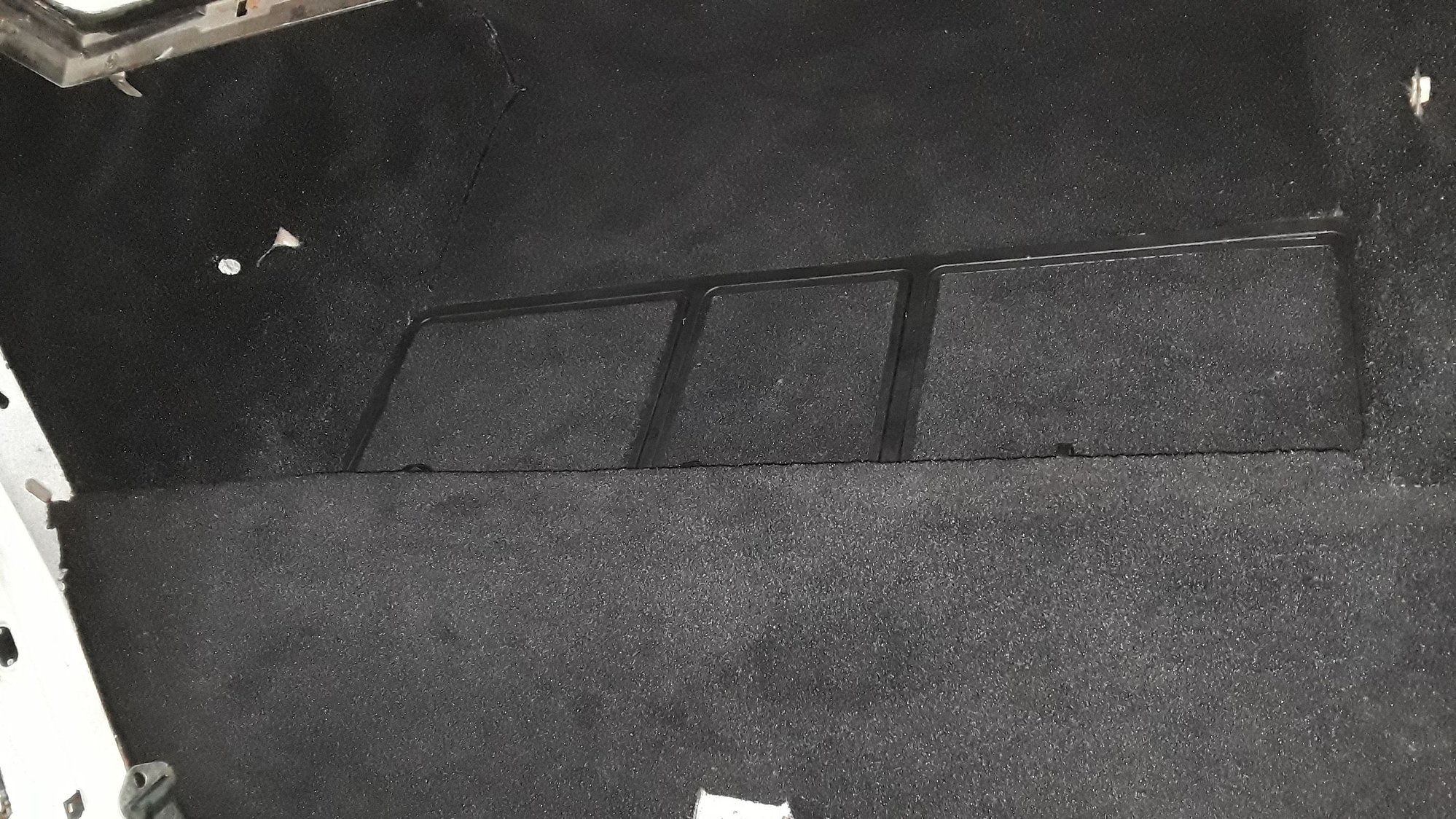

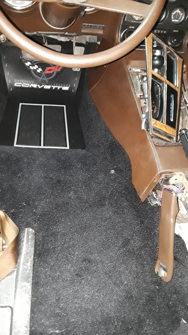

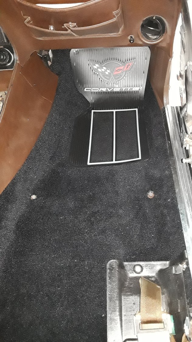

After procrastinating finally installed the rug today
Go easy on me ...never installed a carpet before

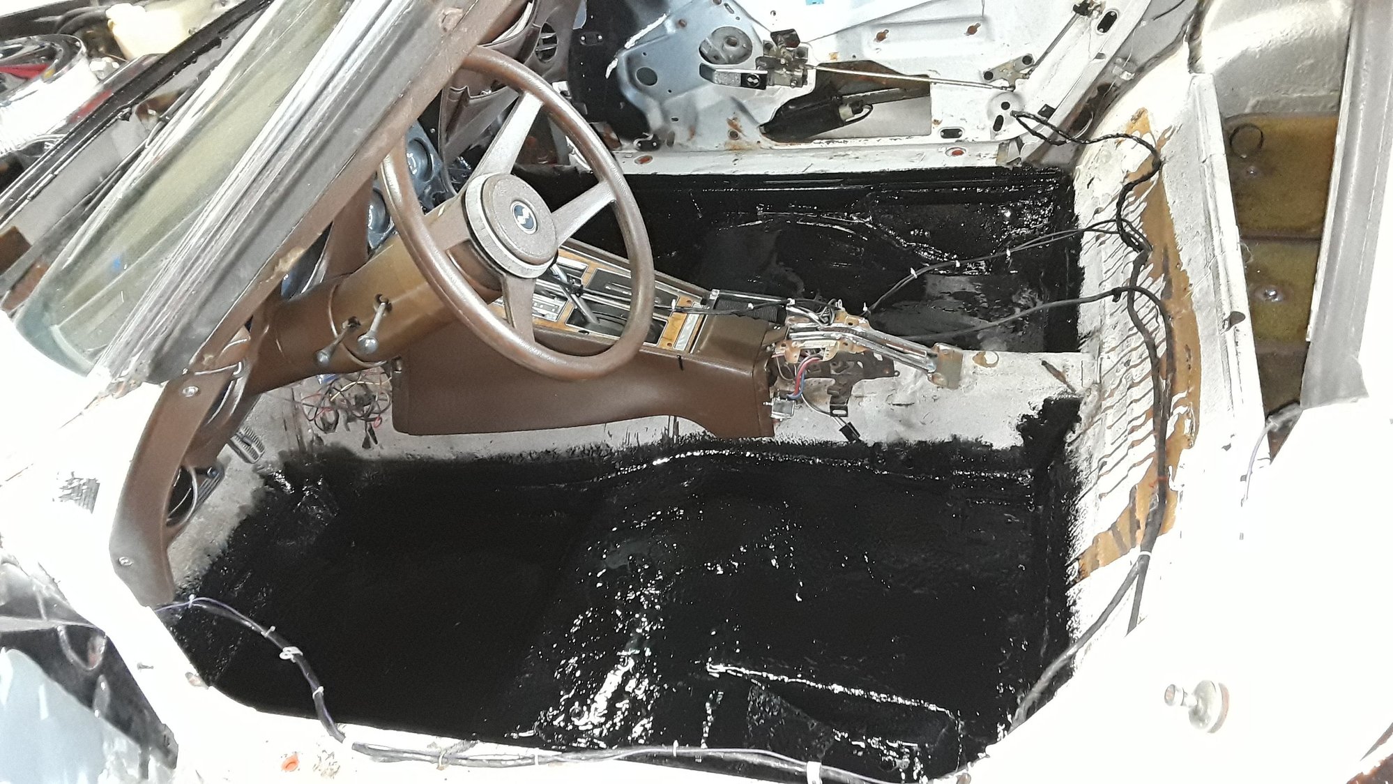

I paid to have mine installed, and my car is a little different than yours because it metal floor pans.
Having said that, I am not sure this would help in your case, but one thing the guy did to mine is install heat / sound insulation when he did the carpet. It helps with road noise.

Nice work brother. You did very well.

Thank you pain in the *** ..lots of patients...but came out better than I thought it would ...lots of reading and pics ....and picking the brains of the people that have been their.....again thanks man
