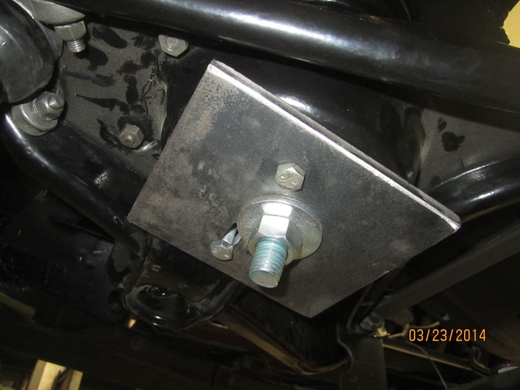

This is the view from the top with the threaded rod method.

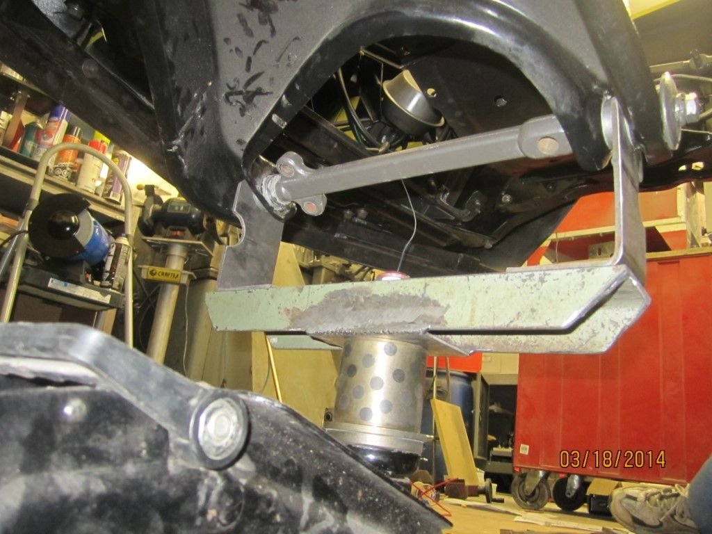

Just to complicate the issue
Leave the balljoint connected and remove the arm from the frame.....
But without the engine, it doesn't work (not enough weight, just lifts the car)
Plate under the a-arm with threaded rod
All that said, I've also done them with a hook style compressor, remove one set of the hooks and thread it through the shock mount hole
M
