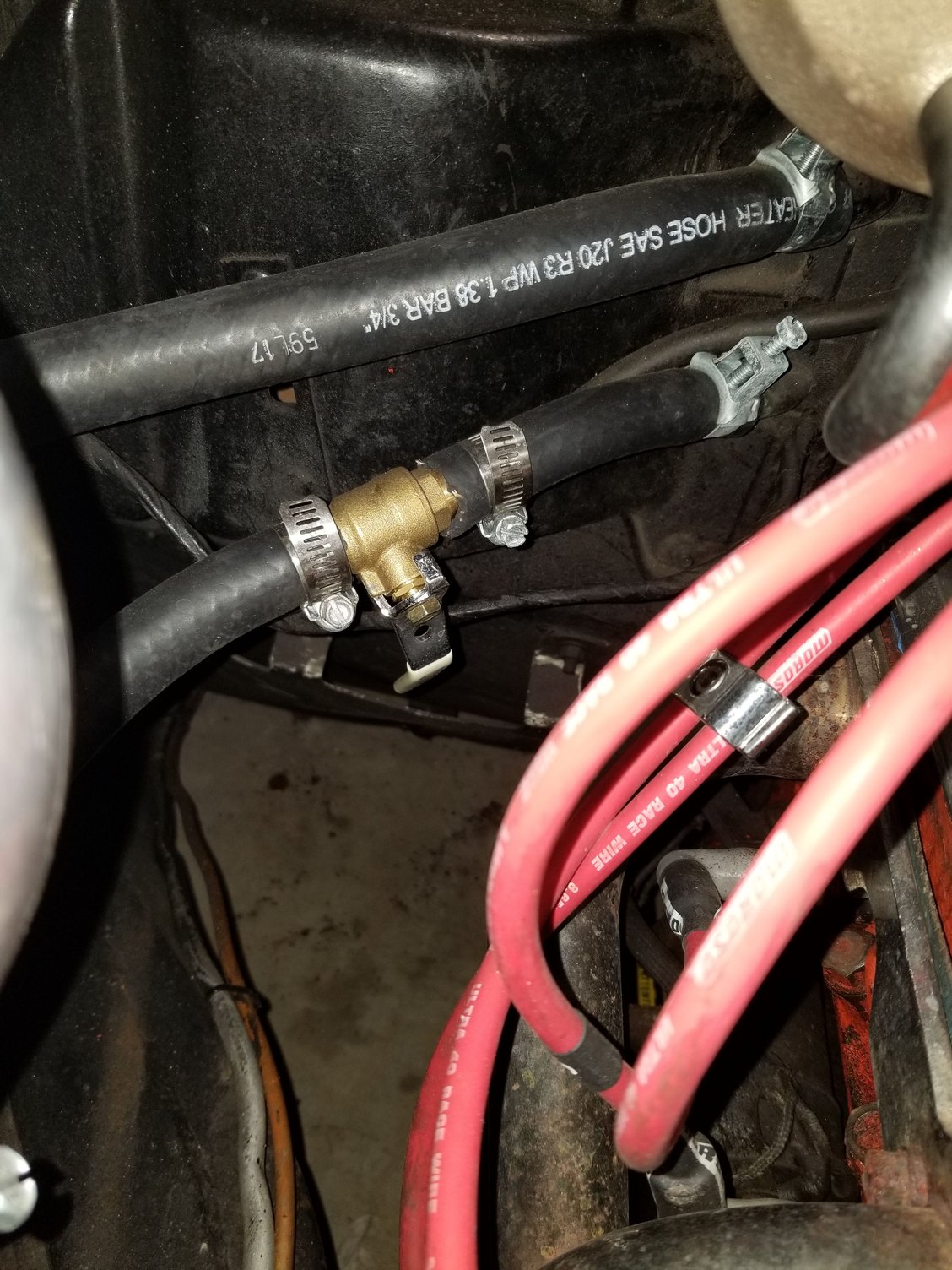

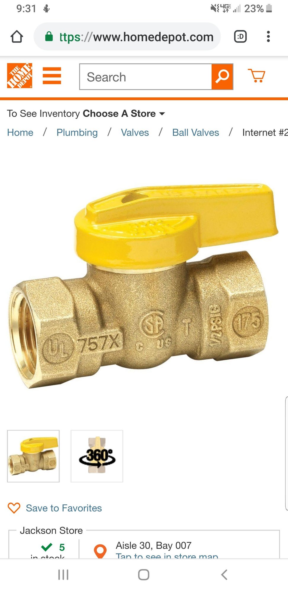

RedVette72:
Here are the pictures of what I've got currently.
Works well in the summer, preventing the hot water from flowing to the core, keeping the interior cooler. And I turn it to open in the fall and spring to keep me toasty.
What I would have preferred, was the kind shown from the home depot ad, with the **** handle instead of the large lever. But I think those are intended for gas shut offs not water.
Good luck!

Here is a picture of the similar setup in my 1973 L82. I removed the green lever style handles and turn the valves with pliers. I put the nut back on the stem to keep things in place.
Fran
Fran
Looks good!
But i might offer that the 2 valves are somewhat redundant. If you cutoff the inlet flow, nothing will be needed to stop the outlet flow. And I don't think there's any risk of backflow.
