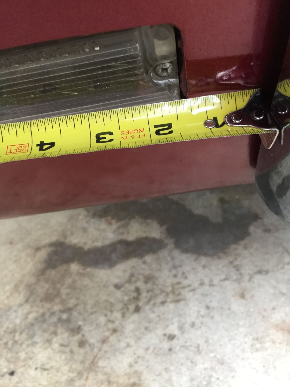

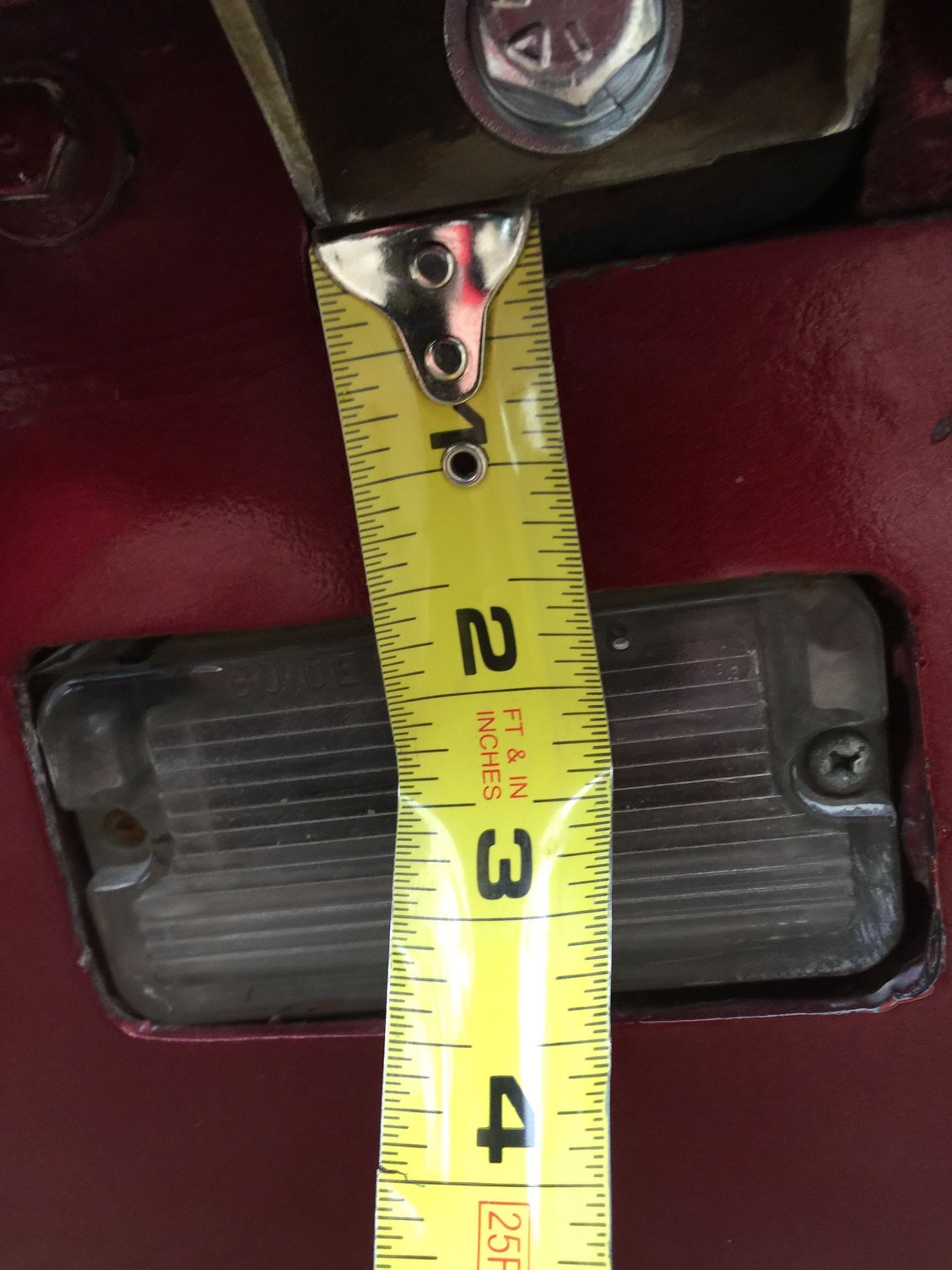

Can anyone provide me with the precise location of the 1968 reverse lights relative to the rear bumpers? See measurements A and B on the attached picture.
I'm converting my '72 reverse lights to the '68 style and need to know the precise location for the reverse light assembly cutout. Thanks!

Ran out and took these. Both sides were about the same.

Thank you Boomer880, very much appreciated!!

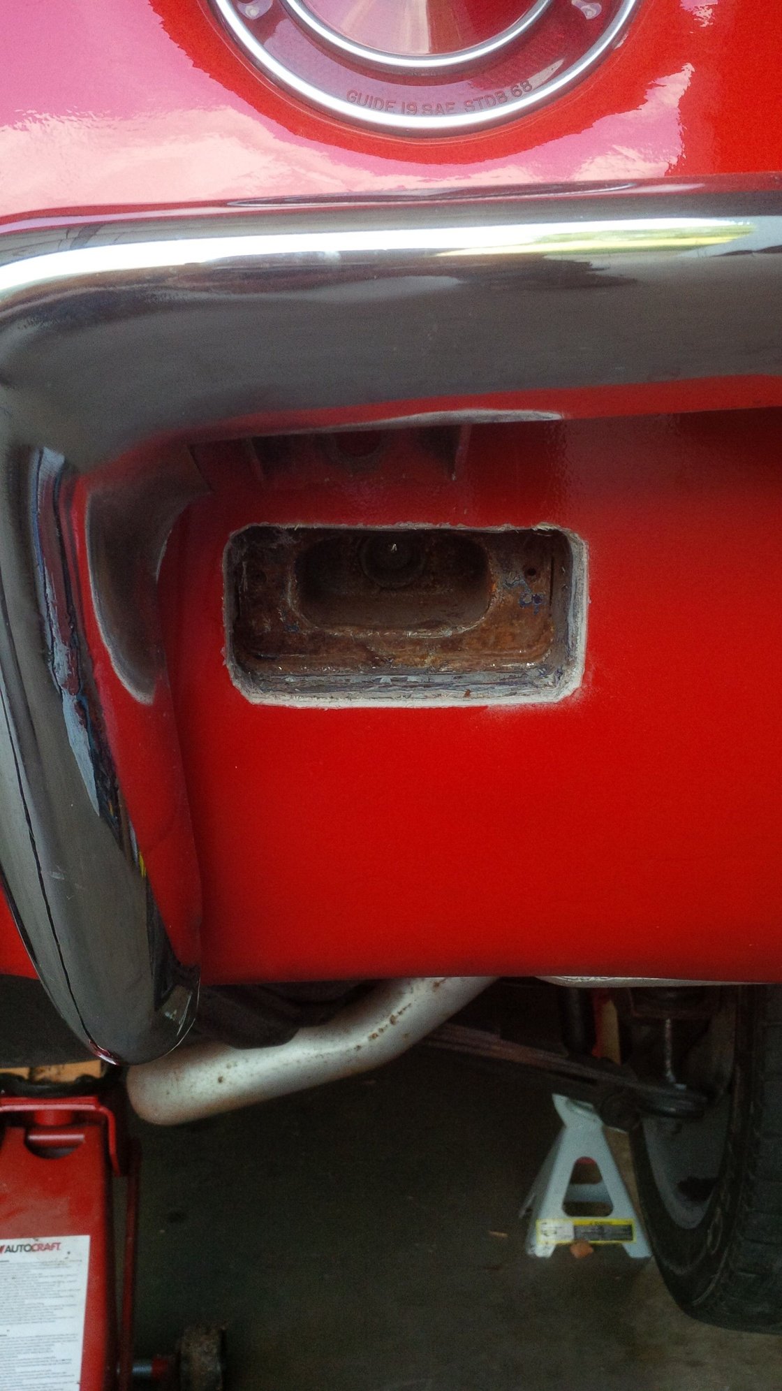

Good pic of location and what back side of hole looks like.

Good pic of locatiokn and what back side of hole looks like.
you da man!
