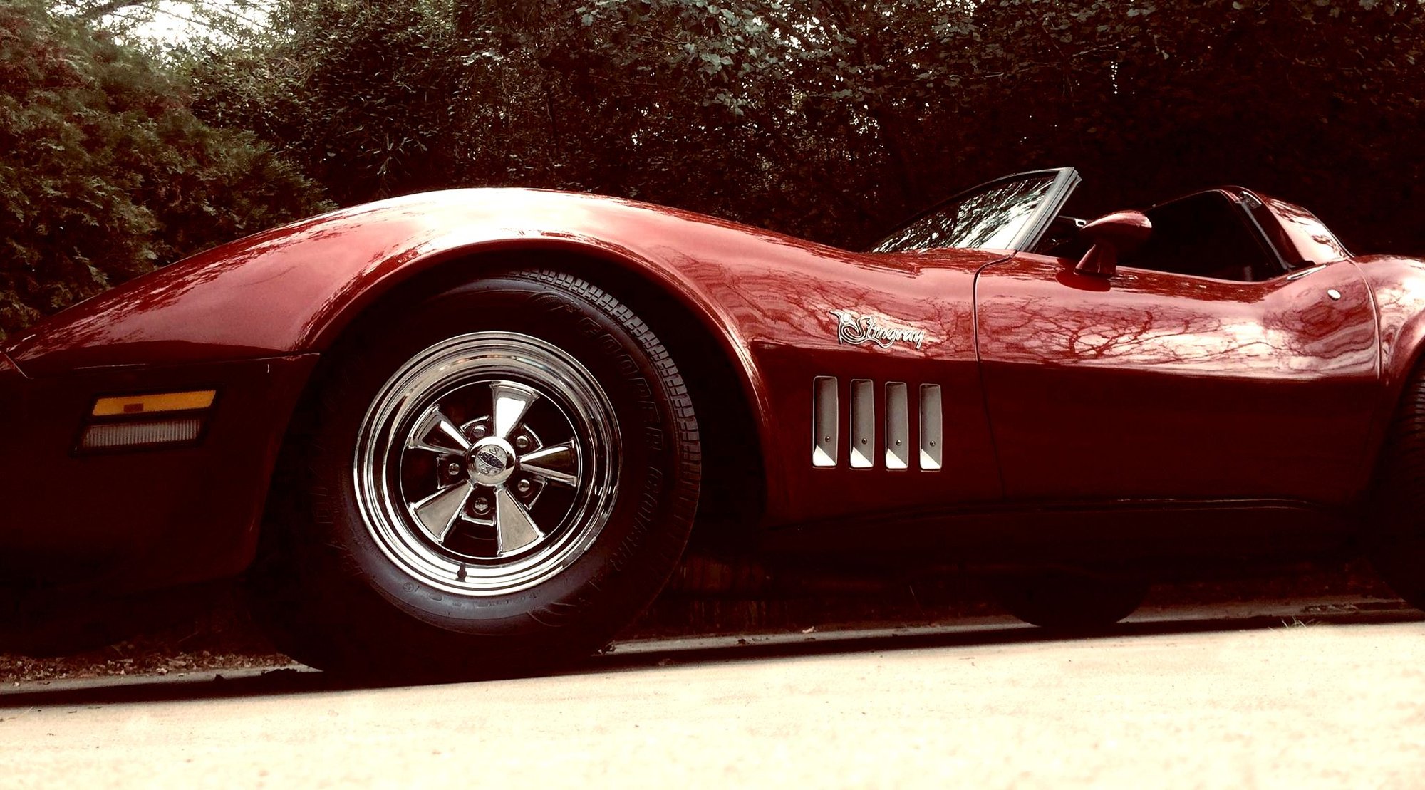

I love ‘em.

Originally Posted by dprinter1
They look great, nice car! How wide are those rims and tires, and are they the same on front and back?
8 inch, same size front and back.

I put the Cragars on the car as an alternative look to the redlines and rallys a couple years ago, just for a change of pace.
I like the look so much I can’t take them off!
