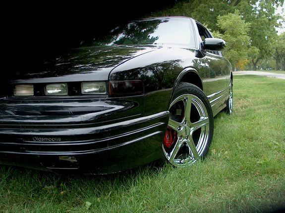

Yeah - we talked on Facebook. I'm thinking yours may have came from something like a 94-97 Olds Cutlass, like these, possibly? I haven't looked up their dimensions yet....
