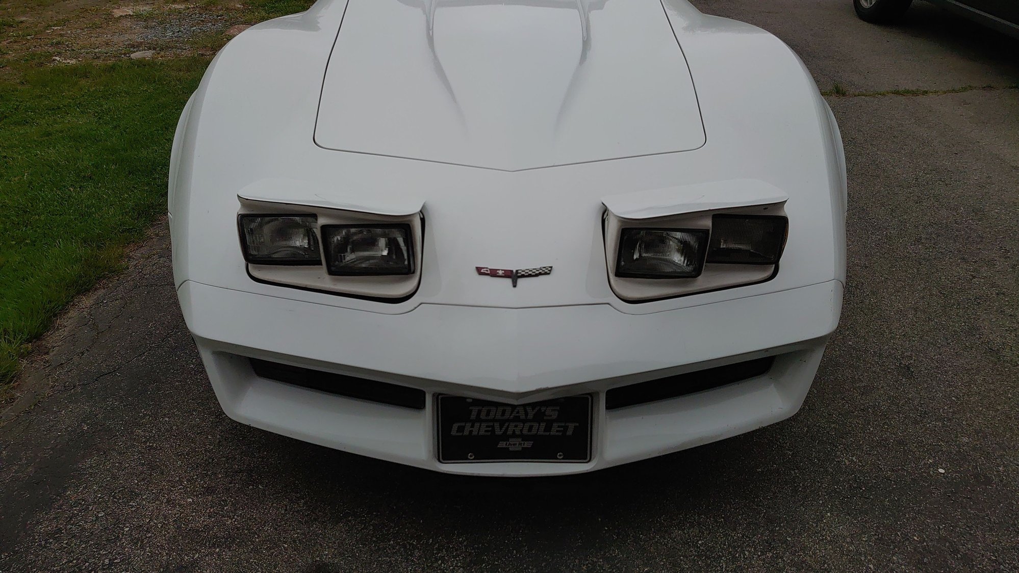

Just wanted to show off how it went, many thanks to Go Vette Go for the bezels, I did the rest.
I'm doing this install now. How big did you have to enlarge the holes behind the lights to fit the new buckets? I have a 2.5" hole saw but it looks like I might need a 3" also in the directions it looks like it only needs to go about 2 1/4" but maybe my buckets are different
Edit: i figured it out, I had to cut my buckets down. I found some pictures online of what they should look like.
If you can show any pictures of your install it would be great, there's a lot more work involved than I thought. I'm also having an issue with the adjuster spring, wee you able to use the original spring, or did you use a different one?

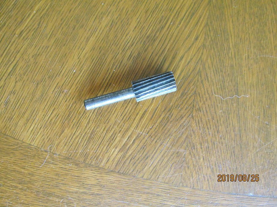

I used a rasp bit in my grinder - drill worked fine but got hot.It ate that aluminum up easily. I tested and ground some, tested and ground the holes to fit where they needed it.
The headlights almost seemed a little loose, but the bezels hold them nice and tight.
Careful grinding the bezels to fit, a little at a time and test fit! Worth it in the end.

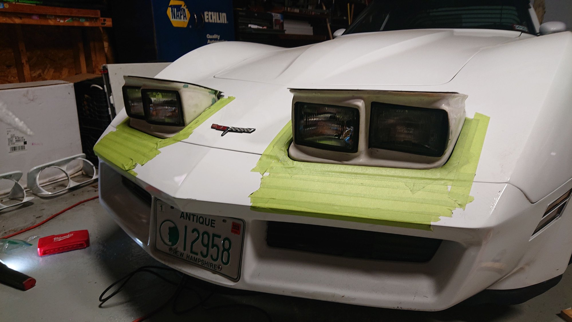

I started on the right side tonight, got the tabs cut and ground down and cut the holes out. It will be way easy to cut out the backs of the buckets at work tomorrow, so I'll do that and probably finish up tomorrow night. I still can't get that left side bezel to stop hitting the body, it almost seems like it's bowed out too much.
See how bad it is in this first picture?

I got both sides installed tonight.
Both bezels hit on the outside edge when I try to manually close the lights. I'm not sure how to correct this without fiberglass work to the bezels.
The lights themselves don't seem to sit as well as the other setups I've seen on here. I know the newer headlight assemblies are different compared to the older c3s, not sure if the kit was designed to work with the stock '81 assemblies, they just don't seem right.
At least I can drive with the bezels off for now, so I can go to the car shows this weekend, and figure out the bezel issue later

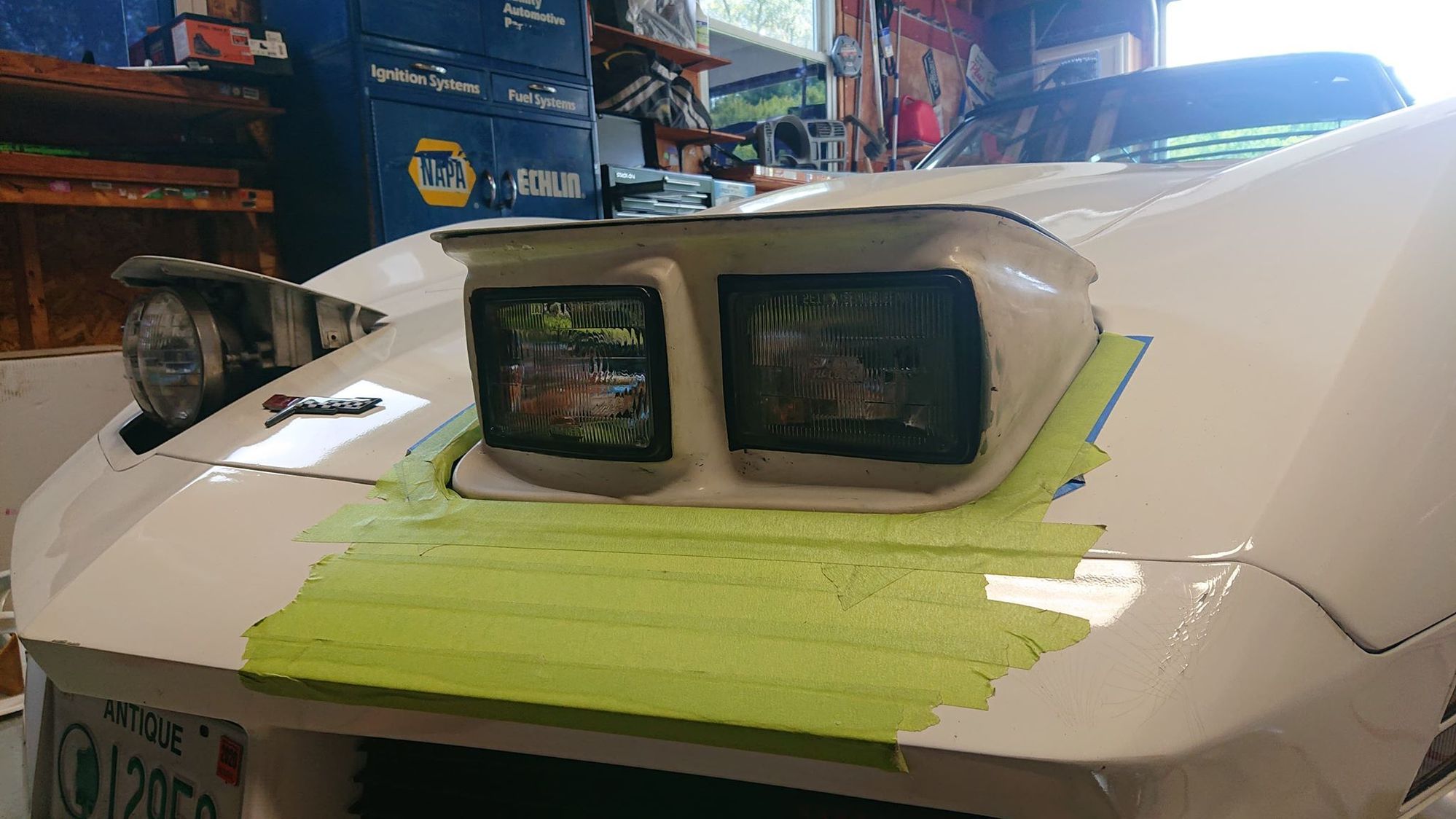

I got them aimed tonight, they will work for now, although they look really funny without the bezels.
Also, it seems, there's two types of bezels, plastic and fiberglass. Looks like the plastic ones might fit better?

I used your pics to show you some things that should work - I had to do these to mine. My bezels are plastic, if that matters I don't know.

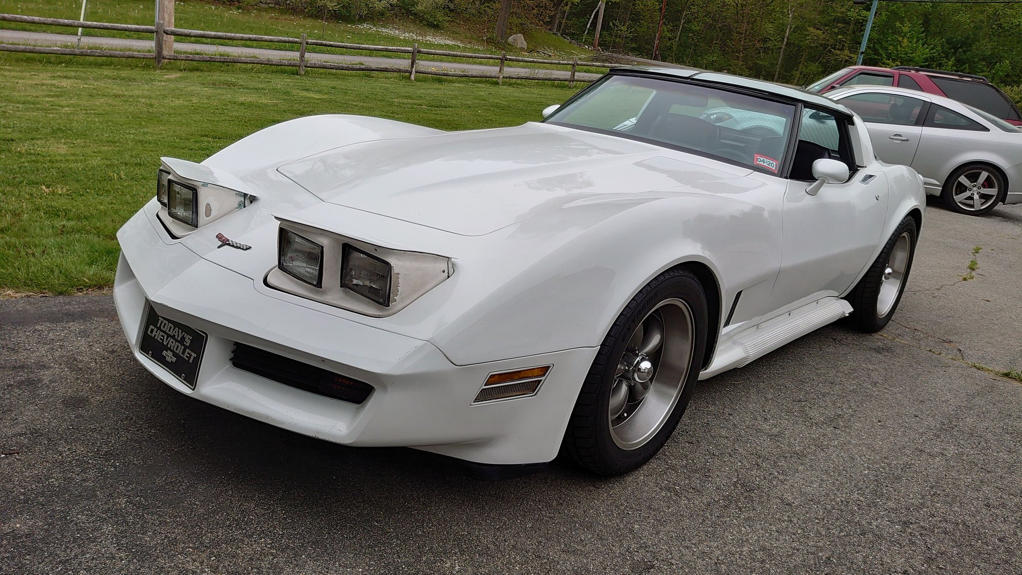

Was finally able to get around to fitting my bezels. I had to tweak the outer lights a little thanks to Picasso's tips, and do a little grinding on the headlights
Hopefully have them painted by end of this week
Large gap between the bezel and header though compared to OEM
