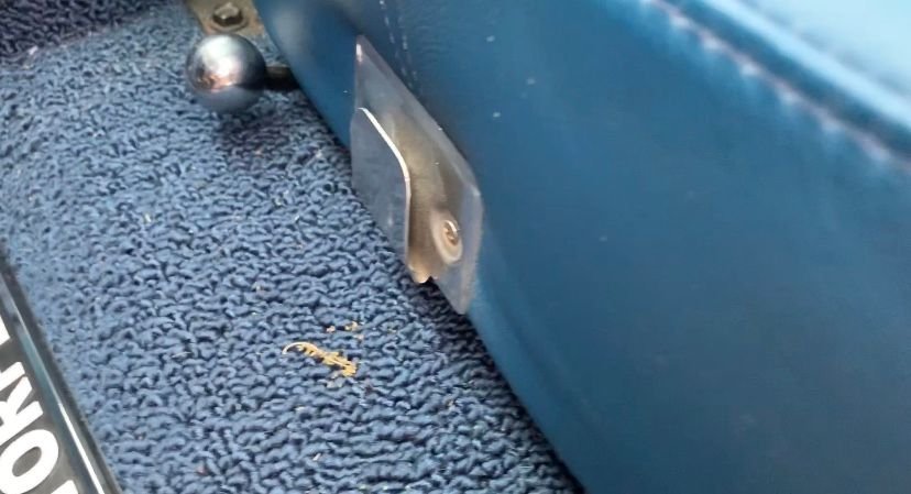

Just noticed in one of the videos they sent me of my 71 an odd clip on the drivers side seat... Any ideas?
Old May 5, 2019 | 04:51 AM
Mooser's Avatar
Mooser
Joined: Apr 2011
Posts: 11,183
Likes: 3,335
Male part of seat belt clips there to keep it from flying around

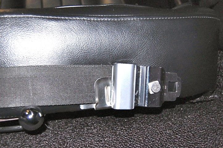

https://www.corvetteforum.com/forums...elt-clips.html

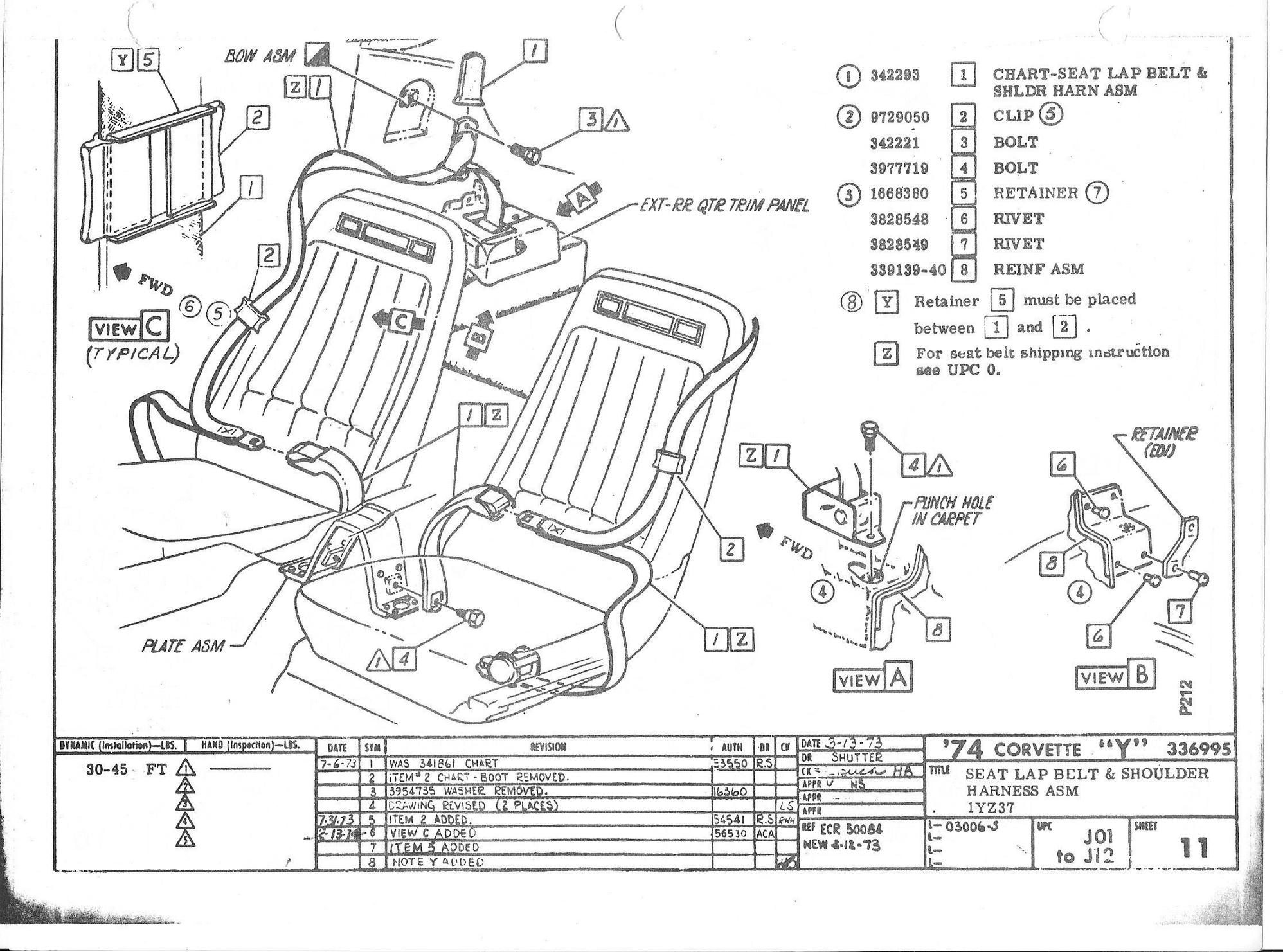

Here's the way the factory did it.
The '93 to '02 rear Camaro / Firebird belts have everything you need for your coupe except for one part not shown under #1 in the coupe drawing.
To Mistery Clip
