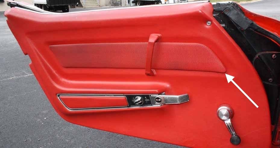

The 69 panels have the " Comfortweave" insert as a separate add- on piece. See first pic below. The 70 and later standard interior door panels have the "Comfortweave" pattern molded in the panel. See second pic below.
Hope this helps
