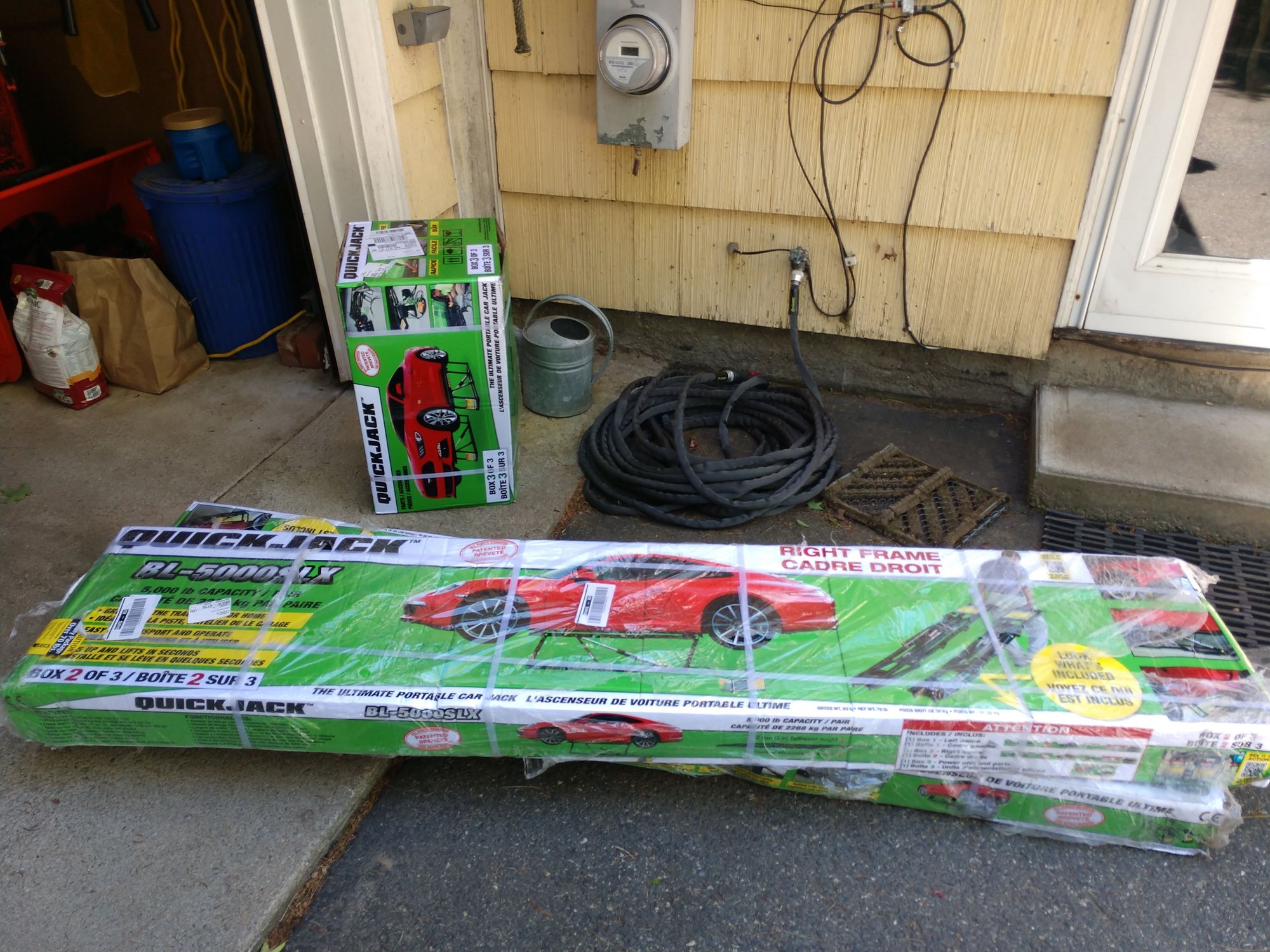

Paying for the installation of a garage-door opener for one's child does have its benefits.
(Wanted to do it entirely in secret, but there were complications, so she knew in advance.)

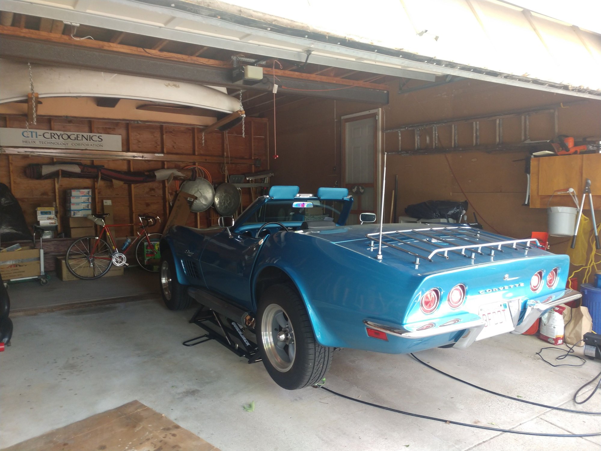

Up, Up, and AWAY!
A bit of messing to get things lined up, next time will be quicker.
I did some no-load test runs (only up a little), and had two minor leaks. Unfortunately the actual lift was a bit more draining. I used sealant on the connections, thought that I had them sufficiently tight...
