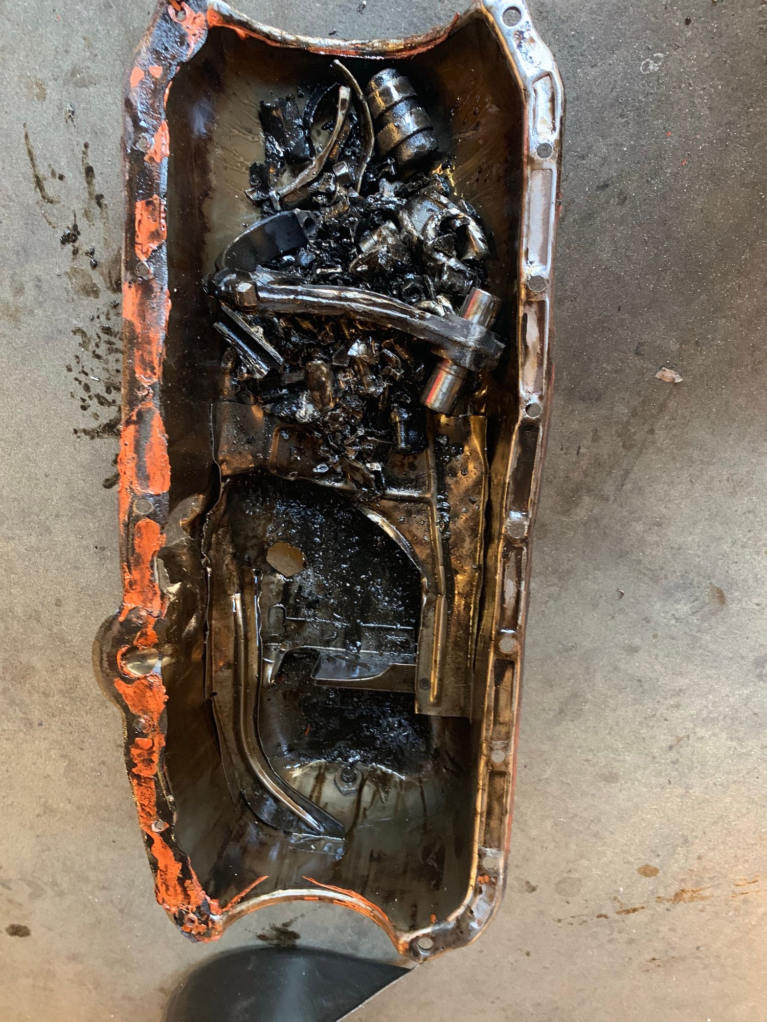

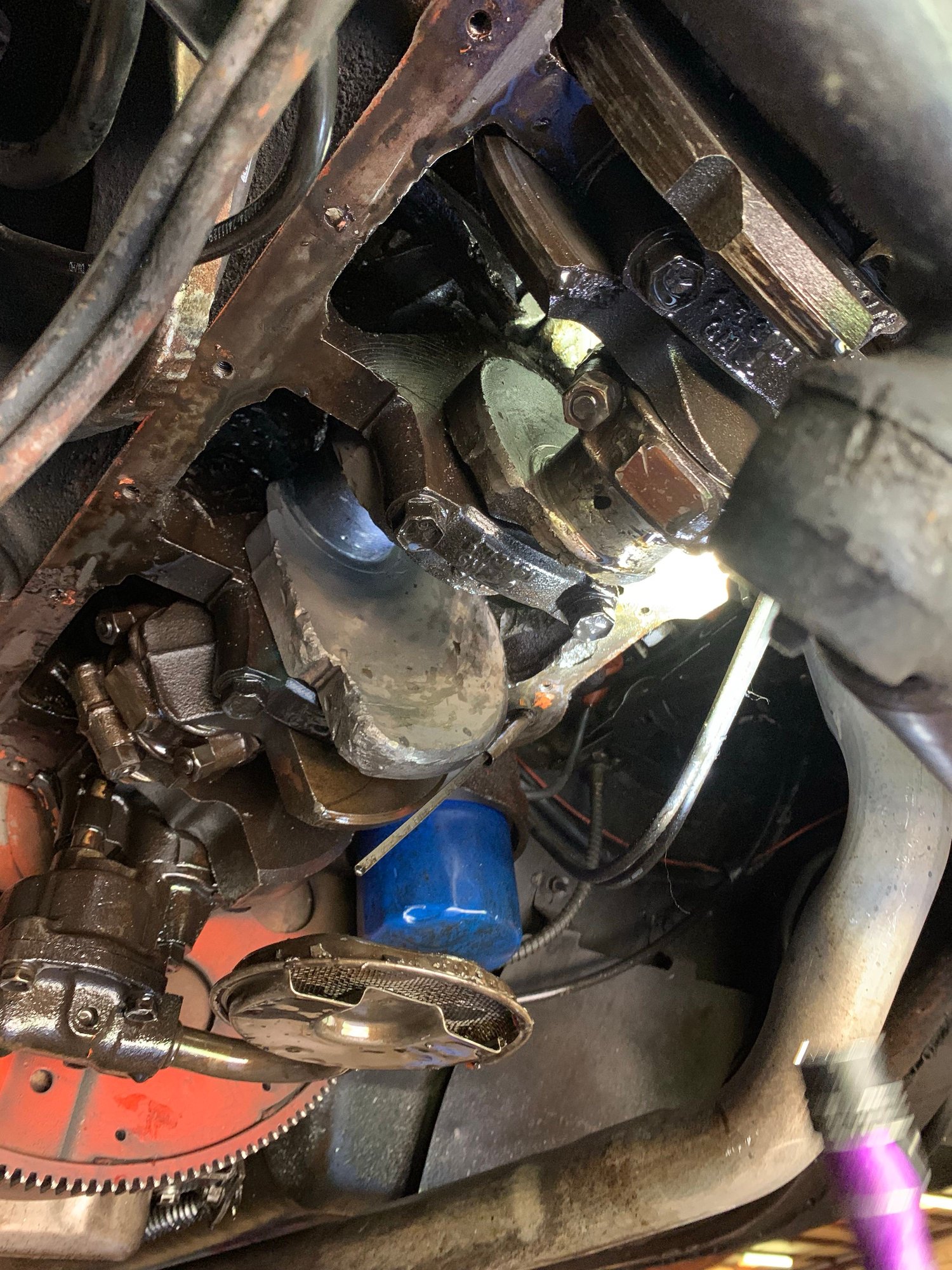

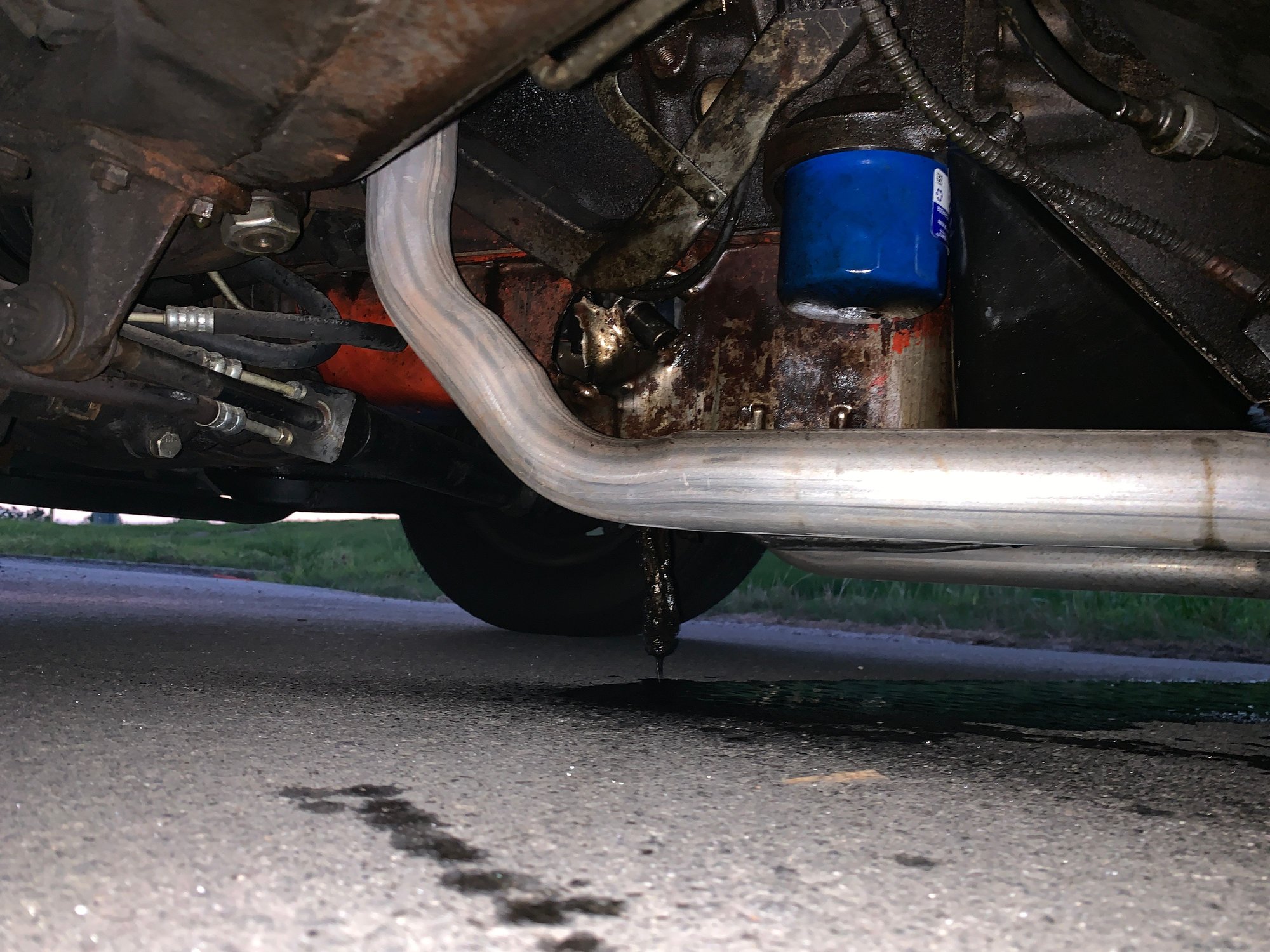

Blew the motor on my '72 the other night. Noticed a tick on startup recently, thought little of it. Friday night, on the interstate the engine decided it was done, and threw a rod.

Wow! Those are some impressive pictures! What do you think was the cause of it all? Little to no oil pressure?
Low oil pressure. I saw the gauge was low and thought it was a bad gauge like an idiot...

Certainly some metal in that sump. Good to see your making the best of the situation with a crate motor. Will be back on teh road soon.

Block is very much cracked and would need full machining on the inside if salvageable at all. Gonna keep it, but make some furniture outta it. Now I'm just exploring my options for crate motors.
