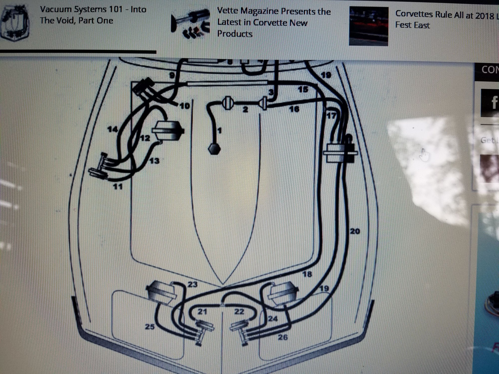

Hey there's anybody familiar with vacuum leak with possible headlight switch problem my headlights light up but they don't open up in the actuators look pretty new in the hoses look okay I was wondering if this might be a headlight switch problem
But I also noticed that my motor is running a little rough and when I pull one of the hoses out near the intake manifold and put my finger on it the motor Smooths out so I'm not sure?

Can you say vacuum leak? Good looking hoses leak all the time, get a vacuum gauge and check each hose for leaks. Don't stop with the 1st leak either, check all your hoses and devices.

http://www.corvette-101.com/vacuum.htm

What year is your car? Do you have the pull down switch located just under the steering column. Pulling that down should pop the headlights up (an emergency system in case of loss of vacuum).
No since buying anything until you know what the problem is, but new vacuum hoses on a 40 yr old car can't really be that bad of an investment if they are originals. But, these cars can get real expensive doing that.
The vendors are Willcox, Corvette America, Ecklers, Corvette Central, Zip Corvette, MidAmerica Designs, RockAuto, to name a few....

Thanks bro I really appreciate your reply yes I have an 81 and you're right I don't have a lot of money I replaced a few of them already I replaced all the ones that go to the canister for the evaporation coal charcoal canister now I'm working on the headlights and I bought myself a cheap vacuum hand-held pump going to start figuring out how to use that and start at the manifold entrance into the engine thanks a lot man I appreciate your help!
dan
Also by the way I don't see the override switch underneath the dash under by the headlight switch I don't see it anywhere by the fuse box nothing
gonna have to take the dash apart

A vacuum gauge is an inexpensive and useful tool when troubleshooting headlight problems.
As you test each hose cut off about 1/2" on each end, (for a snug fit) you might find that the hoses are still good.
Many times the seal in the actuators is bad and needs to be replaced.
