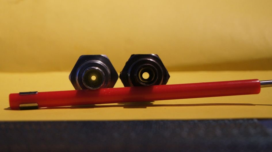

Originally Posted by drwet
I am interested in reducing the pump pressure on my Steeroids setup. It is a little too sensitive. How did you do it?
Read this
https://www.turnone-steering.com/blo...houldnt-be-cut
Reduce the flow first.
Here is the factory vs the flow restrictor I used for my flaming river rack.
