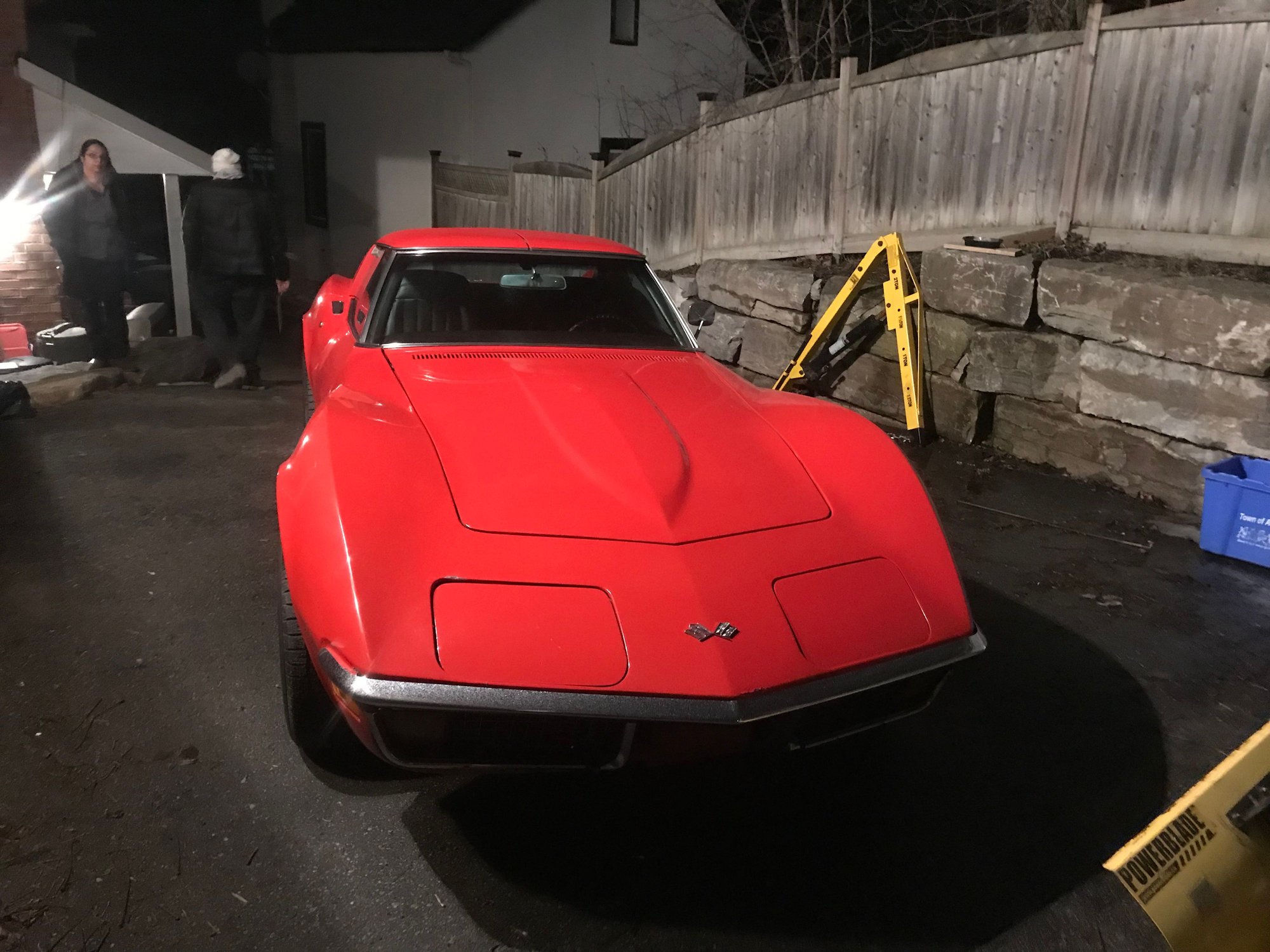

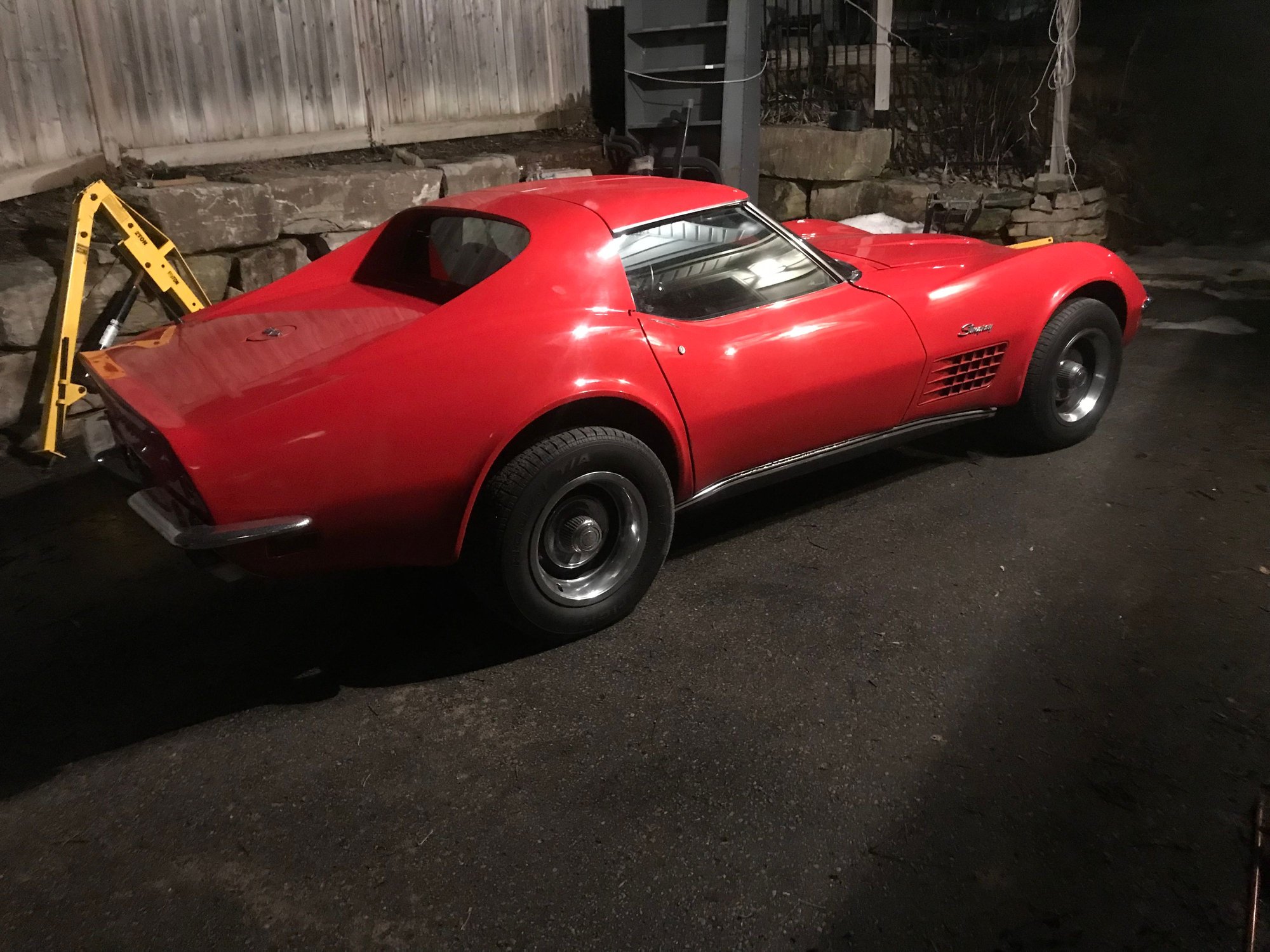

Believe me I know this is going to need a lot of work .
I bought her this way so I can make it my own .
Slowly doing some of the work myself which I am able to , and I have a somewhat retired mechanic that enjoys working on the old classic cars in his garage he has a few of his own also a 71.
Slowly slowly and in time
Here are a few pictures of when I first got it and what’s going on now
