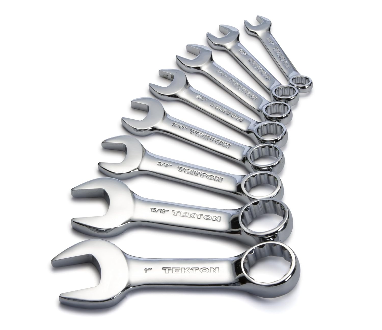

As far as working on C3 Corvettes, one of the best things I ever got was a stubby standard SAE wrench set. The shorter, the better and make sure the combination end of it, is a 12 point.
https://www.amazon.com/TEKTON-1918-Stubby-Combination-8-Piece/dp/B000NPT5QC/ref=sr_1_1?keywords=Tekton+1918&qid=1560898935&s=gateway&sr=8-1 https://www.amazon.com/TEKTON-1918-Stubby-Combination-8-Piece/dp/B000NPT5QC/ref=sr_1_1?keywords=Tekton+1918&qid=1560898935&s=gateway&sr=8-1
https://images-na.ssl-images-amazon....L._SL1500_.jpg
