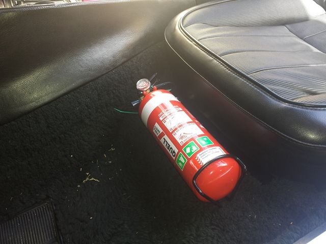

i made a bracket and mounted it in front of the drivers seat in my '72.
riverracer au:
What size extinguisher is that one? Looks like a decent spot to secure one to me! Might have to source some material and get out the MIG.

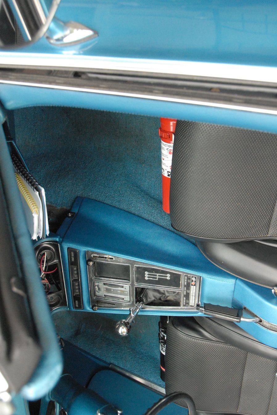

I fabricated an ABS piece and attached it to my Vette Works Sharkbar anti submarine 5 point mount. I have a back up unit in the jack storage compartment. The placement is no bother to my passengers.

Well, not really sideways...
Right (red) Purple K - from local vendor [When all else fails]
Left (black) HalGuard - from Summit Racing [Use first]
Mounts from 'Bracketeer' Simon, the owner, was most helpful with some extra bits to make them fit.
