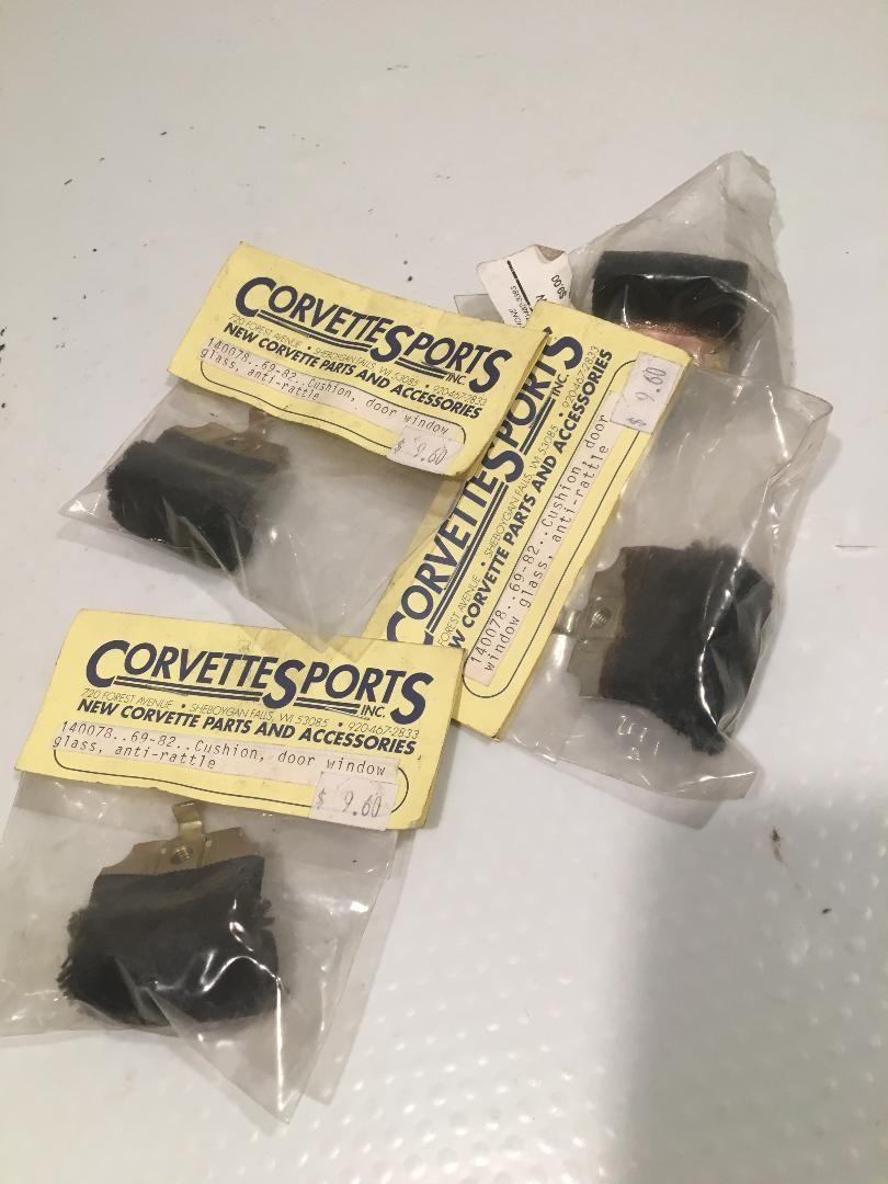

I have these two items but I’m not sure what I’m missing in order to completely change all the window felt/seals etc. I saw a 6 piece kit at Zip but which 4 pieces am I missing.

Maybe the window anti rattle pads
I think those are 69 and up. I have a 68.

is it just the door seal/sweep things that hold the window in place? right now ive removed the old ones because they were all rotten and broken so the car has no seals or felts in the window sill and i can move the glass back and forth with my finger. I dont want it to shatter if i slam the door or something. Any help?

Maybe that is why the '69 has the felt anti-rattle pads....it's an improvement from '68.

As stated earlier, your car should have two anti-rattle cushions on each window that keep the glass from rattling. I checked and they are for 68- 82, cars. I remember the ones I purchased had a note that they used a Metric Wrench. Sorta odd, that your car doesn’t have them, mine were there, only the felt/wipers had worn off. I recall there is a bolt and nut that goes through the top of the door frame. It wasn’t as bad as the wipes that had holes that didn’t align with the old ones.

Do you have a link to the cushions? All the ones I’ve seen are for 69 and up. The little square looking ones.

I looked in the Paragon Catalog, part number is 11509K, did you look in the AIM for 1968 cars?
