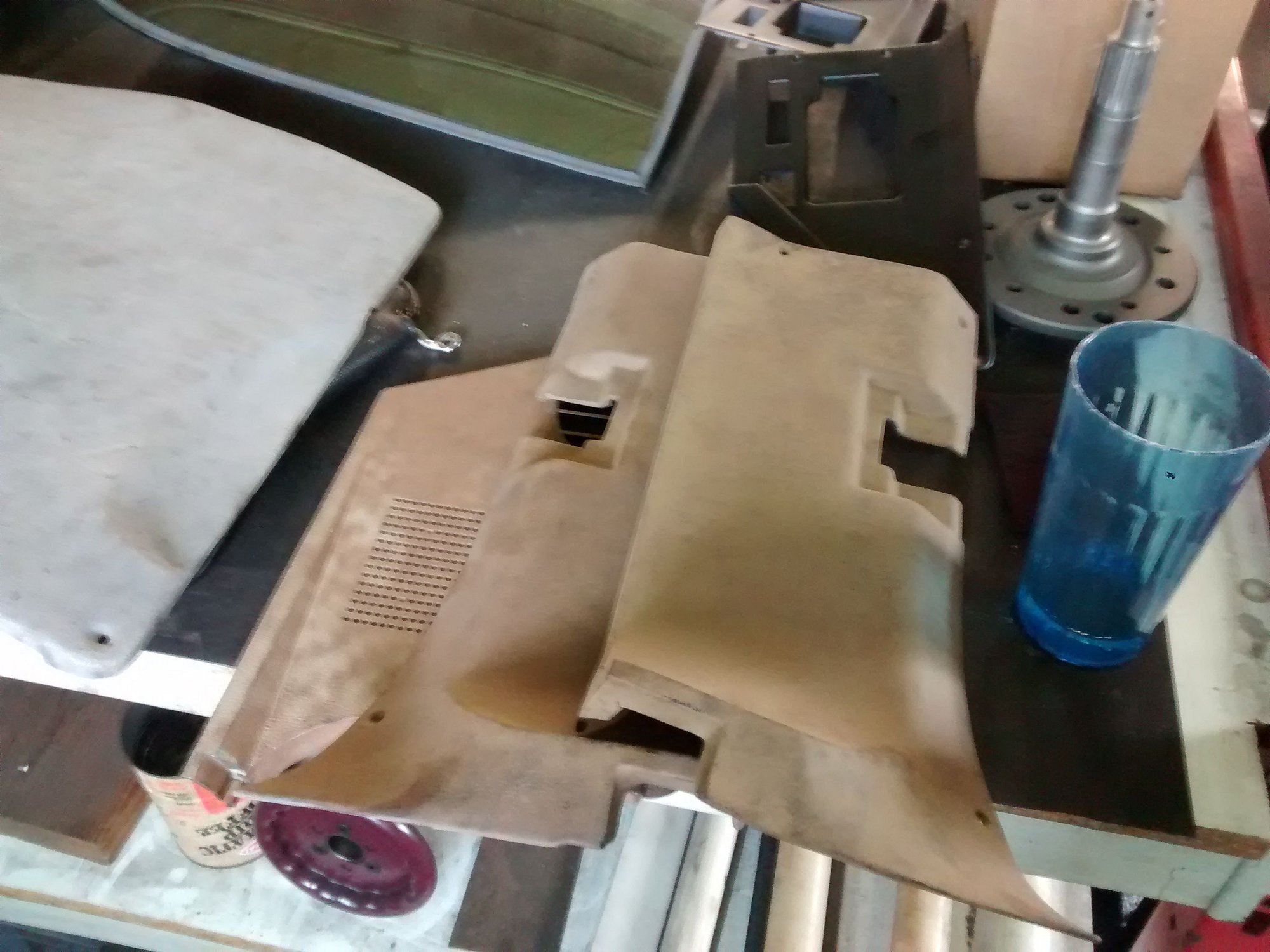

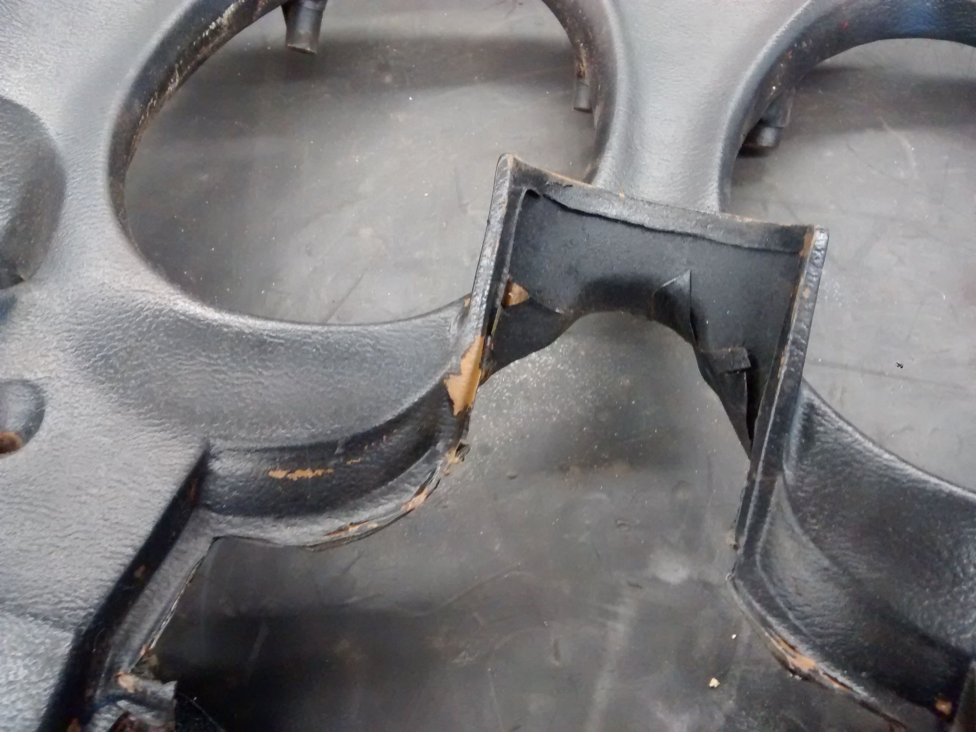

I did four panels today. It's a slow process but it works. We believed it was black spray paint in the beginning because of the wide variety of spots that were flaking. However I now believe it was SEM Dye because it adheared much more strongly than paint does in most places, so the places where it flaked off or were removed easily easily were probably just bad surface preparation. It did take about 4 times as long as removing paint from a typical metal surface, it really did stick very well in most places. It would not just "blow off" except in a couple spots, or the back side. Each small Halo panel took about 45 minutes. The seat back was a different material (fiberglass without vinyl covering) and the SEM did just blow-off of that. Here's my test run after 4 hours of work: I guess I will be able to go back to Dark Saddle after all! Yay!
Typical random flaking due to poor surface prep
Test One fine glass media
Grain close-up
Four panels in 3 1/2 hours without any damage!
