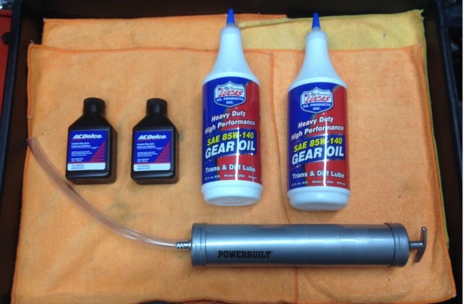

Yes, a suction hose will fit in the fill hole. It does however take some time. Just be patient and get out all that you can.
Refill until it starts flowing out of the fill hole. I followed the advice of the Corvette Forum, Tech Coordinator, Gary Ramadie, and used Lucas 85w/140 with the GM additive.
https://www.corvetteforum.com/forums...post1598005034
(not my photo, borrowed from previous thread)
