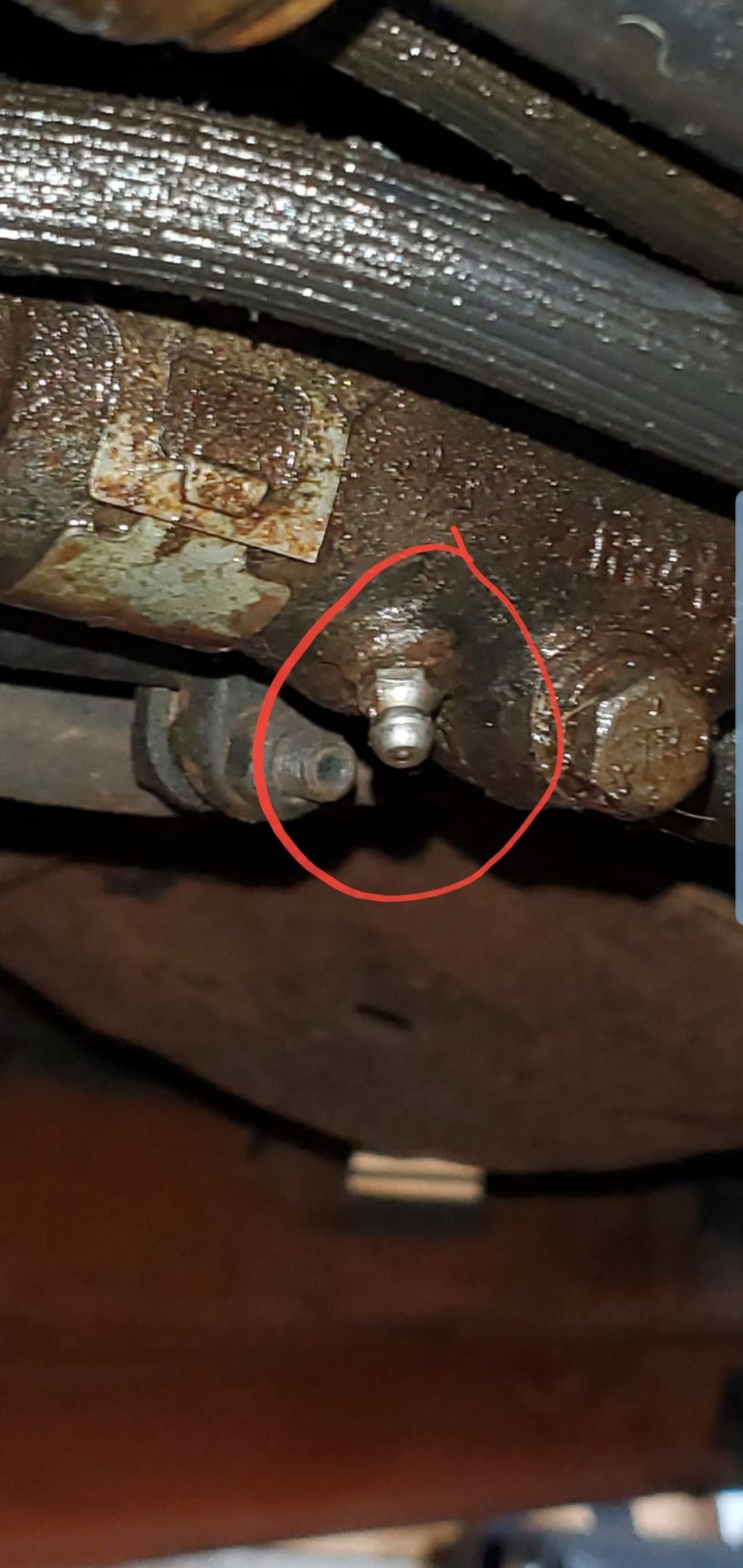

While replacing my power steering fluid and checked the levels I noticed the next day that is it leaking slightly. T
here is about a drop every few minutes coming from this metal piece that I circled in a picture. It is only coming from this area. Any idea what it is? It is behind the driver side front tire about 8 inches back. I know it's the power steering fluid because once I changed it and turned the wheels 20x to get the air out this happened. I checked my AIM but it's hard to decipher what that piece is. I wiped it off for the picture but as time went on and I looked at it again there was a fluid drip hanging so I know that's where it's coming from. Thanks!

That 'metal piece' is a Zerk nipple which SHOULD NOT be used to add grease to the control valve. But, the only reason that drip shows up on that nipple is that is the LOWEST point on that component...so any oil on that piece would drain to that nipple before it fell off. Your leak (or leakS) are coming from above....somewhere. Could be from the P/S hoses or fittings; could be from the valve cover; could be from???? Capture a bit of that oil using a piece of white paper. Look at it to check the color of the oil and also sample the smell. It will either be engine oil, P/S oil, brake fluid, or transmission oil (if you have an automatic trans).
Once you know what oil is leaking, you can search on the associated components for the source of the leak. You need to find the source in order to really fix it permanently. You may have to clean/wash the surfaces off well and dry them in order to find the initiation point of that leak. But, with a bit of effort, you can do it.

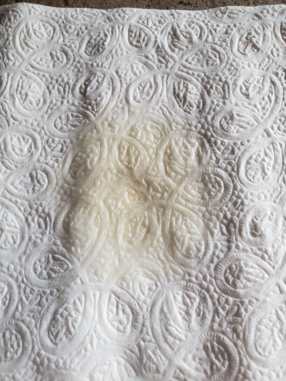

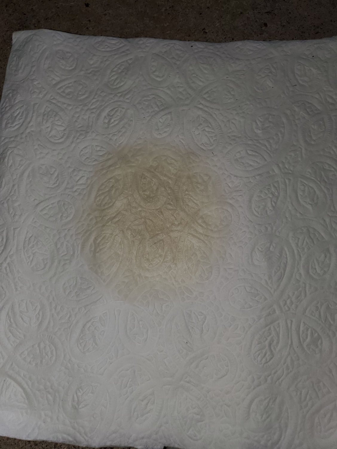

Thank you for your detailed response! I waited a few hours and put some napkins under there and this is what it looked like. It had no smell (from what I can tell) and looks exactly like the power steering fluid I put in recently. I am going to look at my AIM and all associated parts to try and identify the leak and where it came from. I am going to try to dry it all with a shop towel too to try to find the leak.
