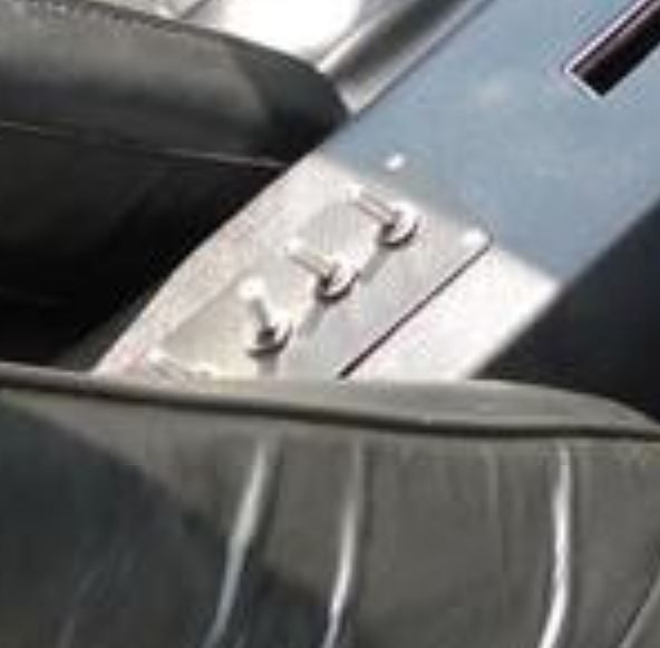

The switches on the console look like two in the off position and one rheostat. 1st though was nitrous but unlikely. Maybe for the HVAC.

As ignatz mentioned, most of the issues pointed out so far seem pretty minor and could be easily resolved at minimal expense. I'd sure want to someone to explain the switches on top of the center console where my elbow belongs!
