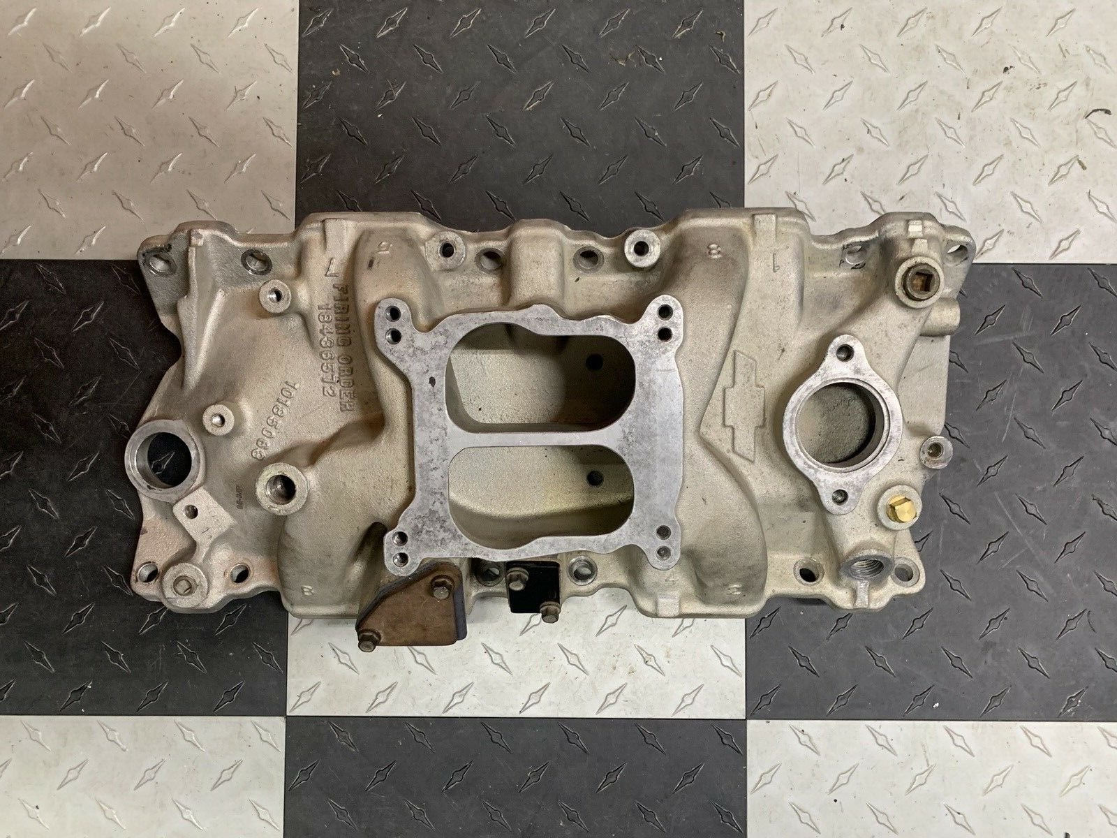

In my haste I forgot the pictures. Here they are with descriptions below them. Thank you. David
L-82 intake I have from a 1978.
Boss area that my iron intake has from my 1974.
The two openings I am speaking of in my post.

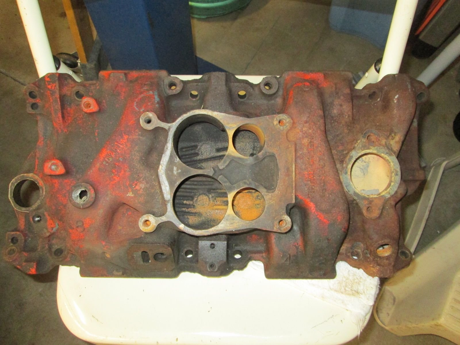

And here is a full picture of my L-48 iron intake from my 1974.

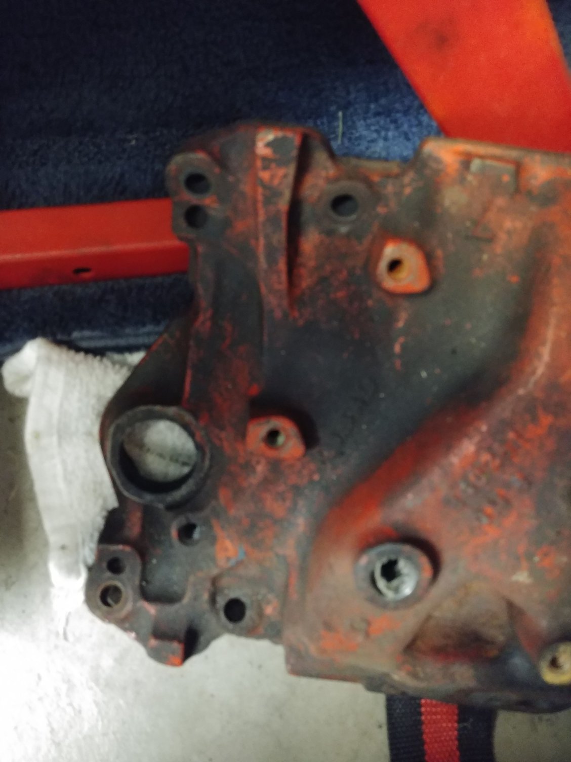

Here are the mounting bosses for the coil bracket.
One day I plan to restore the original L-48 from the car, but not today. I will keep it though as it is the numbers matching engine to my convertible.

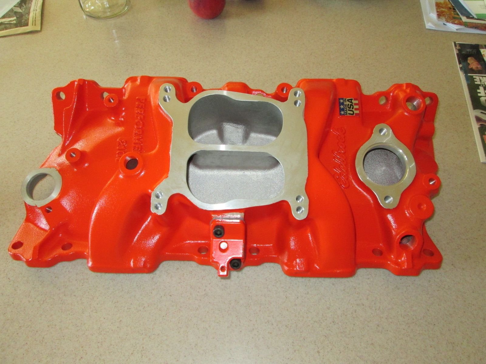

So let me add insult to injury.

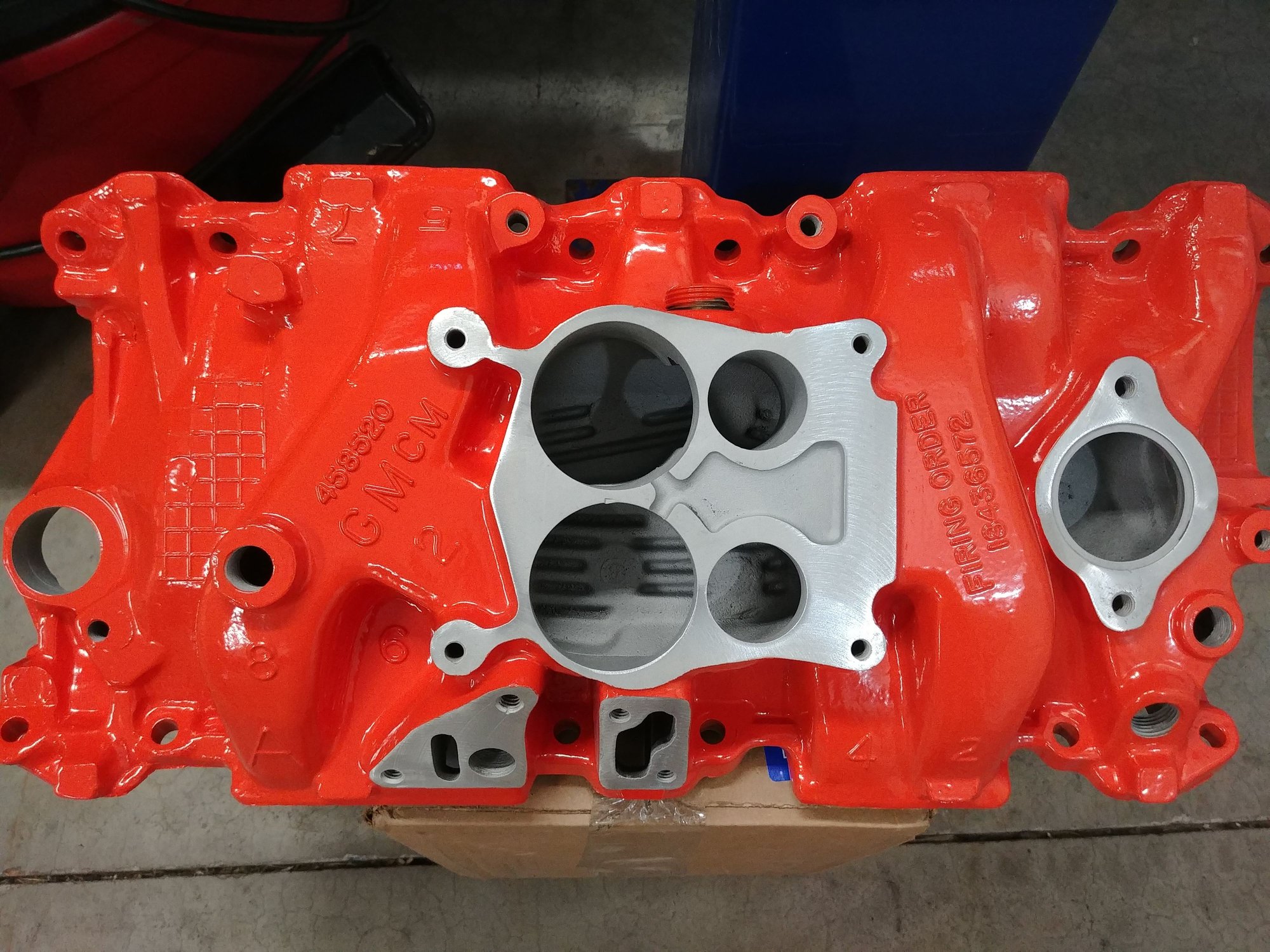

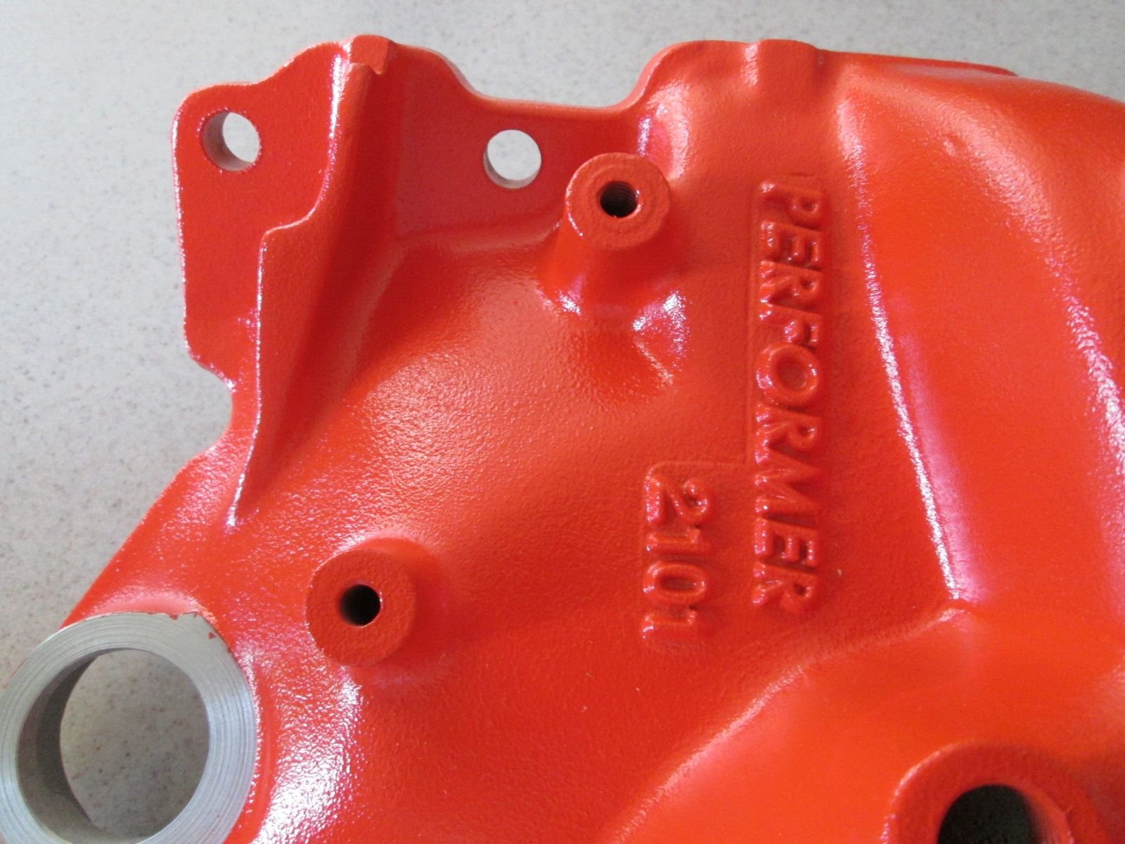

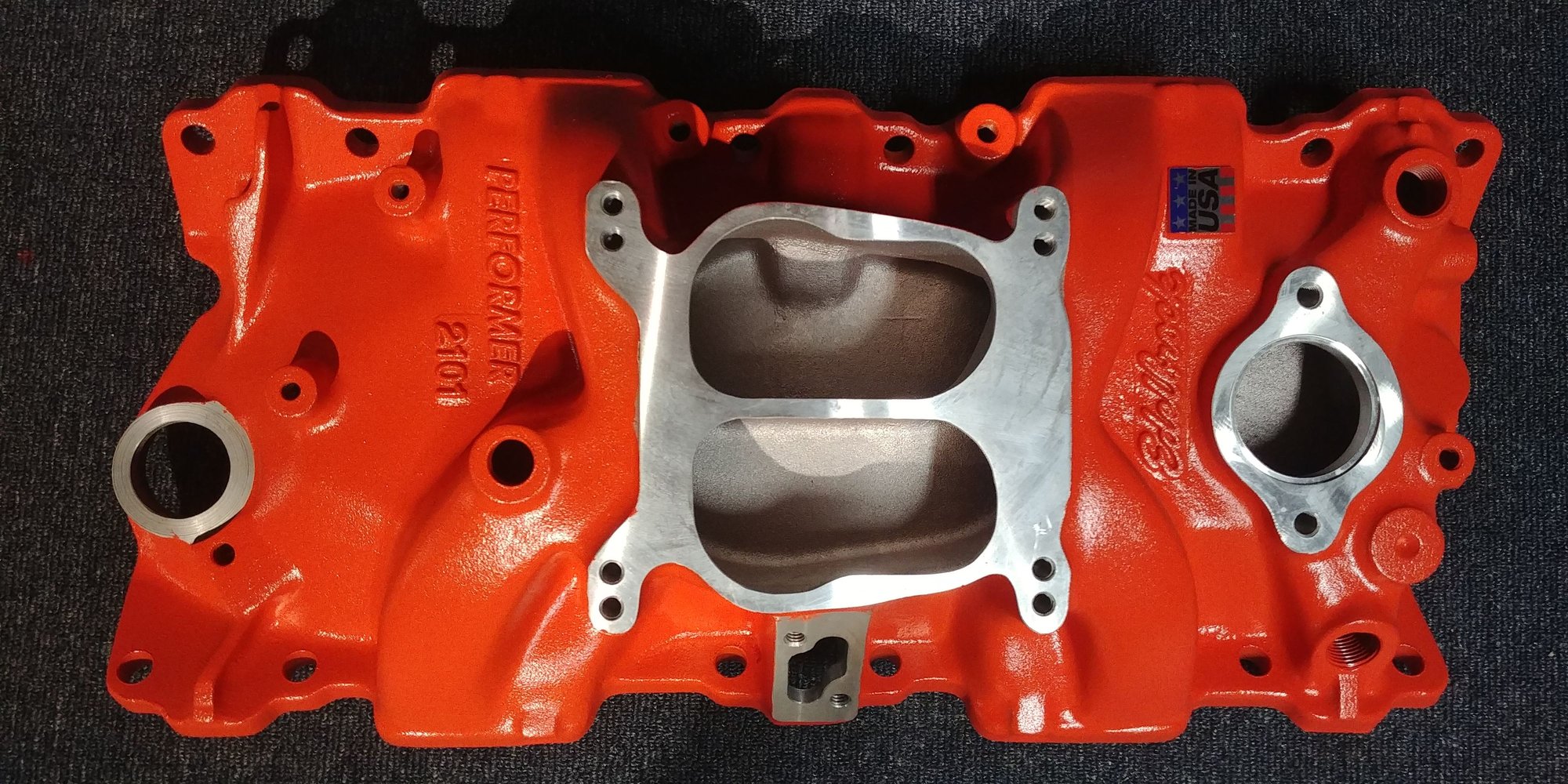

I purchased this Edelbrock 2101 intake manifold to use on my 1974 engine and then decided to wait on restoring that engine.
It is powder coated orange and has a square bore/spread bore feature. It also has the bosses needed to mount the external coil bracket.
Summit racing says it will fit my application and it will fit my current air cleaner setup.
What do you folks think?

Install the 2101

And forget about the EGR then I am guessing. It has the choke spring mounting area for the quadrajet choke. My picture shows it covered but it is there.

Bolt that 2101 Performer on.......that would be ideal. The L-82 intake is a woeful low rise piece with crummy runners......just about any aftermarket intake works better.
Block the heat riser off with a 1204 Fel-Pro intake gasket. Run the thick 1/4" Q-Jet spacer gasket from Quadrajet parts.
I am pretty sure that the EGR Performer IS the ZZ4 intake.....I am almost positive it is cast by Edelbrock.......look at the similarity between the two you have....also look at the night and day difference between the L-82 intake and the Performer.......
The 350/350 cam is so close to the facotry L-82 cam that I doubt anyone would be able to tell the difference....the 350/350 cam being a touch larger.
Curve that TI distributor and set total timing for 36 degrees and Vacuum can per Lars papers......and then finish it off with a set of quality long tube headers. Do these things and that engine will surprise the hell out of you.
Jebby

Thank you Jebby. My 1903 carb has a hot air choke so I went to Summit Racing and ordered the hot air to electric choke coversion kit and will be installing it on the 1903 carburetor. I also ordered the Fel-Pro 1204 intake gasket. Those will get here in a few days.
I do see what you mean about the ZZ4 and performer 2101, almost identical. I will stick with the 2101 then. I'll convert to electric choke; eliminate the EGR, move forward with the car. Thank you sir.
